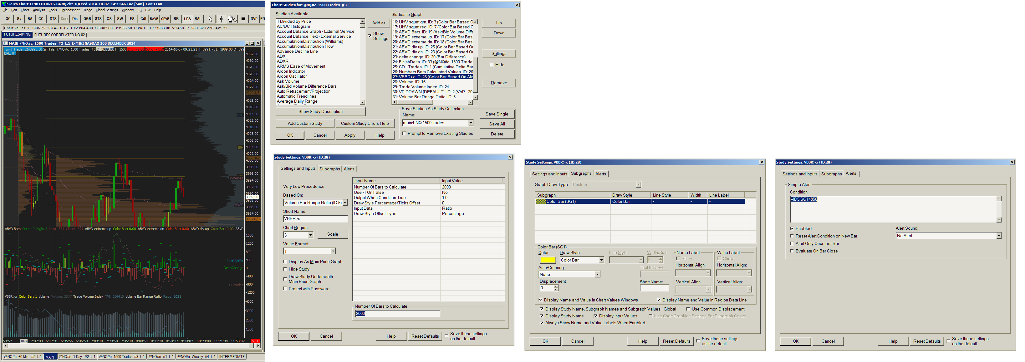

VBBR (ID:5) bars should be colored yellow when >850.
trigger works but bars do not color, regardless of the relative position of the Color Bar Alert study in the Study list.
please advise thanks.

[2014-10-09 10:14:52]
If you want to color the Subgraph of another study follow the instructions here:
http://www.sierrachart.com/index.php?page=doc/doc_TechnicalStudiesReference.html#s245
Specifically the section named "Coloring Subgraphs of Other Studies".

thank you. i got it working. a follow up question, from the link in your reply:
>>Set the Draw Style of the Color Bar Subgraph to be the same as the Subgraph of the other study you are coloring. In the case where you are coloring a study Line, it is recommended to use the Line-Skip Zeros Draw Style. Otherwise, the appearance of the line will not be correct.<<
what if the other study is Graph Draw Type=Candlestick, where the only Draw Style options are [Visible, Ignore] e.g. Value Charts study.
thanks again.
[2014-10-10 07:20:40]
In this case use Color Bar and we will update the documentation to explain this.
