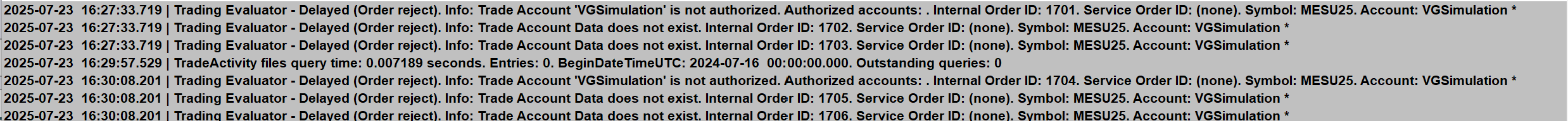

Dear Sierra Chart team,
I just signed up for a trial and I'm working to config the platform. I seem to be having trouble placing orders - all orders are rejected with error messages (refer to attached screenshots).
I followed the initial account config with the volowing video from the Sierra chart repository: https://www.sierrachart.com/index.php?page=doc/VideoLibrary.php&Video=SierraChart_Simulated_Futures_Trading_Service
I'd be grateful for your support and guidance - Sierra chart is a beast of a program, and I've exhausted my efforts to resolve the issue on my own.

[2025-07-23 17:09:44]
Sierra_Chart Engineering - Posts: 25432
What Trade Account do you see in Trade >> Trade Account Monitor when connected to the Trading Evaluator-Delayed service?
Also the easiest thing to do is to use Trade Simulation Mode:
Trade Simulation
Date Time Of Last Edit: 2025-07-23 17:10:14

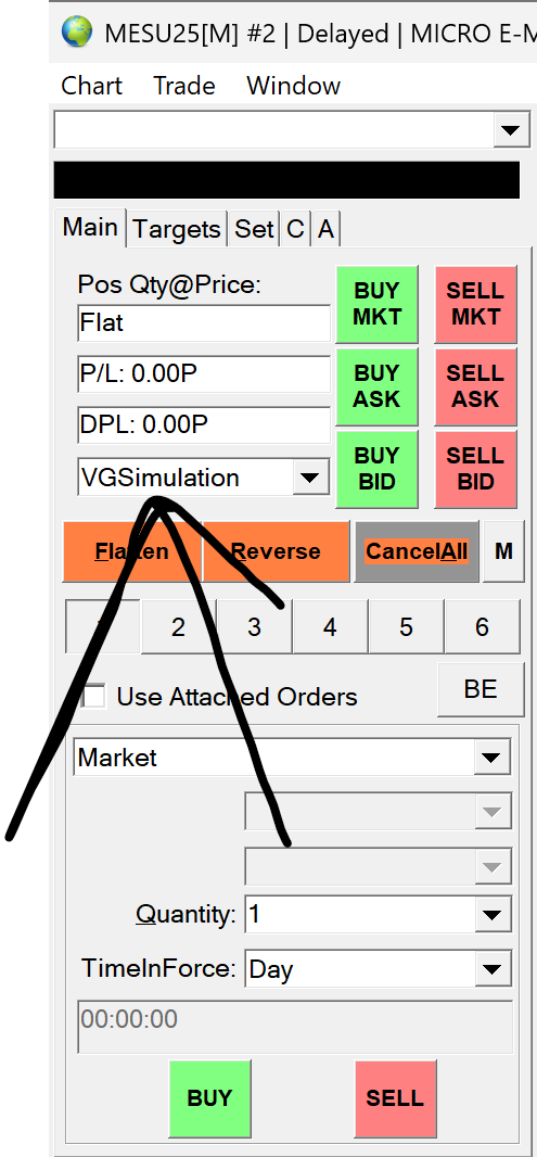

[2025-07-23 17:26:36]
User585816 - Posts: 7
I created my own - VGSimulation (funded 20k)

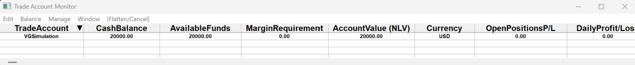

imageTtade Account Monitor_VGSimulation.png / V - Attached On 2025-07-23 17:55:37 UTC - Size: 26.4 KB - 264 views
[2025-07-23 22:35:32]
That trade account does not exist on Trading Evaluator-Delayed.

You cannot use this service:
2025-07-24 03:08:44.458 | Current selected Data/Trading service: Trading Evaluator
It needs to be:
Trading Evaluator - Delayed.
Since you do not have access to real-time data.
However, we very strongly at this point recommend using the following feature:
Trade Simulation
With the issues that you are having, please do not use the Trading Evaluator services. There are no reason for issues, but apparently you are misunderstanding those services.
