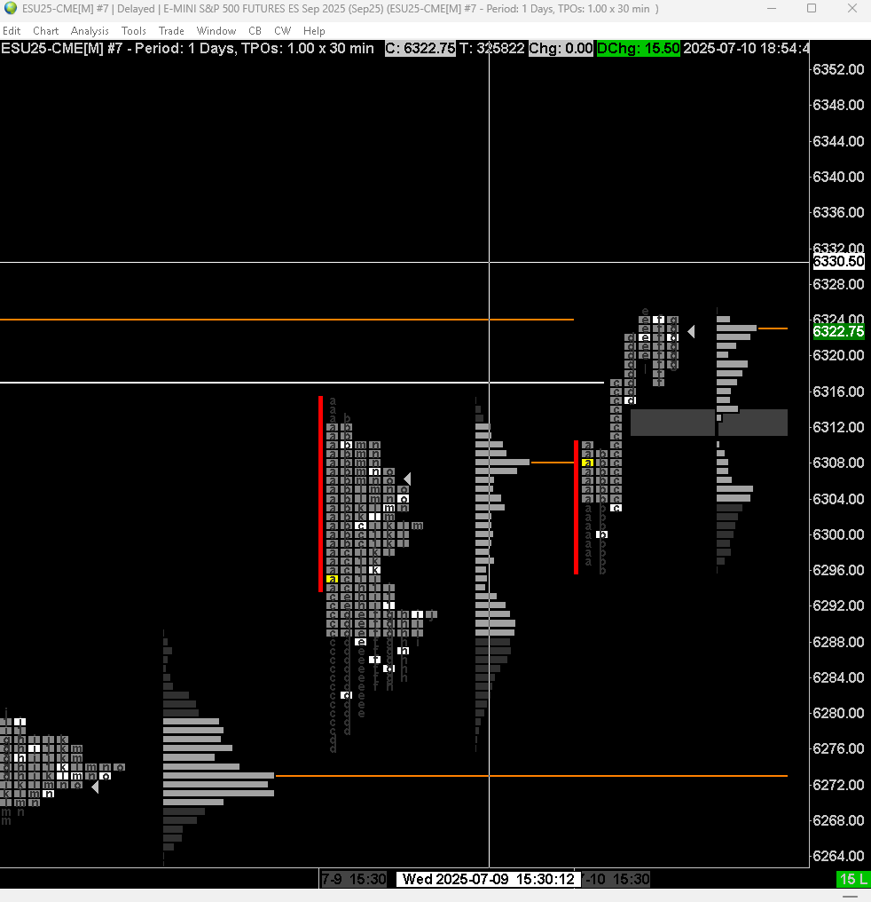

I have "Hand" active and also "Chart Values / Crosshair".
So, when I press the left click and move the mouse, I can scroll the screen up, down, diagonally, etc., meaning in all directions.
What problem do I have?
When I move the mouse out of the chart and go to another area of the monitor, the crosshair stays FIXED IN THE LAST AREA IT WAS IN on the chart, and I want it to disappear!
Also, I would like the thickness of the Crosshair to be thinner. Is this possible? Thank you.
imageCroshairsierra.png / V - Attached On 2025-07-10 19:20:19 UTC - Size: 47 KB - 243 views
[2025-07-10 19:24:14]
Refer to the following setting:
Chart Drawing Tools: Hide Chart Values Tool when Pointer not Over Chart (Tool Settings >> Chart Values >> Chart Values)
This is controlled by the following setting:
Graphics Settings: Chart Values: Crosshair
Most likely it is already set to 1, which is 1 pixel and is therefore as small as it can be.
