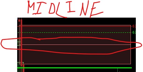

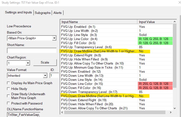

Also, FWIW if it helps. I have a custom Fair Value Gap Study that has lost its control to turn a midpoint line off & on. If you turn it off in the inputs the midline disappears then pops back on immediately. Pics attached.

[2025-07-09 19:18:39]
Is that not fixed with the update to 2773?
[2025-07-09 19:19:44]
TriStar Trading - Posts: 201
Oh, I have not updated. Sorry to confuse. I will update.
[2025-07-09 19:22:35]
Fixed! You guys are awesome!! Thanks!
