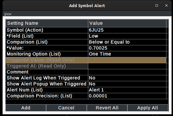

I am setting several alerts. Most of them seem to work as expected but one in particular keeps triggering immediately.
It's the 6JU25, I'm setting an alert for when the Low is Below or Equal to 0.70025
Comparison Precision is 0.00001 (the default)
I'm on an hourly chart and it's still quite far away but the alert is triggered immediately after creation.

juicebro - Posts: 119
These settings trigger immediately
ok I see why now. I'm using a Symbol Alert and that uses the Current Quote data.
Alerts Manager: Add Symbol Alert
I wonder what is the best way to set an alert using intraday data for triggers.

[2025-07-01 19:08:40]
John - SC Support - Posts: 48658
You are correct, the data for the Symbol Alert is coming from the Current Quote data, so the "Low" is going to be a fixed value, for the most part. In this case, it must have been below your value.
Using the Last will work, if that is what you want.
You have found the only options for creating alerts - Symbol Alert, Drawing Alert, or the Simple Alerts.
