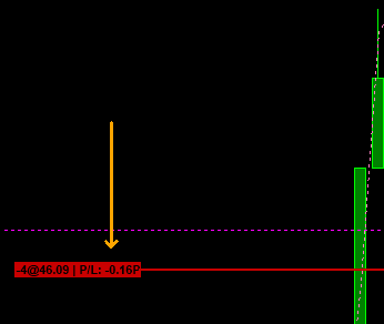

Can you please direct me to info on how to change the text of these order and status bars on a chart (see attached)
Thx
imageScreenshot 2025-06-27 at 10.59.32 AM.png / V - Attached On 2025-06-27 16:02:53 UTC - Size: 7.74 KB - 261 views
[2025-06-27 16:18:23]
John - SC Support - Posts: 48658
For a Position line, refer to the following:
Global Trade Settings Windows: Chart Position Line (Global Settings >> Chart Trade Settings >> General)
For working orders, refer to the following:
Global Trade Settings Windows: Working Orders - Display (Global Settings >> Chart Trade Settings >> Working Orders)

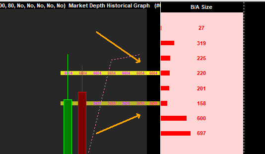

[2025-06-28 17:02:06]
cmack1011 - Posts: 201
Can you explain why I am seeing two different numbers here? The bar numbers represent "ASK Size" and is part of the "DOM Columns". I am assuming that this number, and its associated bar, represents all the limit ask volume (resting orders) at this price level. The yellow bar and pink numbers are from the study "Market Depth Historical Graph" and I assume represents all the limit ask volume (resting orders) at this price level that are active at the time indicated by the x-axis. Thus, shouldn't these two numbers be equal, assuming that the resting orders represented by the "Market Depth Historical Graph" study are currently active (have not been pulled)? Instead the "Market Depth Historical Graph" is showing "6604" and the "Ask Size" is showing only "220"? Likewise, the second yellow bar shows "3699" but the "Ask Size" is "158".
Thx
imageScreenshot 2025-06-28 at 11.51.17 AM.png / V - Attached On 2025-06-28 16:59:10 UTC - Size: 15.42 KB - 271 views
[2025-06-28 21:34:47]
We cannot answer this question without getting that particular chart.
