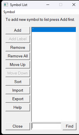

Possible bug found.
Due to an interaction between Sierra sending a request for an invalid ticker, and Rithmic, Sierra goes into a loop of trying to download data, failing, and freezing the screen non-stop in a self imposed denial of service loop.
Denali seems immune to this issue.
It's a bug I accidentally triggered when trying to hit a hot key I use (the backtick character, top left of a standard keyboard), and Sierra took the character to be a ticker for Intraday data download. (I've noticed this " `.scid " file in the data directory for months that I would delete, but it would just come back. I thought it might be some internal file, and didn't look very hard to find where it came from). I always use Denali data (until this week), so I never noticed any issues.
Sierra is not usable while the messages at the bottom of the screen alternate every 2 seconds between the 3 messages: "Historical Intraday Data Download Complete", "Downloading Historical Intraday Data", and "Waiting to Download Historical Intraday Data".
Specifically, if one of the ticker symbols scheduled for Intraday data download is a backtick (literally the backtick character " ` " ), Rithmic goes into this doom-loop.
I removed the symbol from Sierra, and the Intraday data downloaded using Rithmic right away.
I was able to repeat this with 3 different Rithmic data providers (Take Profit Trader, Thrive Trading, and Funded Futures Network).
Please see attached screenshots and log. Video also available.

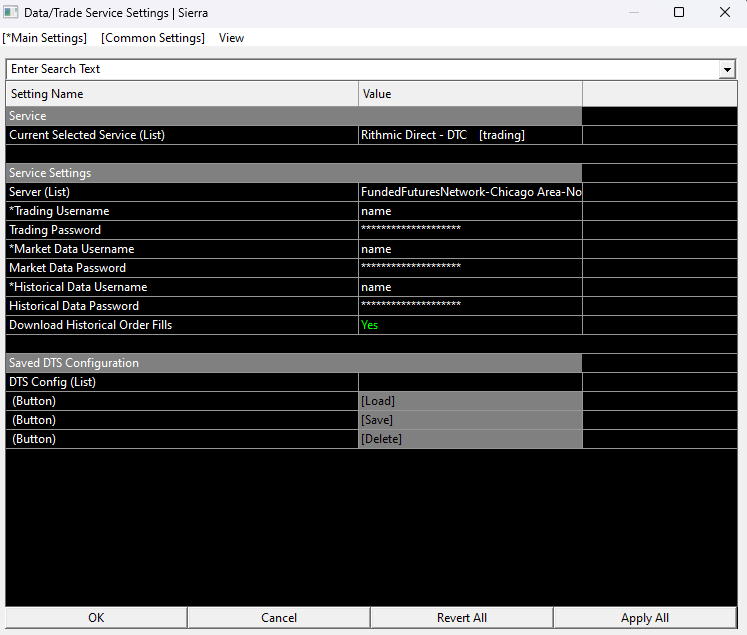

Added another image of the data config.
imageScreenshot from 2025-06-13 14-14-03.png / V - Attached On 2025-06-14 02:00:06 UTC - Size: 23.86 KB - 244 views
