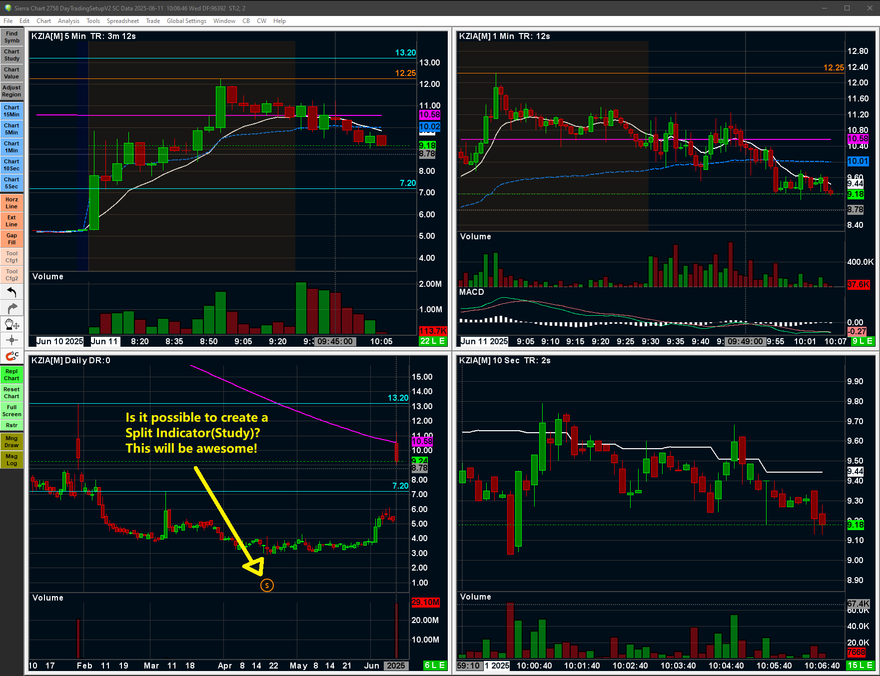

i would like to know if it is possible to create an indicator/Study to see recent Reverse split on daily chart?
If yes where can i start to make my dream come true :)
Here a picture Of what i'm talking about!
Date Time Of Last Edit: 2025-06-11 14:24:31
imageDailyChart Split Indicator.png / V - Attached On 2025-06-11 14:24:29 UTC - Size: 164.18 KB - 278 views
[2025-06-11 15:11:33]
John - SC Support - Posts: 48659
To begin with, you can always place a marker or use the Stationary Text option to mark a chart where the split occurred.
The same is true with a custom study, you would use the drawing tool to mark where you want.
In the end, the hard part is defining where you want the marker and how do you get that into your study. If you have some source of information that you can parse and read into your study, then that would be what you want. But if you are going to be entering it manually, then it would be just as easy to use the drawing tool manually to do this.

AlexH4 - Posts: 28
Yes i See this is a simple way but for my strategy not really because i trade a different stock every day... knowing that the company did a recent reverse split is a + for my criteria stock selection.
in this case would be too much complicate to tag every smallcap stock recent reverse split...
sierra chart can be a user friendly platform if you take the time to setup it the way you like...
Do you think with ACSIL is possible to do it?
i will say that having a option to see split on Chart would be really awesome!
Yes, it is possible, and that is what we were pointing out. The hardest part is getting the information for the splits, as we do not have that ourselves. So you have to have a way to get that information into the system in order to mark the charts as you would want them.
