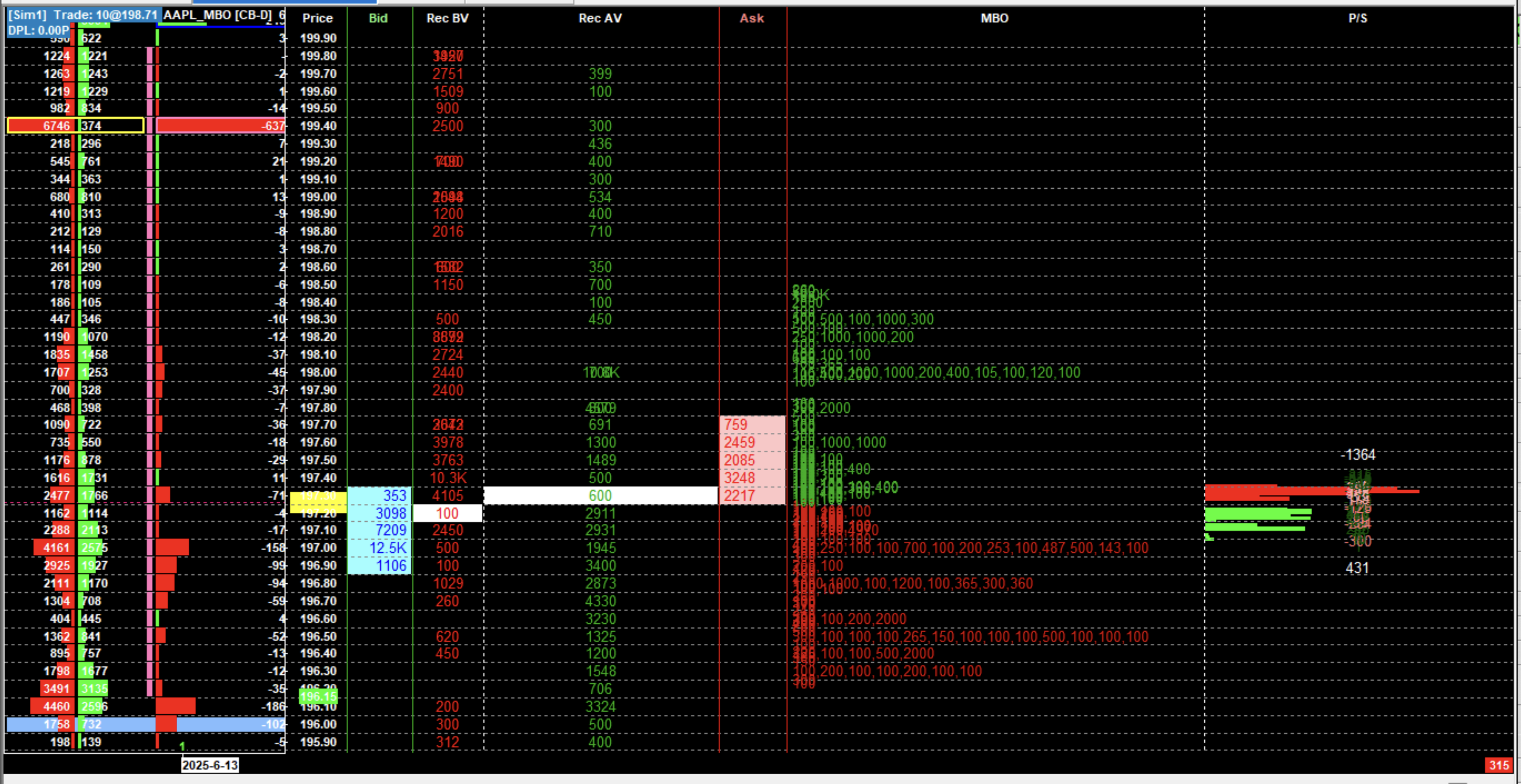

Is this the type of image you are requesting? You can see that the MBO data is stacking. Also, some "Recent ASK Volume" is also still stacking despite making recent adjustments.
imageScreenshot 2025-06-13 at 11.48.11 AM.png / V - Attached On 2025-06-13 16:54:19 UTC - Size: 1.4 MB - 414 views

John - SC Support - Posts: 48659
We wonder if this may be due to copying the AAPL symbol rather than the ????_MBO symbol. We would like to remove the symbol you created and create a new one from ????_MBO. Please follow these instructions for this:

[2025-06-16 19:54:02]
cmack1011 - Posts: 201
Unfortunately, the issue persists. Please see attached.
However, when I change the "Chart Data - Volume at Price multiplier...." and "Market Depth - Market depth combine increments in ticks" from "4" to "1" the stacking of the numbers resolves, but you can see that it is not filtering the lots less than "500" as set in the symbol settings. (see attached pic)
