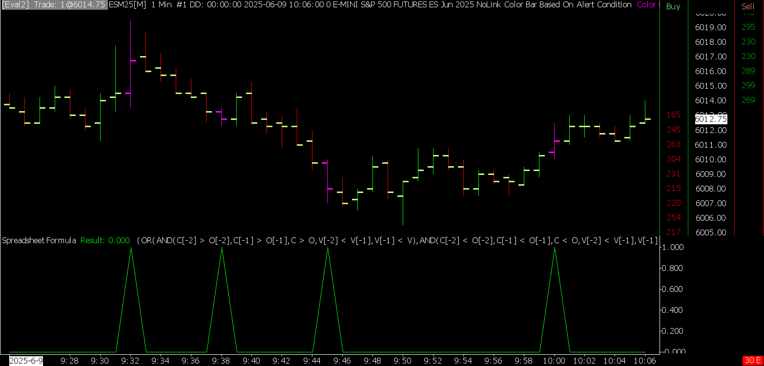

That Alert Condition works fine for us and we are getting proper signals from it.
Attached is an image of what we get with it when we use both the "Spreadsheet Formula" and the "Color Bar Based on Alert Condition". The Color Bar Based on Alert Condition, in particular, was a copy/paste of exactly what you put in your posting.
imageESM25[M] 1 Min #1 2025-06-09 10_11_19.116.png / V - Attached On 2025-06-09 15:12:37 UTC - Size: 44.57 KB - 311 views
[2025-06-10 17:10:59]
The top, where the bars are colored is from the "Color Bar Based on Alert Condition". Where you enter the condition on the "Alert" tab. Refer to the following:
The bottom is from the "Spreadsheet Formula" study. In this case, you need to reformat your condition to be on a single line. Refer to the following:
Spreadsheet Formula
