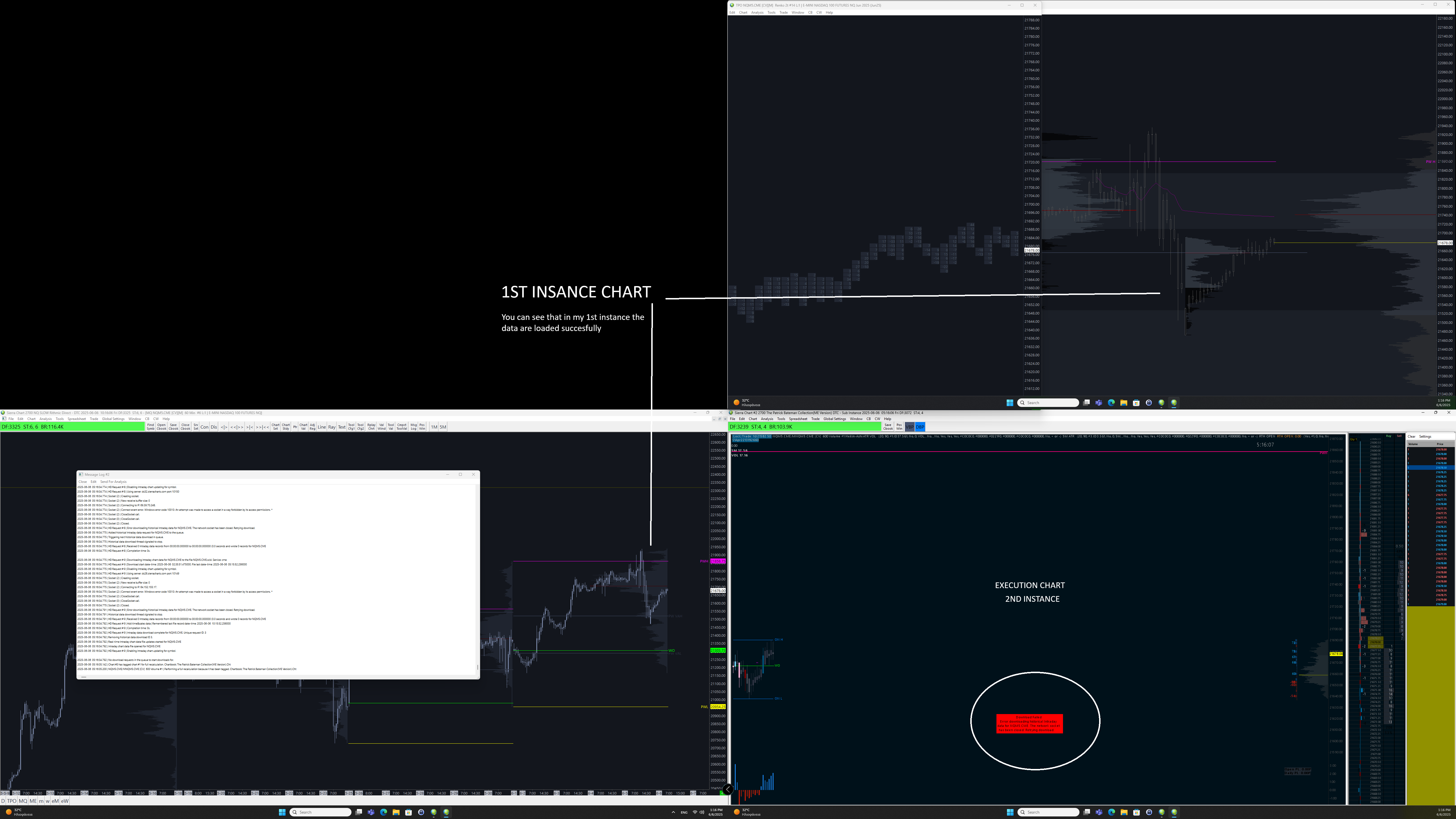

My apologies if i didnt make my self clear
Sierra 1st instance: Bulk of my charts are loading successfully both historical and intraday data.
Sierra 2nd instance: Last 2 days is failing to load intraday data. I only have live data when sierra is open.
I have attached a picture
Date Time Of Last Edit: 2025-06-06 12:12:20
image1.png / V - Attached On 2025-06-06 10:23:23 UTC - Size: 691.26 KB - 340 views

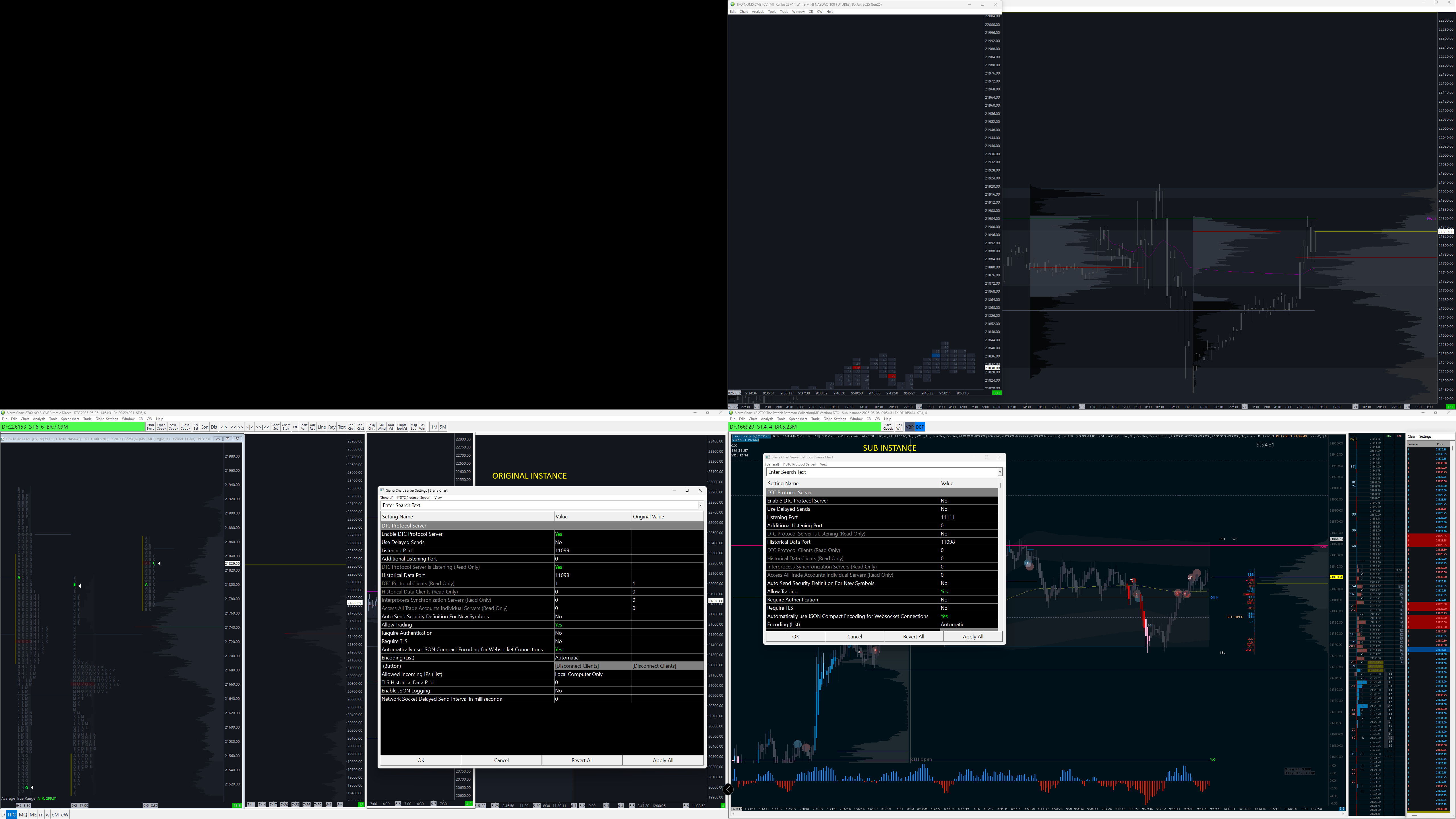

I have attached a pic of my sierra chart server setting to check if anything is wrong
image1.png / V - Attached On 2025-06-06 15:01:10 UTC - Size: 786.56 KB - 315 views
[2025-06-06 15:38:21]
In the Sub-Instance, it is not the "Sierra Chart Server Settings" that you need to check. It is the "Data/Trade Service Settings". Please check the correct location and see what the ports are set to on that window.

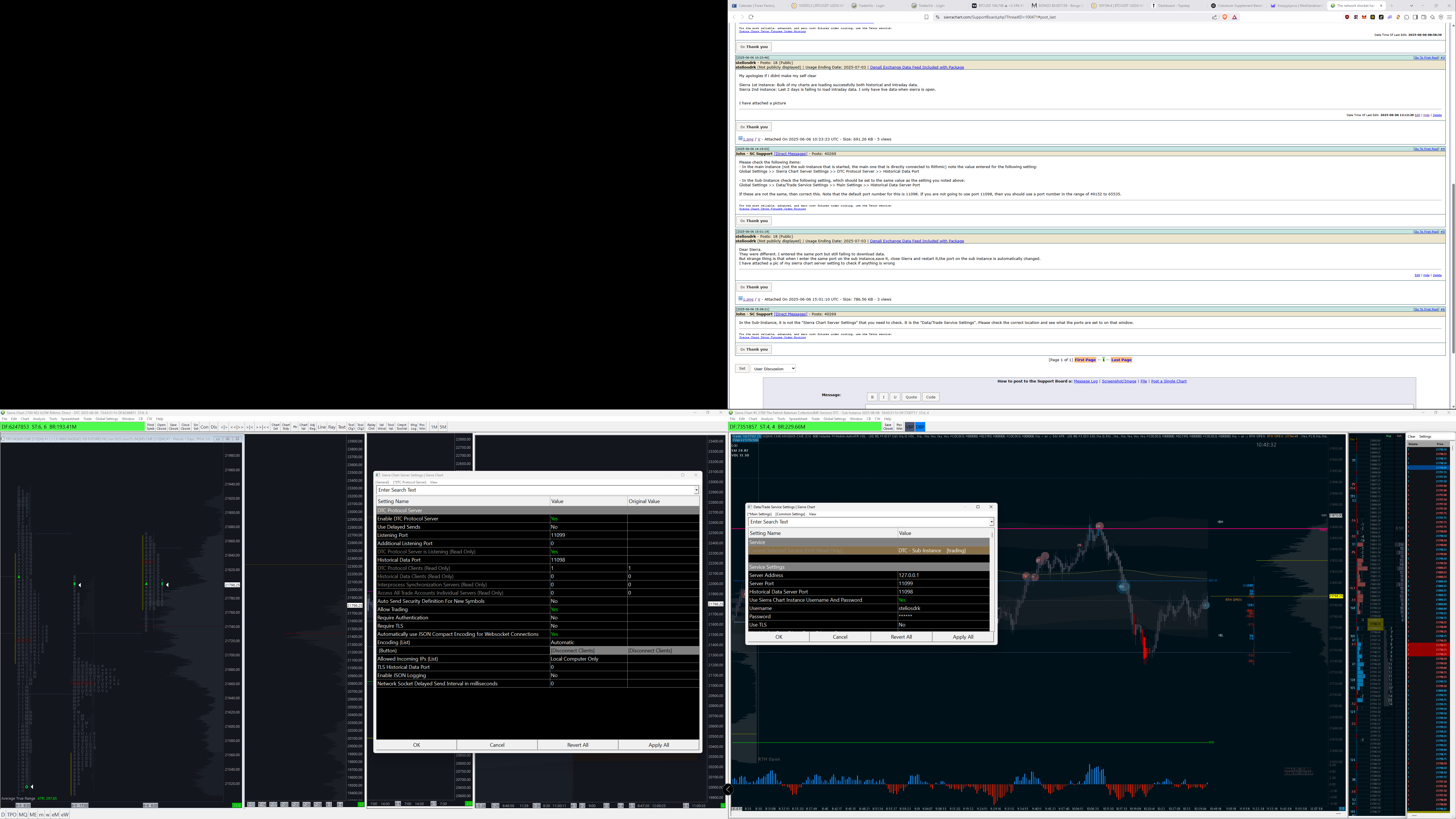

steliosdrk - Posts: 22
My apologies for my mistake.
Yes they are the same.
Photo attached
image1.png / V - Attached On 2025-06-06 15:45:11 UTC - Size: 802.09 KB - 313 views
[2025-06-06 15:51:09]
In this case, we need you to reboot your computer, as we wonder if that port is in use by another program.
