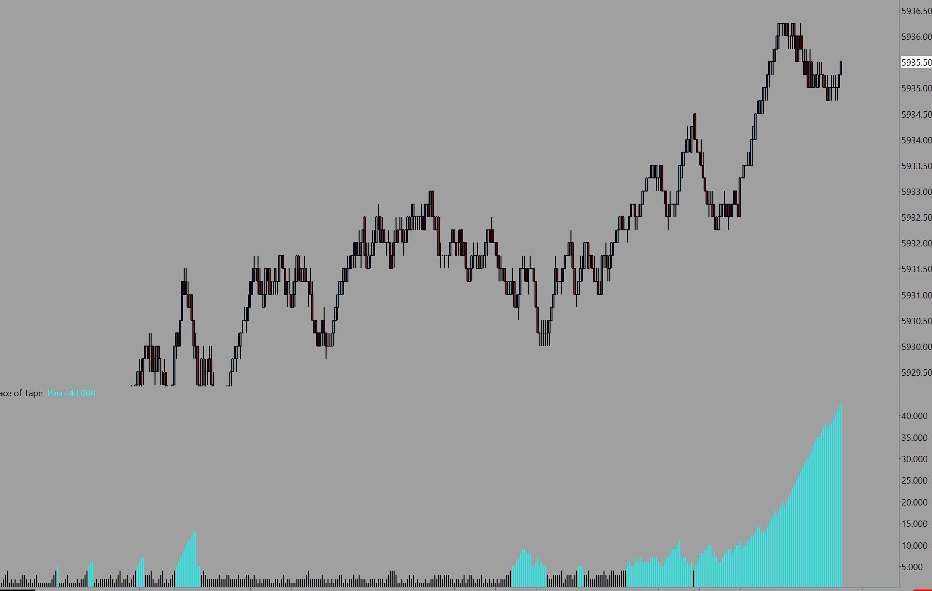

cmet - Posts: 747
Not completely sure, but sounds like you're talking about the old Pace of Tape indicator. Let's you set a time period (in seconds) and threshold (# of bars) then highlights when the plot exceeds the threshold.
Here's an ACSIL version if you want to check it out.
Image is of today's close on a 100 tick chart using 1 second, 5 bars.
attachmentPaceofTape.cpp - Attached On 2025-05-28 01:15:00 UTC - Size: 2.17 KB - 368 views
imagePoT.jpg / V - Attached On 2025-05-28 01:15:13 UTC - Size: 140.24 KB - 410 views
