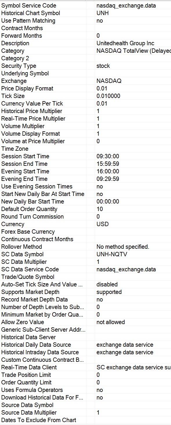

[2025-05-19 15:17:46]
$tack - Posts: 123
I took the entry that was under UNH-NQTV and duplicated it then renamed it and modified for UNH_MBO.
attached is the original UNH-NQTV i duplicated. The only change I made was to change SC Data Symbol to UNH_MBO
Date Time Of Last Edit: 2025-05-19 15:18:50
imageunh_nqtv_symbol_settings.jpg / V - Attached On 2025-05-19 15:17:10 UTC - Size: 352.21 KB - 299 views
[2025-05-19 16:00:53]
What you did will not work. The service settings for a -NQTV symbol will not work for an _MBO symbol. Delete that UNH_MBO symbol from your symbols settings.
Use the "?_MBO" symbol as the base and duplicate that and change the symbol to UNH_MBO. You should be fine from there.
