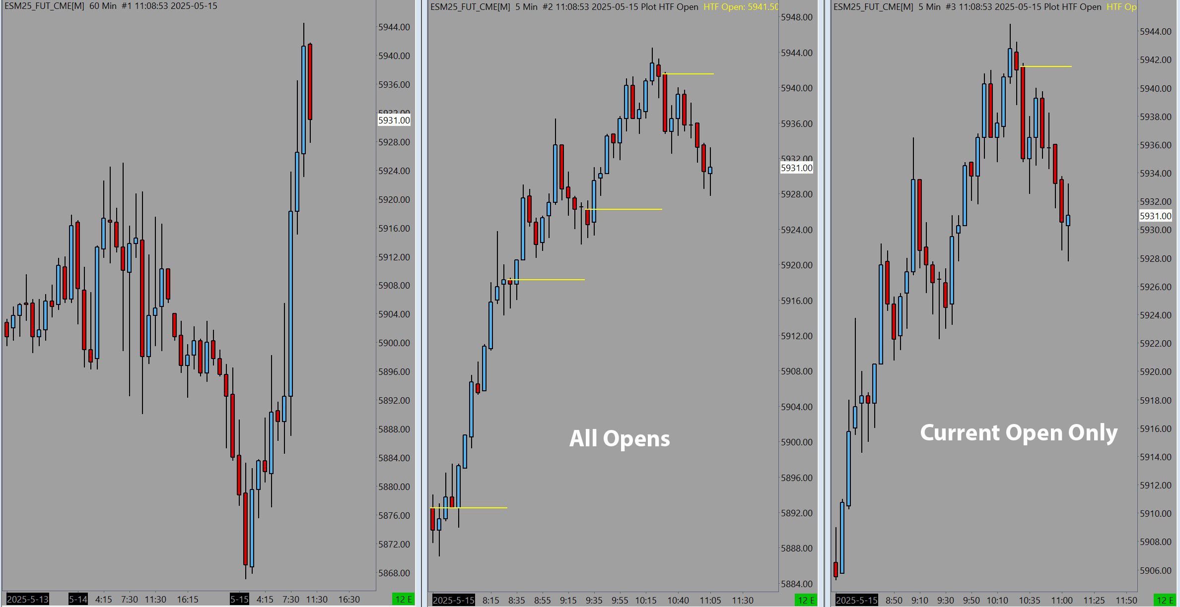

Here's a study that does what you want. You have to have the 60 minute (or any higher time frame) chart open. Has the option to use open from all bars or just the current one.

Date Time Of Last Edit: 2025-05-15 18:10:44
imagePlot Open ES.jpg / V - Attached On 2025-05-15 18:10:43 UTC - Size: 266.36 KB - 329 views
