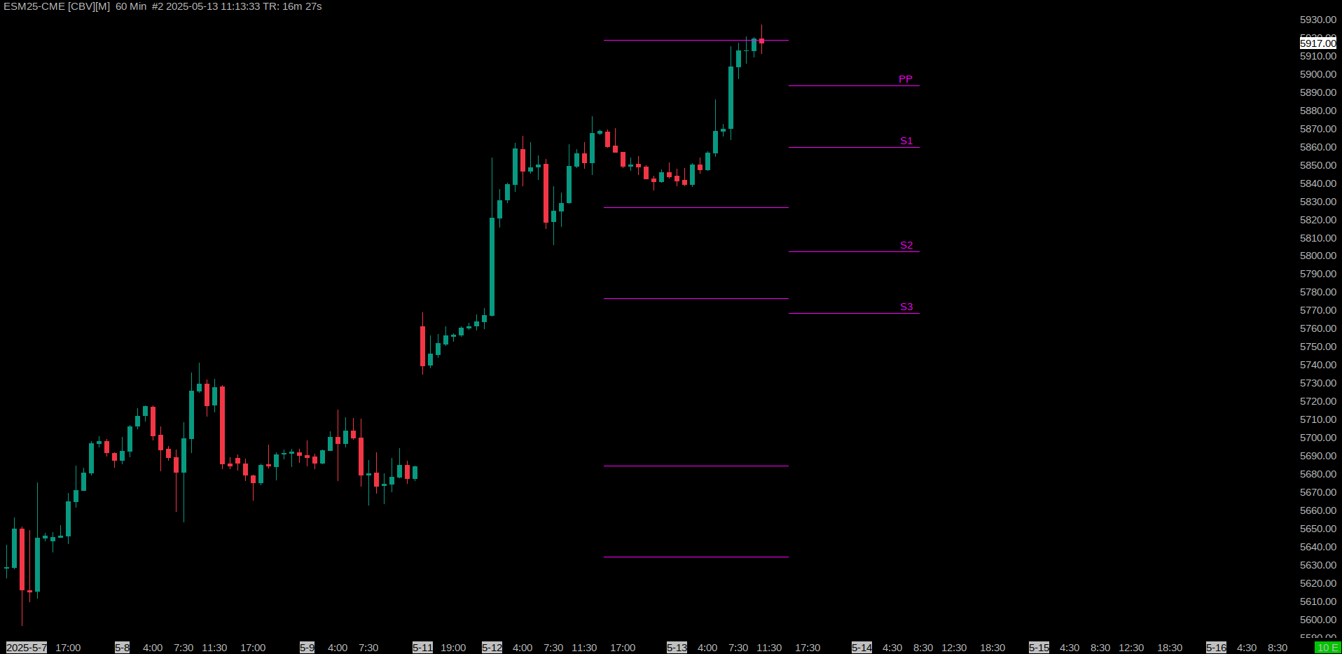

The forward projected lines are extensions of the existing lines on the chart from the last bar. So they are NOT the next day's pivot points - they are just extensions of the current day's pivot points.
This is not the behavior I am seeing.
https://www.sierrachart.com/image.php?Image=1747160624693.png
They are not only extensions but recalculations to project the next day's pivot points.
I have calculated the next day's pivots manually to verify their accuracy, and they are accurate.

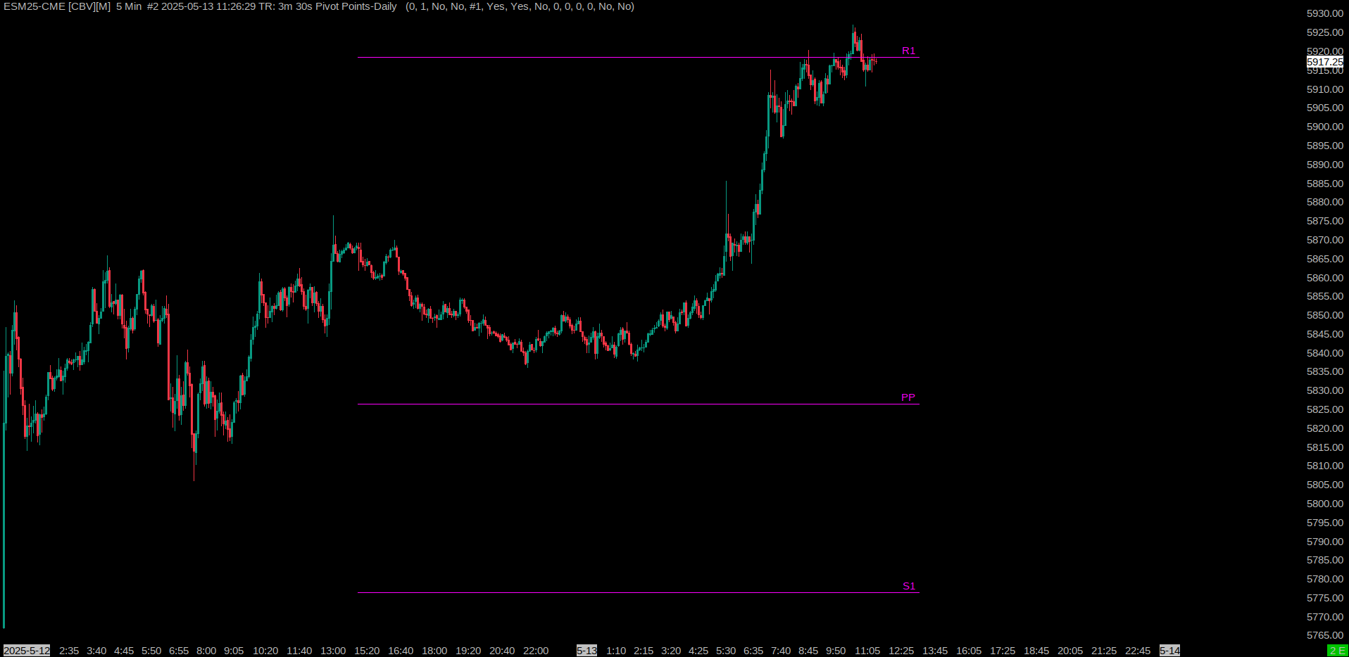

However, on a 5min chart the next day's pivots do not appear.

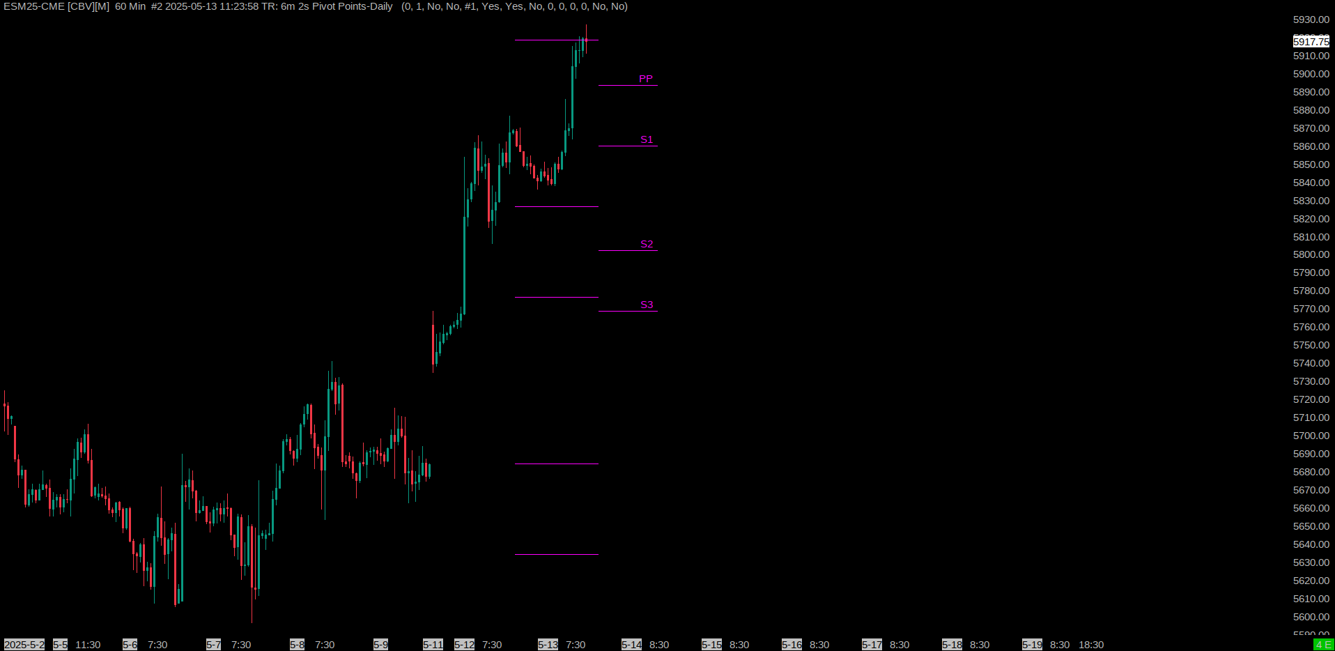

juicebro - Posts: 119
I have included the Study Name and Input Values to the chart header for more context in these screenshots.
(60 min, shows next day's pivots)
https://www.sierrachart.com/image.php?Image=1747161249440.png
(5 min, does not show next day's pivots)
https://www.sierrachart.com/image.php?Image=1747161400588.png
I see it is documented at the end of the page.
Pivot Points: Forward Projecting Pivot Point Lines
According to the above, the study might plot the next day's pivot points if the next session occurs within 10 bars after the chart's last bar.
This is clear to me now, maybe some info and a link for reference could be added to Pivot Points: Forward Project Pivot Point Lines as this behavior seems to have had confused us both.

It is definitely something that does not come up often, as it certainly was not "top of mind".
In addition to what is stated in that documentation, the reason why you see this is that you are referencing a Daily chart, so the last bar is being found and those extended pivots are based on that current bar. Keep in mind that the data is not fully accurate until the day actually closes, since the Pivot Points for the calculation you are using depends on the close of the bar.
