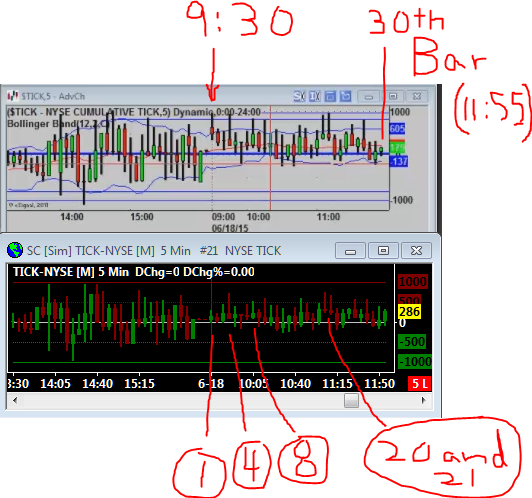

The attached pic shows the eSignal (DTN data) 5m Cumulative Tick on top and the SC NYSE 5m Tick on the bottom for June 18, 2015. This morning session was trend up from the open.
1. The eSignal Cumulative Tick shows a very strong open around 600 with a high approx. 1000 in the first bar. The SC Tick shows an open at about 0 and a high of approx. 300.
2. The 1st, 4th, 20th and 21st eSignal bars show emotional extremes close to 1000.
Rather than any more commentary I'd like to ask 3 questions...
Q1. Would it make sense to have the SC Tick open relative to it's constituent stocks close the previous trading day? ie: when the SC Tick opens and there are 600 more stocks on an uptick from the individual stocks previous close - the SC Tick opens at 600 rather than zero. This is a valuable piece of information.
Q2. Could the consistently lower extremes that the SC Tick plots have anything to do with having the SC Tick open at 0?
Q3. Is the SC Tick CUMULATIVE or a snap shot at the moment? And could this have anything to do with the consistently lower extremes with the SC Tick.
Thanks! You have created a fantastic product!!!
