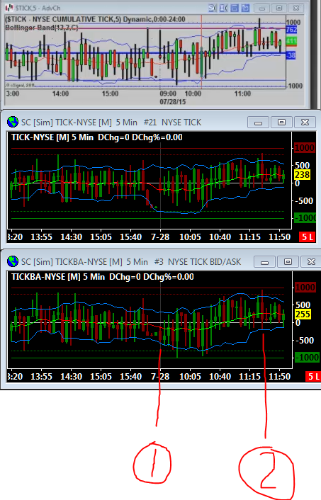

The attached PNG shows the eSignal Tick, SC TICK-NYSE and the SC TICKBA-NYSE for today's morning session.
The ES opened 7.25 points above yesterday's settlement. The eSignal Tick first 5m bar, opens below 0 and then has a high around 750, showing the strength of the NYSE stocks first trades.
The first SC TICK-NYSE 5m bar opens around 0, with a high around 90. The first SC TICKBA-NYSE 5m bar opens below 0 around -200, with a high around -100. Both SC ticks completely miss the strength of the higher open in stocks, especially the TICKBA.
As well, the SC consistently plots lower extremes. The bar labeled with the number 2 shows highs of approx. +1200 (eSig), +870 (TICK-NYSE) and +950 (TICKBA-NYSE).
Finally, the SC ticks seem to update more often than the eSignal tick which is good. Could this result in lower extremes? I don't know. Just pointing this out.
The biggest issue for me is how the SC ticks perform at the open and the first 10 to 15 minutes.
Thanks for reading this! I would love to use SC only but the way I like to trade the open makes this difficult with SC only.
imageNYSE TICK COMPARISON 2015 07 28.PNG / V - Attached On 2015-07-28 17:58:47 UTC - Size: 145.62 KB - 859 views

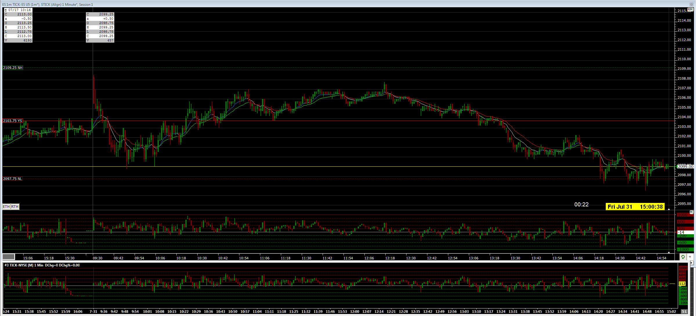

The attached PIC/PNG is for the TICK enthusiasts out there.
My take-away from this thread so far, is that the eSignal data NYSE TICK (under the ES in pic) and the SC NYSE-TICK (bottom) are VERY similar but, I also notice there are differences at the open, the zero line and the extremes.
Good trading to all!
imageTICK COMPARISON 1MIN 2015 07 31.PNG / V - Attached On 2015-07-31 19:40:56 UTC - Size: 119.5 KB - 680 views
