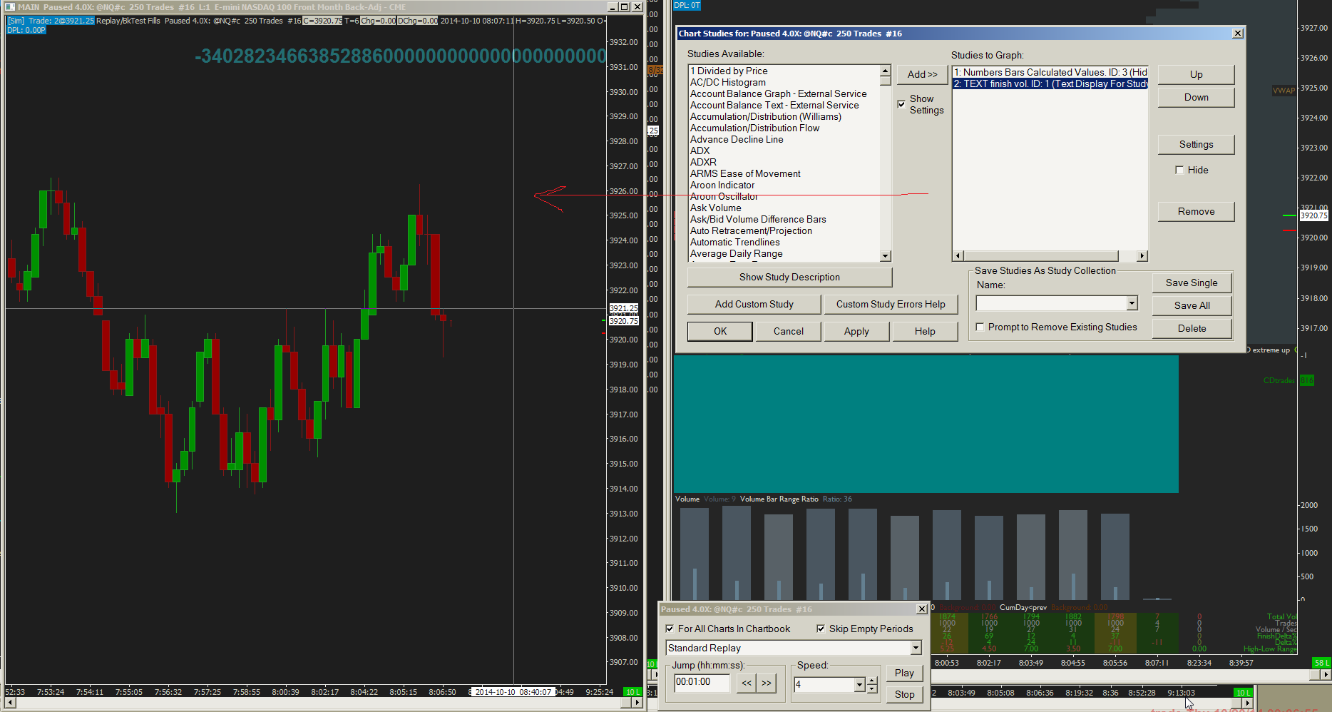

i understand. i have tried to troubleshoot and isolate the issue for more than an hour. i have not found it yet.
this is the simplest, most default chart setup i can provide (Numbers Bars has been reset to default settings): http://www.sierrachart.com/image.php?l=1414048120519.png
the TEXT study is relaying the Finish Volume parameter, and you can see in the attached screenshot that this value goes haywire at the very end (or very start?) of a bar (on every bar). this issue does not occur with other Numbers Bars values i have examined, just FinishAskBidVolDiff and Finish%
this wild value is not displayed in Numbers Bars output itself, just when called from another study.
thank you very much for your time.
imagesierra finishvol bug2.png / V - Attached On 2014-10-23 07:10:15 UTC - Size: 137.59 KB - 537 views
