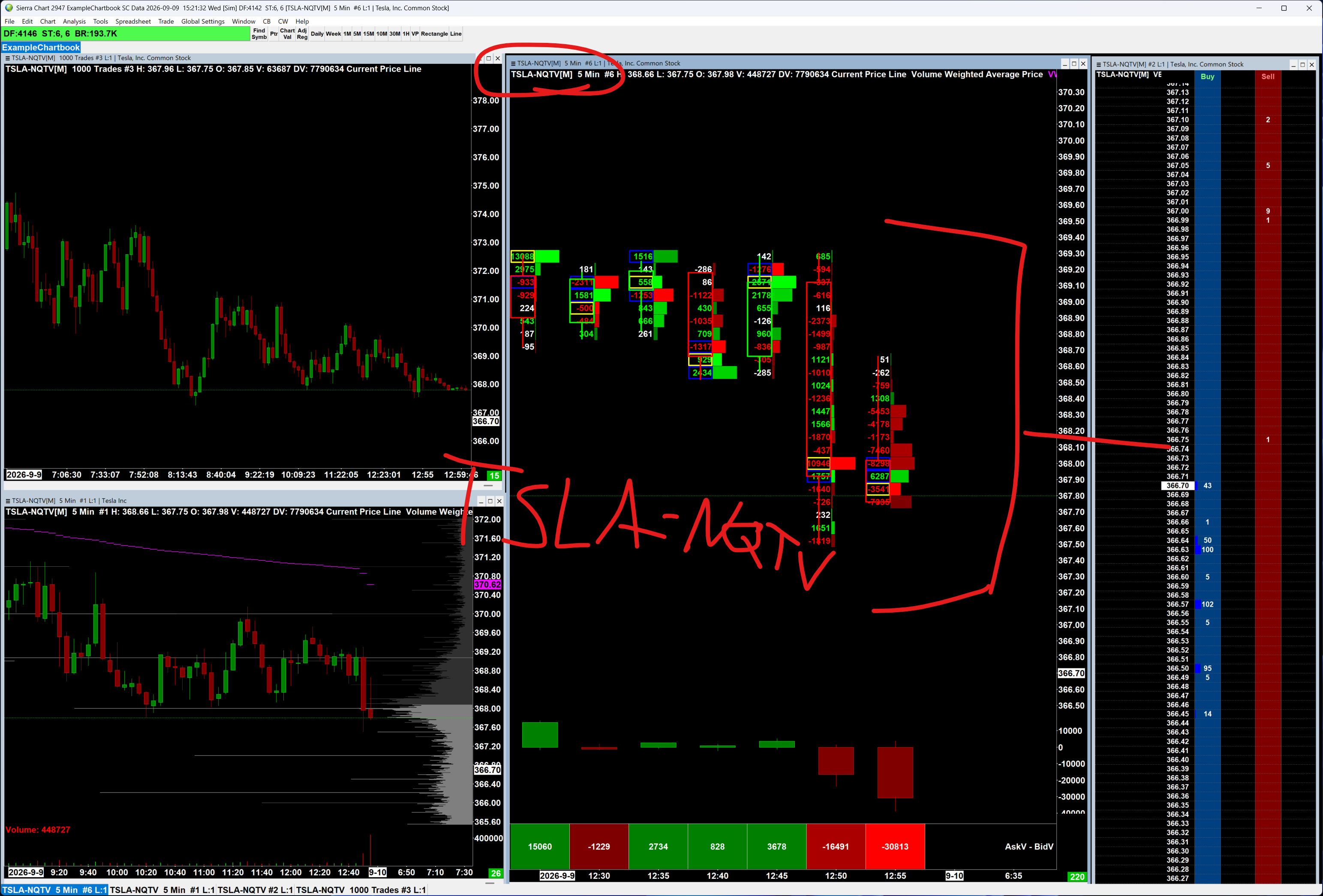

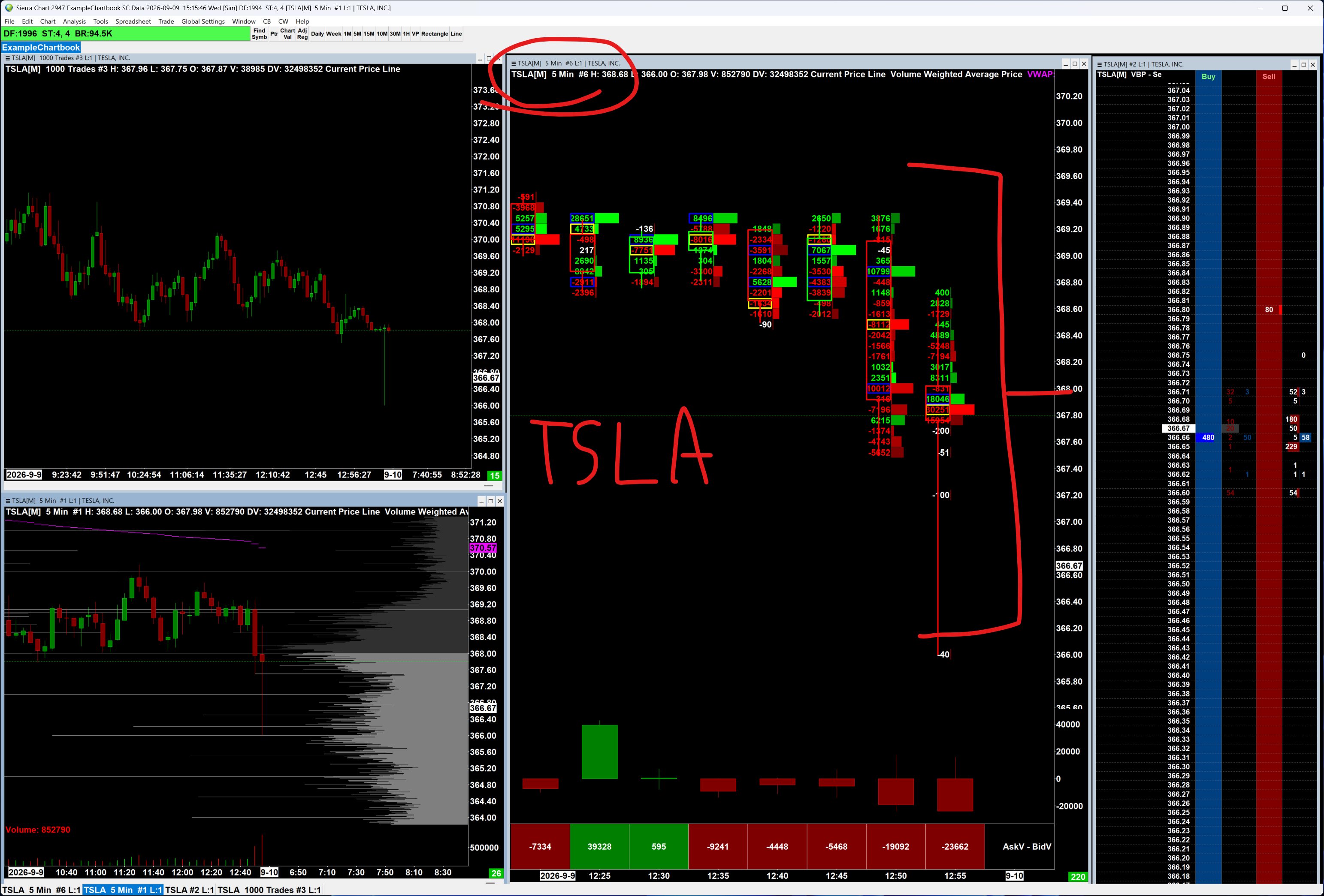

Thanks for that info John. That makes sense. I have just subscribed to the "U.S. Equities Consolidated Tape" as well. Now when I type in just the symbol such as "TSLA" it is no longer delayed and works.

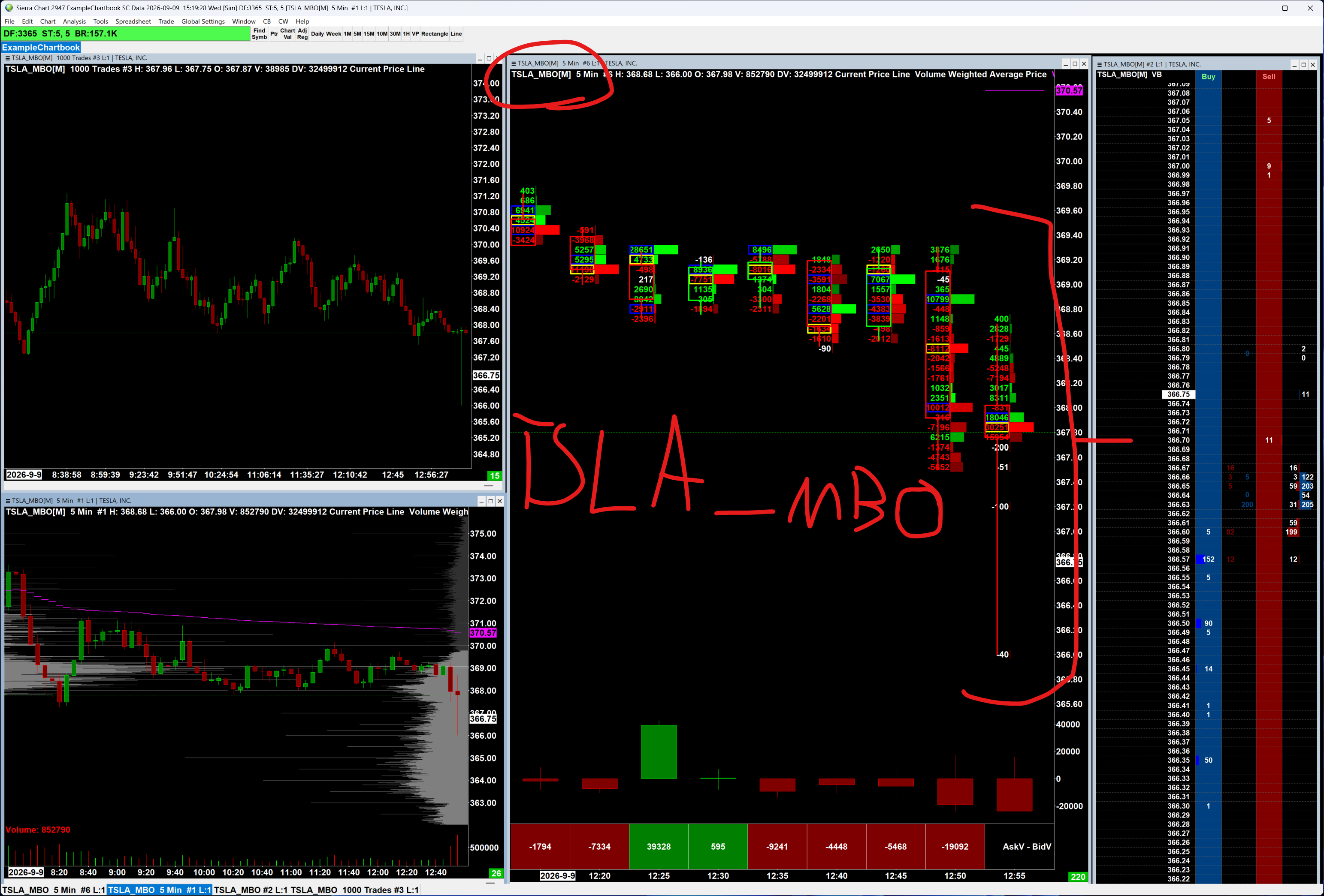

I have a question though. If you take a look at my screenshots below on the volume footprints, on the "TSLA-NQTV" (which is what I used to use) you can see for example on the second to last footprint, the delta values and for example the very last one of -1619. Now on the "TSLA" screenshot because I now have the "U.S. Equities Consolidated Tape" you can see I have more data and volume and on that second to last bar at the bottom it shows -5652. On the third screenshot "TSLA_MBO" the values on all the candles are exactly the same as the one with just "TSLA".
My question is: I thought that _MBO combined the NQTV and the US Equities consolidated tape data so I have the data from all the exchanges? So why would the TSLA and TSLA_MBO be the same if TSLA_MBO also includes the NQTV data? Which symbol should I use for the most accurate data on footprint charts?
Thanks for the help!
imageTSLA-NQTV.png / V - Attached On 2026-09-09 22:33:34 UTC - Size: 985.61 KB - 63 views
imageTSLA.png / V - Attached On 2026-09-09 22:33:47 UTC - Size: 970.02 KB - 64 views
imageTSLA_MBO.png / V - Attached On 2026-09-09 22:33:54 UTC - Size: 1019.77 KB - 57 views
