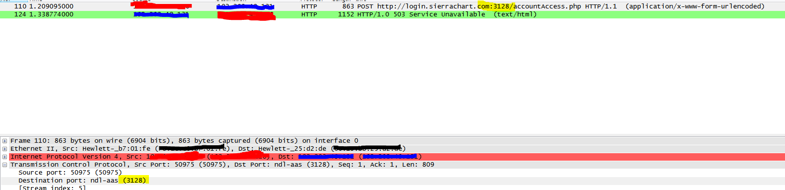

I've taken some steps to look further into this. I believe the issue is when I specify the port of the proxy server "3128" it appends a :3128 to the end of the login address (and probably all other SC addresses) instead of only using this port as the proxy port. This obviously doesn't work because sierrachart.com doesn't run on port 3128. No other websites in my capture append the :3128 at the end it just happens when trying to login via SC on version >962.
imagesc-proxy-error.PNG / V - Attached On 2013-05-20 18:12:29 UTC - Size: 34.83 KB - 1037 views
