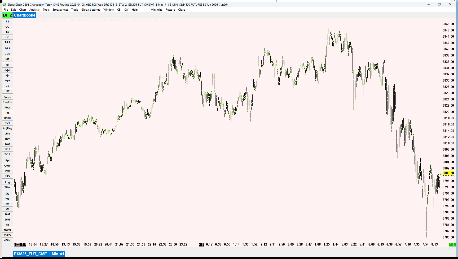

Here is what I am seeing on my side, with references from the current Message Log:
The symbol header shows the delayed‑feed mapping: ESM26_FUT_CME[M]
The “Data Delay” field does not appear in the chart header
The chart updates are delayed compared to real‑time
The Message Log does not show any real‑time authorization handshake
There is no line indicating a successful real‑time connection to the CME real‑time Denali feed
From the log (copied below):
Multiple entries show explicit delay measurements, for example:
“(8.0 hours. Delay: 2.7 seconds)” and
“(4.3 seconds. Delay: 2.4 seconds)”
These only appear when the feed is delayed.
The symbol is repeatedly mapped with the [M] suffix, for example:
“ESM26_FUT_CME[M]/MESM26_FUT_CME[M] 400 Trades #3 | Chart data loading complete.”
The real‑time authorization handshake is missing. The line
“Real-time Intraday chart data file updates started”
appears even when the feed is delayed and does not indicate entitlement.
If the DD field is missing and the [M] tag is present, the feed is delayed.
Please check the entitlement and session token on your backend.
If needed, I can initiate Remote Assistance so you can see the issue directly.
Attached is the fresh Message Log and a full‑window screenshot showing the [M] tag and missing DD field.
There is no line indicating a successful real‑time connection to the Denali server
Here is this morning's message log of a new chart initiated.

2026-04-08 08:18:21.419 | Teton CME Routing | Setting external service identifier for symbol MESM26_FUT_CME to 42005163
2026-04-08 08:18:21.419 | Teton CME Routing | Received security definition for symbol MESM26_FUT_CME
2026-04-08 08:18:21.433 | Trace | Basic security definition symbol settings fields ignored in primary service client. Symbol: ESM26_FUT_CME
2026-04-08 08:18:21.433 | Teton CME Routing | Setting external service identifier for symbol ESM26_FUT_CME to 42140864
2026-04-08 08:18:21.433 | Teton CME Routing | Received security definition for symbol ESM26_FUT_CME
2026-04-08 08:18:21.475 | HD Request # 1 | Receiving Intraday data for ESM26_FUT_CME starting at 2026-04-08 00:18:44.148000
2026-04-08 08:18:21.496 | Denali Data Feed | Network connection to server complete.
2026-04-08 08:18:21.496 | Denali Data Feed | Starting socket receive thread.
2026-04-08 08:18:21.496 | Denali Data Feed | Sending encoding request to server: Binary VLS. Compression: standard
2026-04-08 08:18:21.603 | Denali Data Feed | Setting DTC encoding to Binary VLS
2026-04-08 08:18:21.603 | Denali Data Feed | Sending logon request message.
2026-04-08 08:18:21.679 | HD Request # 2 | Receiving historical Daily data for ESM26_FUT_CME starting at 2026-04-03.
2026-04-08 08:18:21.679 | HD Request # 2 | Writing historical Daily data to the file ESM26_FUT_CME.dly.
2026-04-08 08:18:21.682 | HD Request # 2 | Bytes received: 294
2026-04-08 08:18:21.682 | HD Request # 2 | Received 5 Daily data records from 2026-04-03 00:00:00 to 2026-04-08 00:00:00 (6.0 days) and wrote 4 records for ESM26_FUT_CME
2026-04-08 08:18:21.682 | HD Request # 2 | Completion time: 1s.
2026-04-08 08:18:21.682 | HD Request # 2 | Daily data download complete for ESM26_FUT_CME. Unique request ID: 2
2026-04-08 08:18:21.682 | Removing historical data download ID 2.
2026-04-08 08:18:21.682 | No download requests in the queue to start downloads for.
2026-04-08 08:18:21.698 | HD Request # 1 | Timestamp of first Intraday data file record written: 2026-04-08 00:18:45.341000.
2026-04-08 08:18:21.868 | ESM26_FUT_CME/MESM26_FUT_CME [CBV] Daily #4 | Download is complete for all contract months in chart. Proceeding with data load.
2026-04-08 08:18:21.869 | ESM26_FUT_CME/MESM26_FUT_CME [CBV] Daily #4 | Reloading chart.
2026-04-08 08:18:22.138 | ESM26_FUT_CME[M]/MESM26_FUT_CME[M] 400 Trades #3 | Chart data loading complete.
2026-04-08 08:18:22.149 | ESM26_FUT_CME[M]/MESM26_FUT_CME[M] 2500 Trades #1 | Chart data loading complete.
2026-04-08 08:18:22.157 | ESM26_FUT_CME/MESM26_FUT_CME [CBV] Daily #4 | Chart data loading complete.
2026-04-08 08:18:22.158 | Denali Data Feed | Received logon response.
2026-04-08 08:18:22.158 | Denali Data Feed | Server Name: SC Realtime Server.
2026-04-08 08:18:22.158 | Denali Data Feed | Server protocol version: 8. Client protocol version: 8
2026-04-08 08:18:22.158 | Denali Data Feed | Successfully connected.
2026-04-08 08:18:22.158 | Denali Data Feed | Trading is not supported.
2026-04-08 08:18:22.158 | Denali Data Feed | MarketDepthIsSupported: 1
2026-04-08 08:18:22.158 | Denali Data Feed | Restarting real-time data updates for symbol: ESM26_FUT_CME -> ESM26
2026-04-08 08:18:22.158 | Denali Data Feed | Restarting real-time data updates for symbol: MESM26_FUT_CME -> MESM26
2026-04-08 08:18:22.322 | Denali Data Feed | Setting external service identifier for symbol ESM26_FUT_CME to 42140864
2026-04-08 08:18:22.322 | Denali Data Feed | Received security definition for symbol ESM26_FUT_CME
2026-04-08 08:18:22.322 | Denali Data Feed | Setting external service identifier for symbol MESM26_FUT_CME to 42005163
2026-04-08 08:18:22.322 | Denali Data Feed | Received security definition for symbol MESM26_FUT_CME
2026-04-08 08:18:22.390 | ESM26_FUT_CME/MESM26_FUT_CME [CBV] Daily #4 | Reloading chart.
2026-04-08 08:18:22.818 | ESM26_FUT_CME[M]/MESM26_FUT_CME[M] 300 Trades #8 | Chart data loading complete.
2026-04-08 08:18:22.825 | ESM26_FUT_CME/MESM26_FUT_CME [CBV] Daily #4 | Chart data loading complete.
2026-04-08 08:18:22.994 | Socket (2) | CloseSocket call.
2026-04-08 08:18:22.994 | Socket (2) | Shutdown started. Waiting for graceful close.
2026-04-08 08:18:22.994 | Historical data download thread signaled to stop.
2026-04-08 08:18:22.995 | HD Request # 1 | Received 671928 Intraday data records from 2026-04-08 00:18:44.148000 to 2026-04-08 08:18:20.329002 (8.0 hours. Delay: 2.7 seconds) and wrote 671917 records for ESM26_FUT_CME
2026-04-08 08:18:22.995 | HD Request # 1 | Add time&sales data | Remembered last file record date-time: 2026-04-08 15:18:20.329002
2026-04-08 08:18:22.995 | Added 67 Time and Sales records to Intraday data file for ESM26_FUT_CME after download.
2026-04-08 08:18:22.995 | HD Request # 1 | Completion time: 2s.
2026-04-08 08:18:22.995 | HD Request # 1 | Intraday data download complete for ESM26_FUT_CME. Unique request ID: 1
2026-04-08 08:18:22.995 | Removing historical data download ID 1.
2026-04-08 08:18:22.995 | Real-time Intraday chart data file updates started for ESM26_FUT_CME
2026-04-08 08:18:22.995 | Intraday chart data file opened for ESM26_FUT_CME
2026-04-08 08:18:22.995 | HD Request # 1 | Enabling Intraday chart updating for symbol.
2026-04-08 08:18:22.995 | No download requests in the queue to start downloads for.
2026-04-08 08:18:22.995 | Initiating new historical data download for ESM26_FUT_CME to get the latest data since the download was started while not connected to primary service.
2026-04-08 08:18:22.995 | Added historical Intraday data request for ESM26_FUT_CME to the queue.
2026-04-08 08:18:22.995 | Intraday data recording state for symbol ESM26_FUT_CME is set to download 'Pending'.
2026-04-08 08:18:22.995 | Triggering next historical data download in queue.
2026-04-08 08:18:22.995 | Delaying start of download for ESM26_FUT_CME.
2026-04-08 08:18:23.076 | Socket (2) | Socket gracefully closed by remote side.
2026-04-08 08:18:23.076 | Socket (2) | Closed.
2026-04-08 08:18:23.164 | ESM26_FUT_CME/MESM26_FUT_CME [CBV] 1 Day #2 | Download is complete for all contract months in chart. Proceeding with data load.
2026-04-08 08:18:23.164 | ESM26_FUT_CME/MESM26_FUT_CME [CBV] 1 Day #2 | Reloading chart.
2026-04-08 08:18:23.187 | ESM26_FUT_CME/MESM26_FUT_CME [CBV] 60 Min #6 | Download is complete for all contract months in chart. Proceeding with data load.
2026-04-08 08:18:23.187 | ESM26_FUT_CME/MESM26_FUT_CME [CBV] 60 Min #6 | Reloading chart.
2026-04-08 08:18:23.210 | ESM26_FUT_CME/MESM26_FUT_CME [CBV] 5 Min #7 | Download is complete for all contract months in chart. Proceeding with data load.
2026-04-08 08:18:23.211 | ESM26_FUT_CME/MESM26_FUT_CME [CBV] 5 Min #7 | Reloading chart.
2026-04-08 08:18:23.240 | ESM26_FUT_CME/MESM26_FUT_CME [CBV] #9 | Download is complete for all contract months in chart. Proceeding with data load.
2026-04-08 08:18:23.240 | ESM26_FUT_CME/MESM26_FUT_CME [CBV] #9 | Reloading chart.
2026-04-08 08:18:23.637 | ESM26_FUT_CME/MESM26_FUT_CME [CBV] 1 Day #2 | Reloading chart.
2026-04-08 08:18:23.714 | ESM26_FUT_CME/MESM26_FUT_CME [CBV] 1 Day #2 | Waiting for historical downloads to complete with the IDs: 3,
2026-04-08 08:18:23.717 | ESM26_FUT_CME/MESM26_FUT_CME [CBV] 60 Min #6 | Reloading chart.
2026-04-08 08:18:23.811 | ESM26_FUT_CME/MESM26_FUT_CME [CBV] 60 Min #6 | Waiting for historical downloads to complete with the IDs: 3,
2026-04-08 08:18:23.812 | ESM26_FUT_CME/MESM26_FUT_CME [CBV] 5 Min #7 | Reloading chart.
2026-04-08 08:18:23.840 | ESM26_FUT_CME/MESM26_FUT_CME [CBV] 5 Min #7 | Waiting for historical downloads to complete with the IDs: 3,
2026-04-08 08:18:23.843 | ESM26_FUT_CME/MESM26_FUT_CME [CBV] #9 | Reloading chart.
2026-04-08 08:18:23.875 | ESM26_FUT_CME/MESM26_FUT_CME [CBV] #9 | Waiting for historical downloads to complete with the IDs: 3,
2026-04-08 08:18:24.281 | ESM26_FUT_CME/MESM26_FUT_CME [CBV] #9 | StartDateTimeForLoadingOrderFills: 00:00:00
2026-04-08 08:18:24.547 | ESM26_FUT_CME/MESM26_FUT_CME [CBV] #9 | Chart data loading complete.
2026-04-08 08:18:25.847 | ESM26_FUT_CME/MESM26_FUT_CME [CBV] 5 Min #7 | Chart data loading complete.
2026-04-08 08:18:26.279 | Requesting market depth updates for: MESM26_FUT_CME if supported. NumLevels=200
2026-04-08 08:18:26.279 | Denali Data Feed (Market Orders Data) | Connecting to the server ds7.sierracharts.com. Port 10060
2026-04-08 08:18:26.279 | DTC Client socket (2) | Creating socket.
2026-04-08 08:18:26.279 | DTC Client socket (2) | New receive buffer size: 0
2026-04-08 08:18:26.279 | DTC Client socket (2) | Connecting to IP: 69.39.70.253.
2026-04-08 08:18:26.360 | Denali Data Feed (Market Orders Data) | Network connection to server complete.
2026-04-08 08:18:26.360 | Denali Data Feed (Market Orders Data) | Starting socket receive thread.
2026-04-08 08:18:26.360 | Denali Data Feed (Market Orders Data) | Sending encoding request to server: Binary VLS. Compression: standard
2026-04-08 08:18:26.418 | Denali Data Feed | Clearing market depth for MESM26_FUT_CME
2026-04-08 08:18:26.448 | Denali Data Feed (Market Orders Data) | Setting DTC encoding to Binary VLS
2026-04-08 08:18:26.448 | Denali Data Feed (Market Orders Data) | Sending logon request message.
2026-04-08 08:18:26.634 | Denali Data Feed (Market Orders Data) | Received logon response.
2026-04-08 08:18:26.634 | Denali Data Feed (Market Orders Data) | Server Name: SC Realtime Server.
2026-04-08 08:18:26.634 | Denali Data Feed (Market Orders Data) | Server protocol version: 8. Client protocol version: 8
2026-04-08 08:18:26.634 | Denali Data Feed (Market Orders Data) | Successfully connected.
2026-04-08 08:18:26.634 | Denali Data Feed (Market Orders Data) | Trading is not supported.
2026-04-08 08:18:26.634 | Denali Data Feed (Market Orders Data) | MarketDepthIsSupported: 1
2026-04-08 08:18:26.635 | Denali Data Feed (Market Orders Data) | Starting market orders updates for: MESM26. MinimumMarketByOrderQuantity: 0. Service code: cme
2026-04-08 08:18:26.635 | Denali Data Feed (Market Orders Data) | Restarting market orders data for symbol: MESM26_FUT_CME -> MESM26
2026-04-08 08:18:26.822 | Denali Data Feed (Market Orders Data) | Market Orders data has been rejected for symbol: MESM26_FUT_CME. Market orders request not authorized.
2026-04-08 08:18:27.208 | HD Request # 3 | Downloading Intraday chart data for ESM26_FUT_CME to the file ESM26_FUT_CME.scid. Service: cme
2026-04-08 08:18:27.208 | HD Request # 3 | Download start date-time: 2026-04-08 08:18:21.000000. File last date-time: 2026-04-08 08:18:21.409000
2026-04-08 08:18:27.208 | HD Request # 3 | Using server: ds32.sierracharts.com port 10149
2026-04-08 08:18:27.272 | Socket (3) | Creating socket.
2026-04-08 08:18:27.272 | Socket (3) | New receive buffer size: 0
2026-04-08 08:18:27.272 | Socket (3) | Connecting to IP: 69.39.70.248.
2026-04-08 08:18:27.435 | HD Request # 3 | Setting DTC encoding to Binary VLS
2026-04-08 08:18:27.435 | HD Request # 3 | Sending historical data logon request message.
2026-04-08 08:18:27.540 | HD Request # 3 | Requesting Intraday data. Start date-time: 2026-04-08 08:18:21. Record interval: 0. Symbol: ESM26
2026-04-08 08:18:27.621 | HD Request # 3 | Decompressing data.
2026-04-08 08:18:27.701 | HD Request # 3 | Receiving Intraday data for ESM26_FUT_CME starting at 2026-04-08 08:18:21.013000
2026-04-08 08:18:27.701 | Socket (3) | CloseSocket call.
2026-04-08 08:18:27.701 | Socket (3) | Shutdown started. Waiting for graceful close.
2026-04-08 08:18:27.701 | Historical data download thread signaled to stop.
2026-04-08 08:18:27.701 | HD Request # 3 | Timestamp of first Intraday data file record written: 2026-04-08 08:18:21.564000.
2026-04-08 08:18:27.701 | HD Request # 3 | Received 195 Intraday data records from 2026-04-08 08:18:21.013000 to 2026-04-08 08:18:25.337000 (4.3 seconds. Delay: 2.4 seconds) and wrote 148 records for ESM26_FUT_CME
2026-04-08 08:18:27.701 | HD Request # 3 | Add time&sales data | Remembered last file record date-time: 2026-04-08 15:18:25.337000
2026-04-08 08:18:27.701 | Added 27 Time and Sales records to Intraday data file for ESM26_FUT_CME after download.
2026-04-08 08:18:27.701 | HD Request # 3 | Completion time: 0s.
2026-04-08 08:18:27.701 | HD Request # 3 | Intraday data download complete for ESM26_FUT_CME. Unique request ID: 3
2026-04-08 08:18:27.701 | Removing historical data download ID 3.
2026-04-08 08:18:27.701 | Real-time Intraday chart data file updates started for ESM26_FUT_CME
2026-04-08 08:18:27.701 | Intraday chart data file opened for ESM26_FUT_CME
2026-04-08 08:18:27.701 | HD Request # 3 | Enabling Intraday chart updating for symbol.
2026-04-08 08:18:27.701 | No download requests in the queue to start downloads for.
2026-04-08 08:18:27.782 | Socket (3) | Socket gracefully closed by remote side.
2026-04-08 08:18:27.782 | Socket (3) | Closed.
2026-04-08 08:18:28.176 | ESM26_FUT_CME/MESM26_FUT_CME [CBV] 1 Day #2 | Download is complete for all contract months in chart. Proceeding with data load.
2026-04-08 08:18:28.176 | ESM26_FUT_CME/MESM26_FUT_CME [CBV] 1 Day #2 | Reloading chart.
2026-04-08 08:18:28.199 | ESM26_FUT_CME/MESM26_FUT_CME [CBV] 60 Min #6 | Download is complete for all contract months in chart. Proceeding with data load.
2026-04-08 08:18:28.199 | ESM26_FUT_CME/MESM26_FUT_CME [CBV] 60 Min #6 | Reloading chart.
2026-04-08 08:18:28.223 | ESM26_FUT_CME/MESM26_FUT_CME [CBV] 5 Min #7 | Download is complete for all contract months in chart. Proceeding with data load.
2026-04-08 08:18:28.223 | ESM26_FUT_CME/MESM26_FUT_CME [CBV] 5 Min #7 | Reloading chart.
2026-04-08 08:18:28.236 | ESM26_FUT_CME/MESM26_FUT_CME [CBV] #9 | Download is complete for all contract months in chart. Proceeding with data load.
2026-04-08 08:18:28.236 | ESM26_FUT_CME/MESM26_FUT_CME [CBV] #9 | Reloading chart.
2026-04-08 08:18:28.694 | ESM26_FUT_CME/MESM26_FUT_CME [CBV] 1 Day #2 | Reloading chart.
2026-04-08 08:18:28.775 | ESM26_FUT_CME/MESM26_FUT_CME [CBV] 60 Min #6 | Reloading chart.
2026-04-08 08:18:28.827 | ESM26_FUT_CME/MESM26_FUT_CME [CBV] 5 Min #7 | Reloading chart.
2026-04-08 08:18:28.855 | ESM26_FUT_CME/MESM26_FUT_CME [CBV] #9 | Reloading chart.
2026-04-08 08:18:29.288 | ESM26_FUT_CME[M]/MESM26_FUT_CME [CBV][M] #9 | StartDateTimeForLoadingOrderFills: 00:00:00
2026-04-08 08:18:29.289 | ESM26_FUT_CME[M]/MESM26_FUT_CME [CBV][M] #9 | Chart data loading complete.
2026-04-08 08:18:30.571 | ESM26_FUT_CME[M]/MESM26_FUT_CME [CBV][M] 5 Min #7 | Chart data loading complete.
2026-04-08 08:18:32.129 | Opened cached Intraday file: C:\SierraChart\Data\ESM26_FUT_CME.scid. Thread ID: 34540
2026-04-08 08:18:34.000 | ESM26_FUT_CME[M]/MESM26_FUT_CME [CBV][M] 60 Min #6 | Chart data loading complete.
2026-04-08 08:18:36.906 | ESM26_FUT_CME[M]/MESM26_FUT_CME [CBV][M] 1 Day #2 | Chart data loading complete.
2026-04-08 08:18:41.331 | ExtendTheFundedTradingAccountStatusExpirationDate: Sending request.
2026-04-08 08:18:41.741 | ExtendTheFundedTradingAccountStatusExpirationDate | Result: {"Result":"The Funded Trading Account Status Expiration Date is more than 25 days into the future. The Date is currently: 2026-05-06"}. Success=true
2026-04-08 08:18:56.615 | ESM26_FUT_CME[M]/MESM26_FUT_CME [CBV][M] #9 | StartDateTimeForLoadingOrderFills: 2025-04-01 00:00:00
2026-04-08 08:19:16.363 | Unsubscribed from market depth data for MESM26_FUT_CME
2026-04-08 08:19:16.363 | Denali Data Feed (Market Orders Data) | Stopping market orders updates for: MESM26. Service code: cme
2026-04-08 08:19:24.408 | ESM26_FUT_CME 1 Min #1 | Reloading chart.
2026-04-08 08:19:25.382 | ESM26_FUT_CME[M] 1 Min #1 | Chart data loading complete.
https://www.sierrachart.com/image.php?Image=177566190956.png
