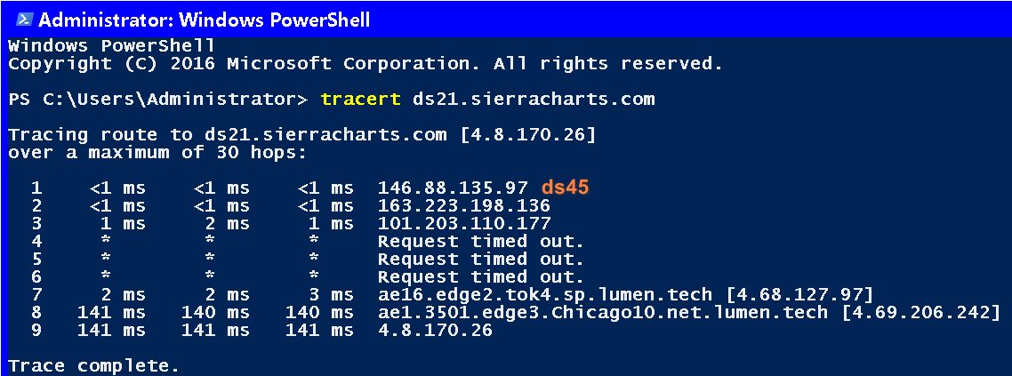

Latency and performance of Sierra Chart Denali Exchange Data Feed for CME data from the Tokyo Japan server:
Attached is a video, from the morning February 11, 2026, at 8:30 AM US Eastern time. This is during the employment economic data release.
Attached is also a screenshot showing the trace route from the server, to the Aurora CME data center.
This video was taken from our Tokyo Japan server. You can see the latency to the exchange timestamp in the "DD:" field at the top of the chart.
This field is measured by taking the difference between the time on the computer, which is synchronized to NTP servers in Asia, and comparing it to the timestamp, of the trades or bid and ask data using the timestamps from the CME Globex system. There is precision to the millisecond in this calculation.

And one more thing, we connected to the Tokyo Japan server, from a location in New Zealand, and while the Data Delay increased about another 100 milliseconds, due to network latency, the update speed is the same as when we connect directly to the United States servers. It is fast and continuous and no delays.
So any user connecting in Asia to the Sierra Chart Tokyo Japan server, absolutely is not going to have an issue as long as the Internet connection they have, is working well.
So we have shown, there are no problems receiving the Denali Exchange Data Feed in Asia and we are confirming there are no problems, receiving the Denali Exchange Data Feed, as far as way as New Zealand. New Zealand is even further from the the Midwest of the United States as compared to Thailand to the Midwest of the United States.
Clearly there are no problems, with the Denali Exchange Data Feed in Asia at all.
