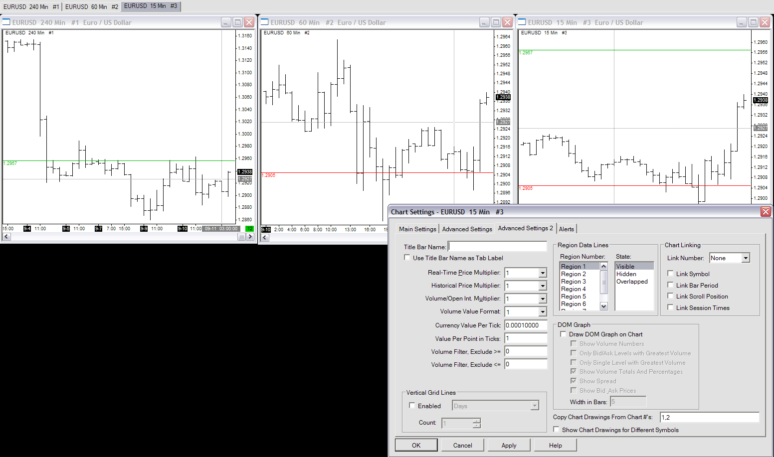

working fine here (sc prerelease 1189). have a look at the attached screenshot.
three things that come to my mind, why it's not working for you:
1. in the destination chart, in the field "Copy Chart Drawings for Different Chart #'s" you only put the source chart(s)
2. above your using the syntax "2:3". this should be "2,3"! with chart #2 and chart #3 both being source charts.
3. e.g. the drawings come from a weekly or daily chart and you want to see them on a 5 minute chart. => you might have to adjust your vertical scale on the destination chart to see the drawings from higher timeframes!?
