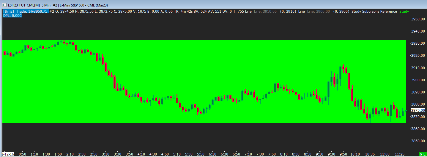

The Study Subgraphs Reference study is used for shading between two subgraphs that are not in the same study.
However, this study seems to return the incorrect values, and the shading does not match the referenced subgraphs' values.
The attached Reference of two lines.png shows two lines at 3900 and 3910, but the shading is from 3864 to 3932

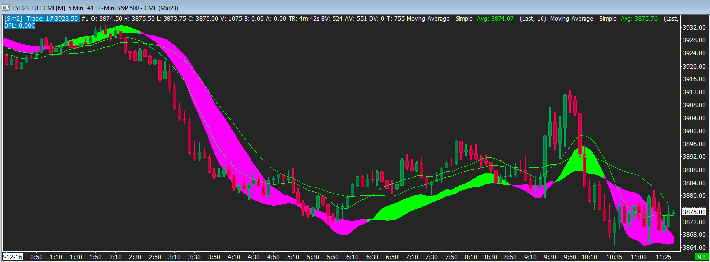

The attached Reference of tow MAs.png shows the shading above the higher MA and below the lower MA.
Note: The Study Subgraph Reference study accurately returns the referenced subgraph's value.
