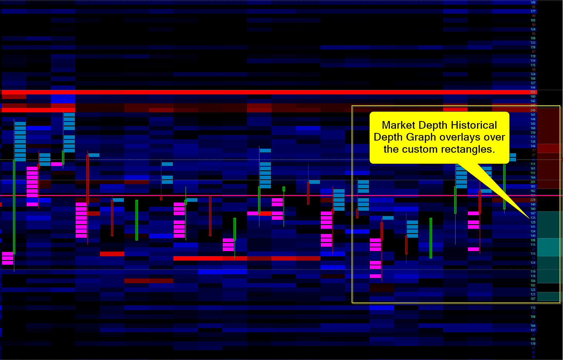

I am using Sierra Chart Version 3168 and working with onn@trade29.com to create a custom study that automatically draws rectangles using the Sierra Chart Drawing API (the same API that is used to manually draw rectangles on the chart via the rectangle tool), not the GDI Api.
The issue we are having is that Market Depth Historical Depth Graph study has priority over the style used to draw the rectangles. This is preventing the drawings from being overlayed on the Market Depth Historical Graph study. As a result when the Market Depth Historical Graph study is added to the chart the rectangles are covered by the Market Depth Historical Graph and cannot be viewed with the Market Depth on the chart as intended.
We've tried the check box for "Draw Study Underneath Main Price Graph" on and off for both the custom study and the Market Depth Historical Graph Study. And also tried the "Draw Advanced Custom Study Drawings Above Other Drawings" setting in Chart Setting > Advanced Settings. We were unable to resolve the overlay issue with either setting. See attached image for example.
Is there something that can be done on your end to resolve this matter?
Your assistance is greatly appreciated.
Thank You
imageRectangles Without Market Depth Historical Graph .png / V - Attached On 2020-09-22 21:29:59 UTC - Size: 62.55 KB - 444 views
imageRectangles Hidden by Market Depth Historical Graph.png / V - Attached On 2020-09-22 21:30:07 UTC - Size: 132.68 KB - 386 views
