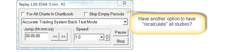

SC Team - At present I have few dependencies between charts and the data gets populated on multiple charts and gets shared between charts in a chartbook. They are all setup to use Proper precedence and uses few shared structures. However I am unable to use the replay feature properly on all charts at present as the study on master charts doesn't get reset and is aware of ALL the data till end of chart. If I do a manual reset - I would have to perform this reset on ALL charts in the chart book - which is really not an elegant solution and tedious task.
Would it be possible to include a flag or some sort to "recalculate" all studies for all charts in chartbook as well as part of the replay option below?
if this is not possible - Would you please let me know the way to force "recalculate" all studies and for all charts in a chartbook? I came across this keyword from a different thread - "sc.InternalFR = -17" but don't know how to make a call for this. Any example code?

imagesc_replay_initialization.jpg / V - Attached On 2014-01-04 20:16:35 UTC - Size: 41.92 KB - 664 views
