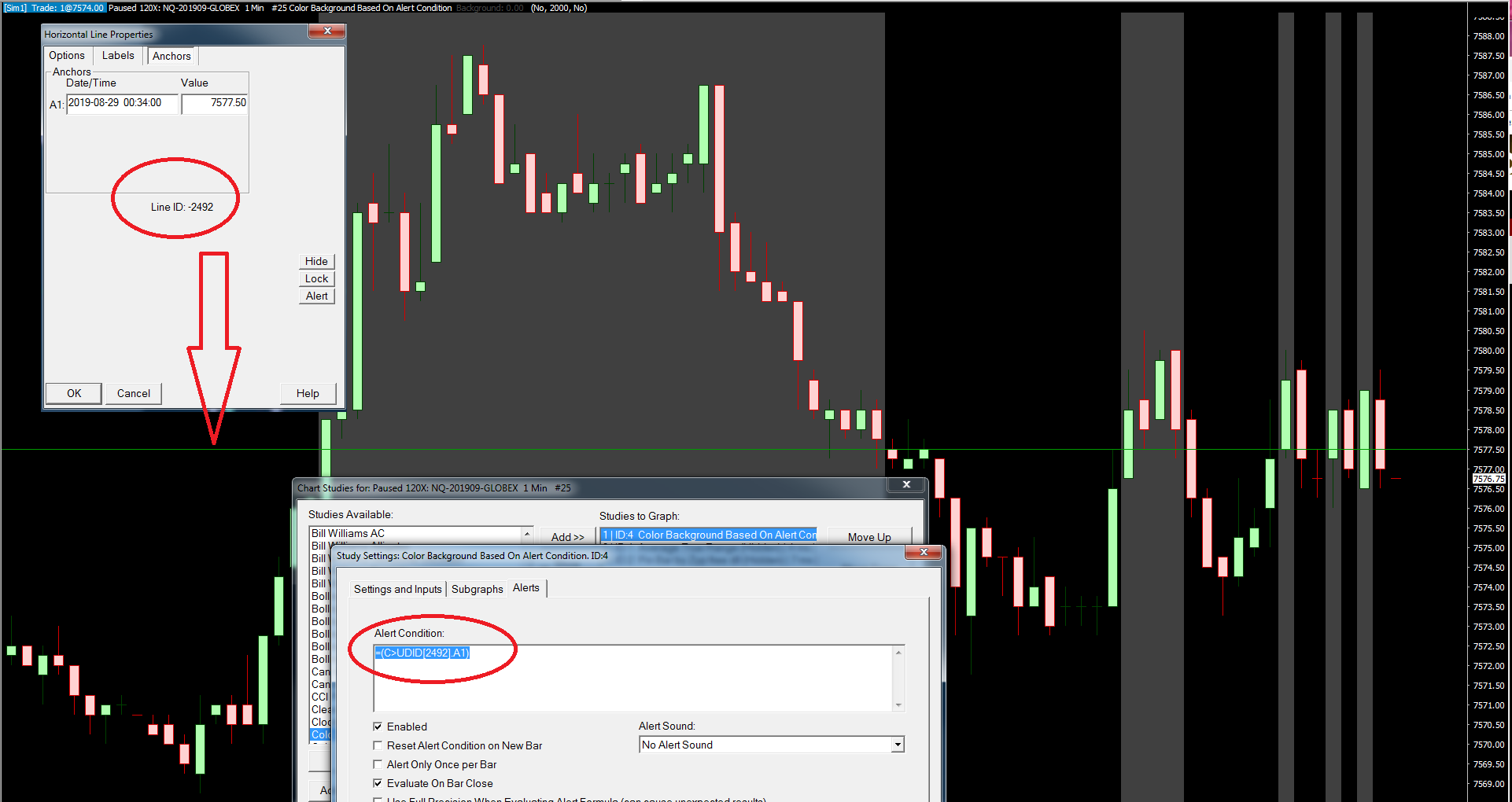

The Chart Drawings Window shows the Horizontal Line ID is "-29". The alert sound of the Horizontal Line is alert 1. So according to your last post (as I understand it), UDID[-29].A[1]=1 should color the background if the alarm gets triggered, right?
No... :)
Look at attached picture (line ID.png) .... and you can add other conditions with next elements,for example range (line ID range.png)
But that line must exist (before) to know its ID. If you don't know - you have nothing to refer to. That's what I wrote above.
The second option is to alert to value from Y-axis, see my first answer in this thread.
The third is a summary window and tracking only selected values.
Perhaps it helped you.

imageline ID.png / V - Attached On 2019-09-01 10:53:49 UTC - Size: 172.27 KB - 587 views
imageline ID range.png / V - Attached On 2019-09-01 11:18:13 UTC - Size: 85.54 KB - 585 views
