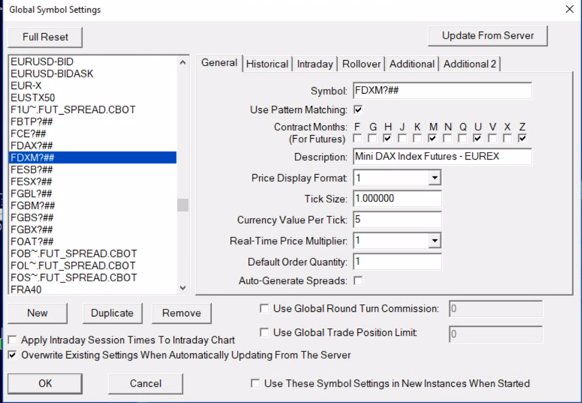

yes its there.
Just tested on a different PC with 1842. Same error message even after Global Symbol Settings -> Update from Server.
Here the message log from the 2nd machine:

Date Time Of Last Edit: 2018-11-21 17:52:33
imageSC-FDXM.png / V - Attached On 2018-11-21 17:41:37 UTC - Size: 202.91 KB - 370 views
