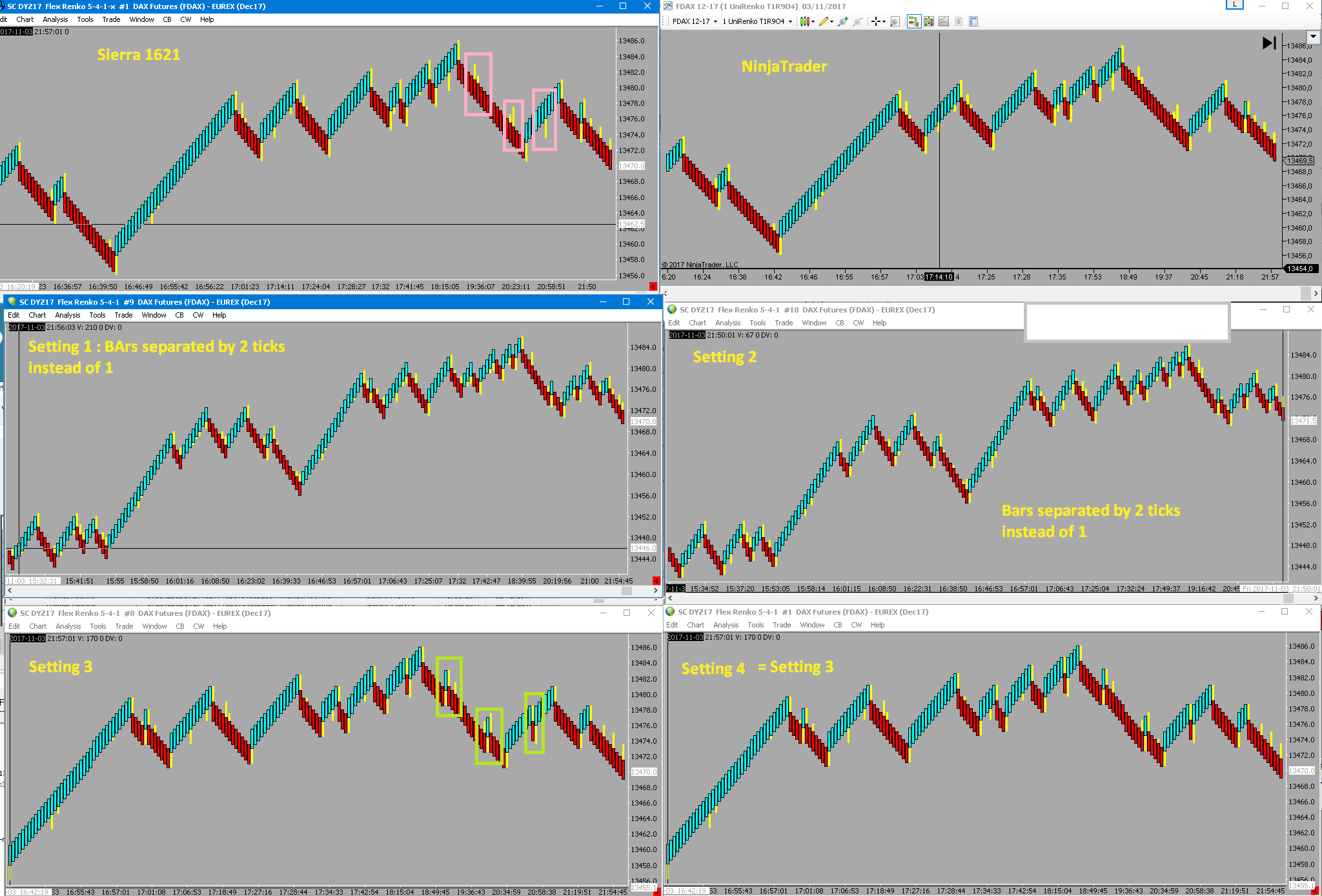

ok here are a couple tests
Reference chart is SC 1621 5-4-1-x chart, along with NinjaTrader chart (they match perfectly)
These charts are the 2 on the top.
1. FlexRenko 5-4-1 (Fill Off)
*In exceeded mode, consecutive bars are separated by 2 ticks instead of 1
*In the other mode, separation is OK but I get a reversal (green rectangle) instead of reference wick (pink rectangle)

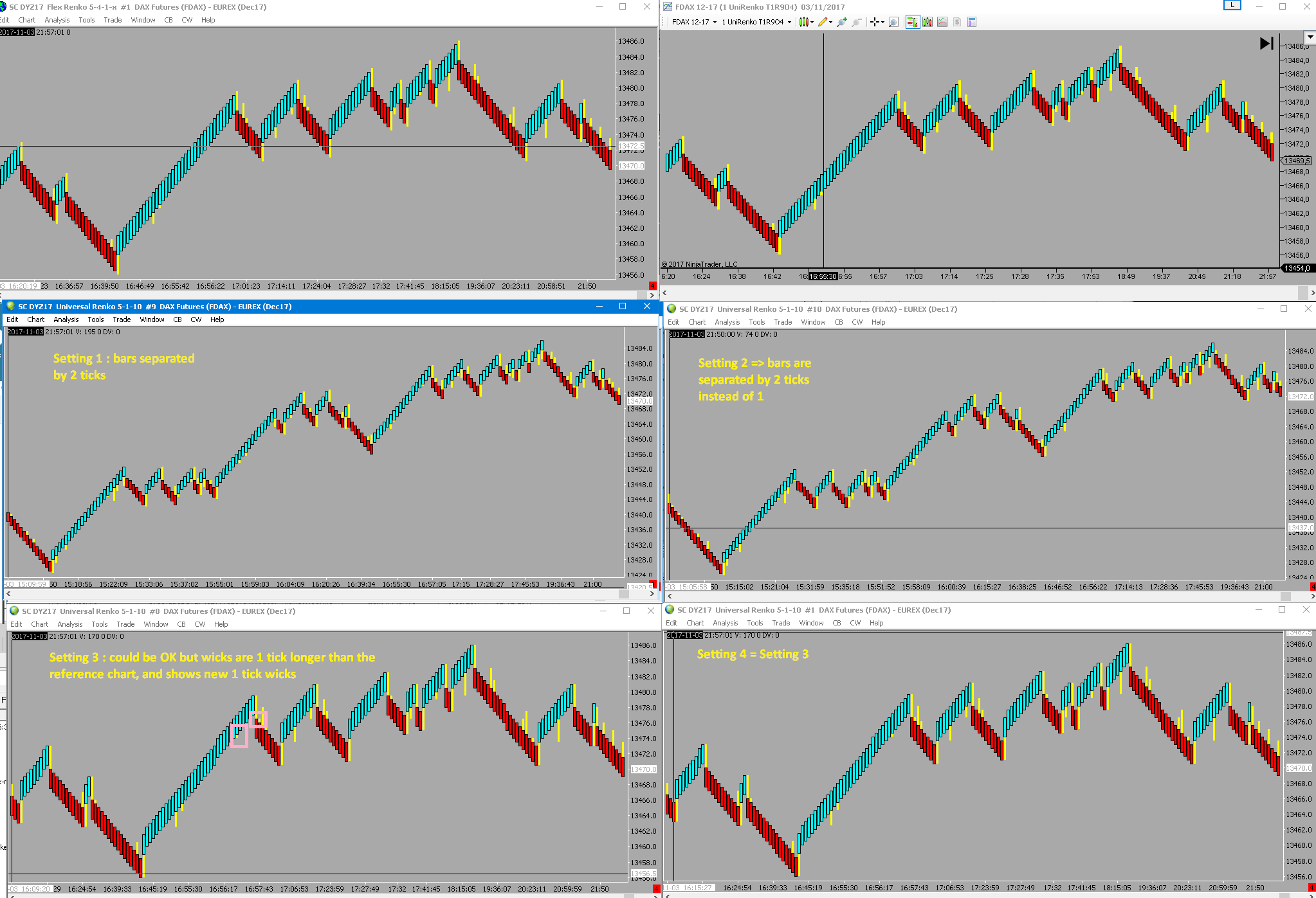

2. Universal Renko 5-1-10 (Fill Off)
* In exceeded mode, same as flex renko : bars separated by 2 ticks
* In the other mode, the chart is nearly ok, but the wicks are all 1 tick longer than the reference chart, and exhibit some new 1 tick wicks(pink rectangles)

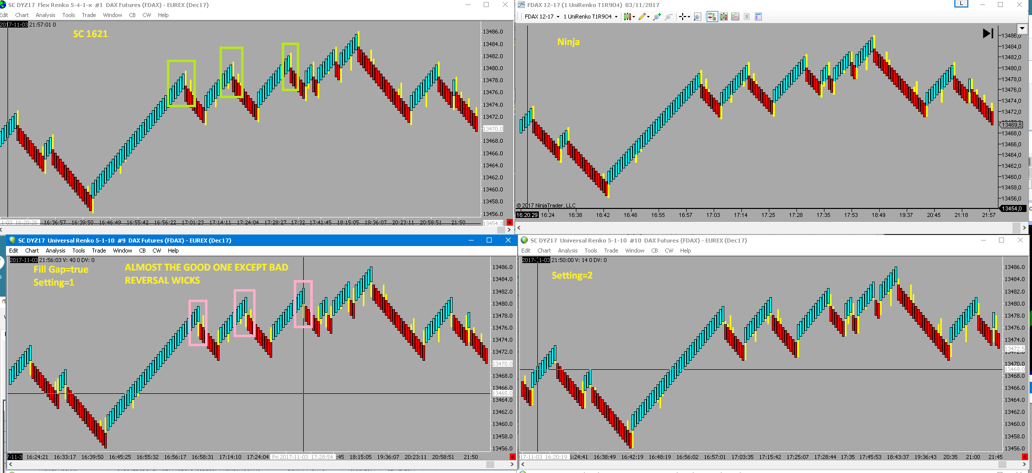

3. Universal Renko 5-1-10 (Fill On)
* Exceeded mode now repaired. Setting 1 could be the one if the reversal wicks were on the other side (green vs pink rectangles)
So it seems we are making progress, not there yet, but close !
imagenewflexrenkowithsettings.png / V - Attached On 2017-11-06 16:22:38 UTC - Size: 109.14 KB - 1220 views
imagenewunirenkowithsettings.png / V - Attached On 2017-11-06 16:22:58 UTC - Size: 105.91 KB - 559 views
imagenewunirenkowithsettingswithfillgap.png / V - Attached On 2017-11-06 16:23:09 UTC - Size: 122.83 KB - 597 views
