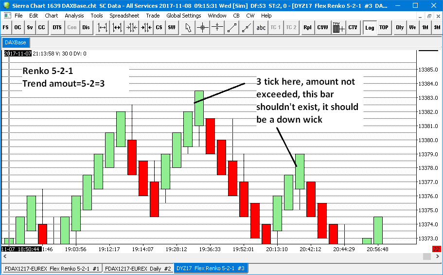

2. Question : instead of having "New Reversal Bar When Reversal Amount Met"/"New Reversal Bar When Open Crossed(what does that mean)'????, could we have, like for the trend bars, a simple Amount Met/Amount Exceeded ? This would very likely restore the original functionality.
3. The "New Trend Bar When Exceeded" setting is not working (see chart)
imagerenkonew.png / V - Attached On 2017-11-08 08:18:35 UTC - Size: 37.38 KB - 731 views
[2017-11-08 18:12:33]
We think you are looking at the wrong place on the Renko documentation page for the description. You need to refer to the Introduction section for the full technical description:
http://www.sierrachart.com/index.php?page=doc/RenkoCharts.html#Introduction
The other subsections, will as necessary describe alterations to the Introduction, like in the case of Flex Renko and Universal Renko or go into more detail where needed.
2. We still have to write up documentation for this. We will see about adding this.
We have looked at your screenshot, and we think the issue involves what is a completed Renko bar. Sierra Chart uses a definition of a completed Renko bar to mean where the open to close is equal to the bar size. The "Exceeded" mode does not alter this definition. And we very strongly question the validity of altering this definition in that case especially in relation to the standard Renko bars.
The concern at this point is not comparison to what was, or to another program, but what makes sense. The point of reference should always be to standard Renko bars, and what is considered a complete bar. If a complete bar is simply determined based upon the distance between the Open to Close, then that is what should be used consistently.

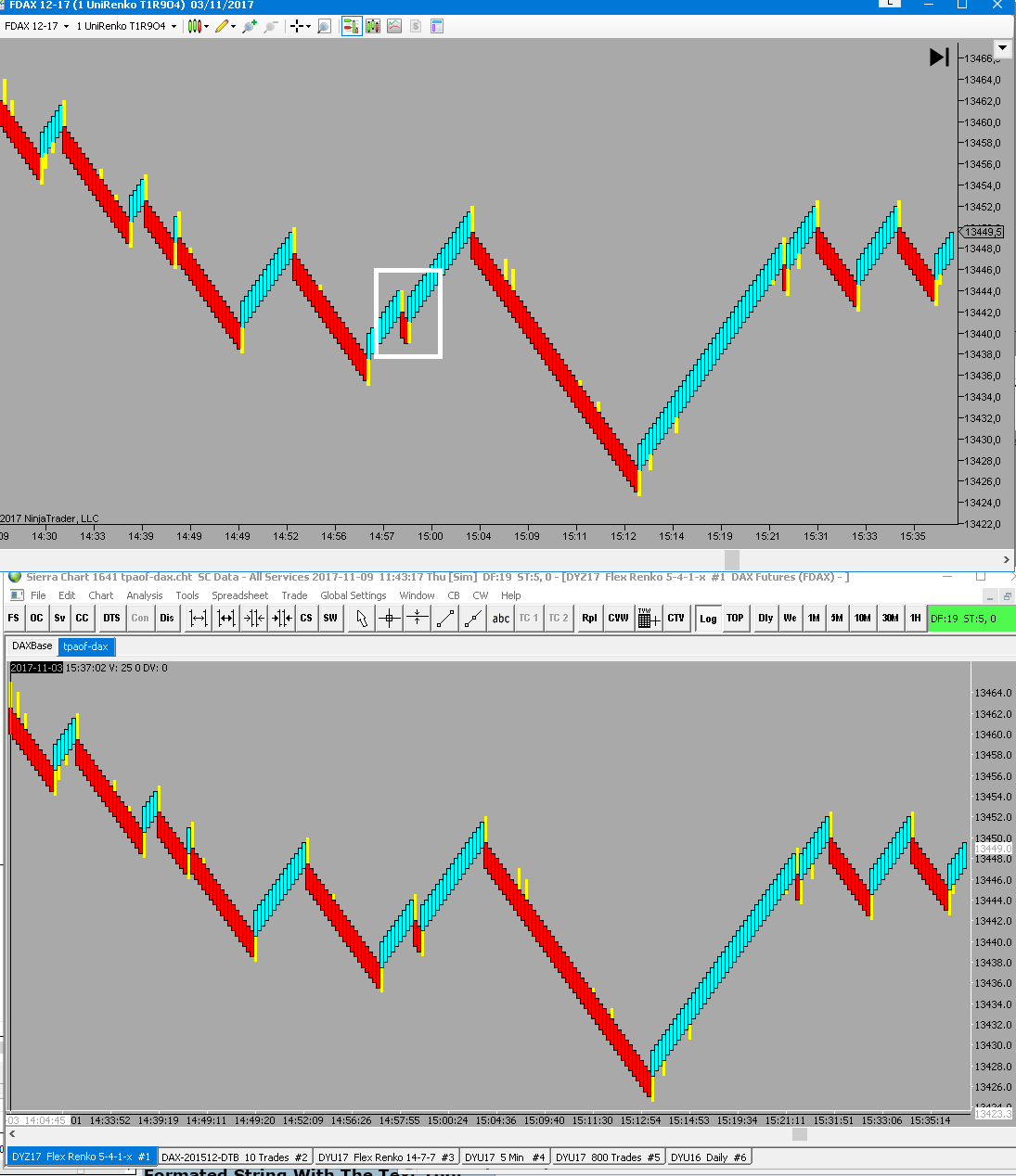

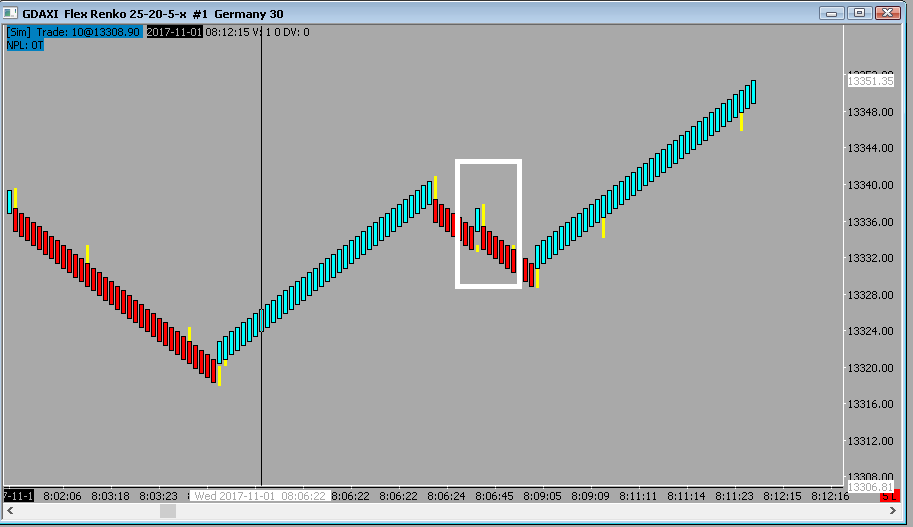

[2017-11-09 10:59:23]
gomifromparis - Posts: 244
It looks perfect on the DAX!!! Better even then on NT where there were occasionnaly a glitch (white square on attached chart) !
Small issue on GDAXI though, where some candles have holes (second attachment).
imagerenkook.png / V - Attached On 2017-11-09 10:58:36 UTC - Size: 76.39 KB - 980 views
imagerenkookgdaxi.png / V - Attached On 2017-11-09 10:58:42 UTC - Size: 20.08 KB - 584 views

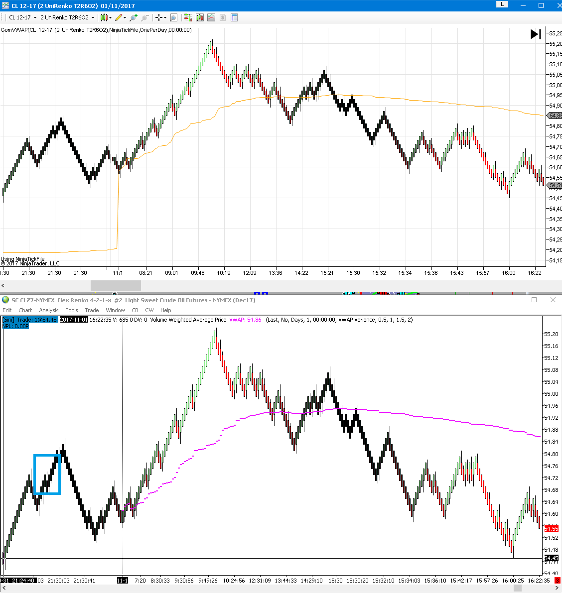

[2017-11-09 12:42:12]
Good to go on the CL Ninja UniRenko 262 aka Flex Renko 421x as well, except the same hole in the candle as seen on GDAXI (high volatility moment, gap fill=true). See the blue square.
imagecl262.png / V - Attached On 2017-11-09 12:41:53 UTC - Size: 85.49 KB - 629 views
[2017-11-09 18:28:05]
In regards to the spot where the High-Low is not connected with the bar, actually must be correct because what happened on that bar with the gap is that there was an actual gap of price movement and that particular trade caused both a reversal and initiated a new bar. Since it initiated a new bar, it was added to the next bar. So the high low you see is correct.
We would not do anything to fill that.
The bar high represents the highest high and the low represents the lowest low of the actual trades contained within that chart bar.
Date Time Of Last Edit: 2017-11-09 20:29:16

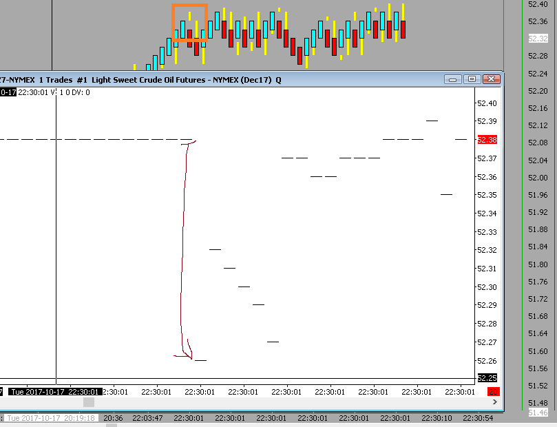

No sure I'm getting it, ok here on the example the market dropped 12 ticks, but I'm in gap fill mode.
Why do we have a hole in the reversal candle on that move down ?
If we have a 12 tick gap in the trend direction, we get 12 nice up bars. Why a hole if we get a 12 tick down move ?
imagehole.png / V - Attached On 2017-11-09 19:49:43 UTC - Size: 21.9 KB - 588 views
[2017-11-09 20:32:10]
There are no holes/gaps in regards to the Renko bars themselves. Those are always filled in.
We tried to explain this as best as we could previously. We cannot spend more time on this. It does make complete sense. We made a slight addition to our prior response.
This discussion must come to an end. We are not going to say anything further. In the end, if these bars do not meet your requirements, then make your own. Also you would see less of that situation if you do not use this new mode we added. This new mode makes no technical sense to us.
Date Time Of Last Edit: 2017-11-09 20:32:43
[2017-11-09 22:52:23]
It's OK don't touch the bars. But please at least explain why, when the market gaps down from 52.38 to 52.26 in 1 tick, we get a series of Renko candles with a gap between 52.34 and 52.36 ? ( see my previous hole.png chart).
Why 52.34 and 52.36 ? Nothing happened at those prices, market just went, on 1 tick, from 52.38 to 52.26
(october 17 , CL close)

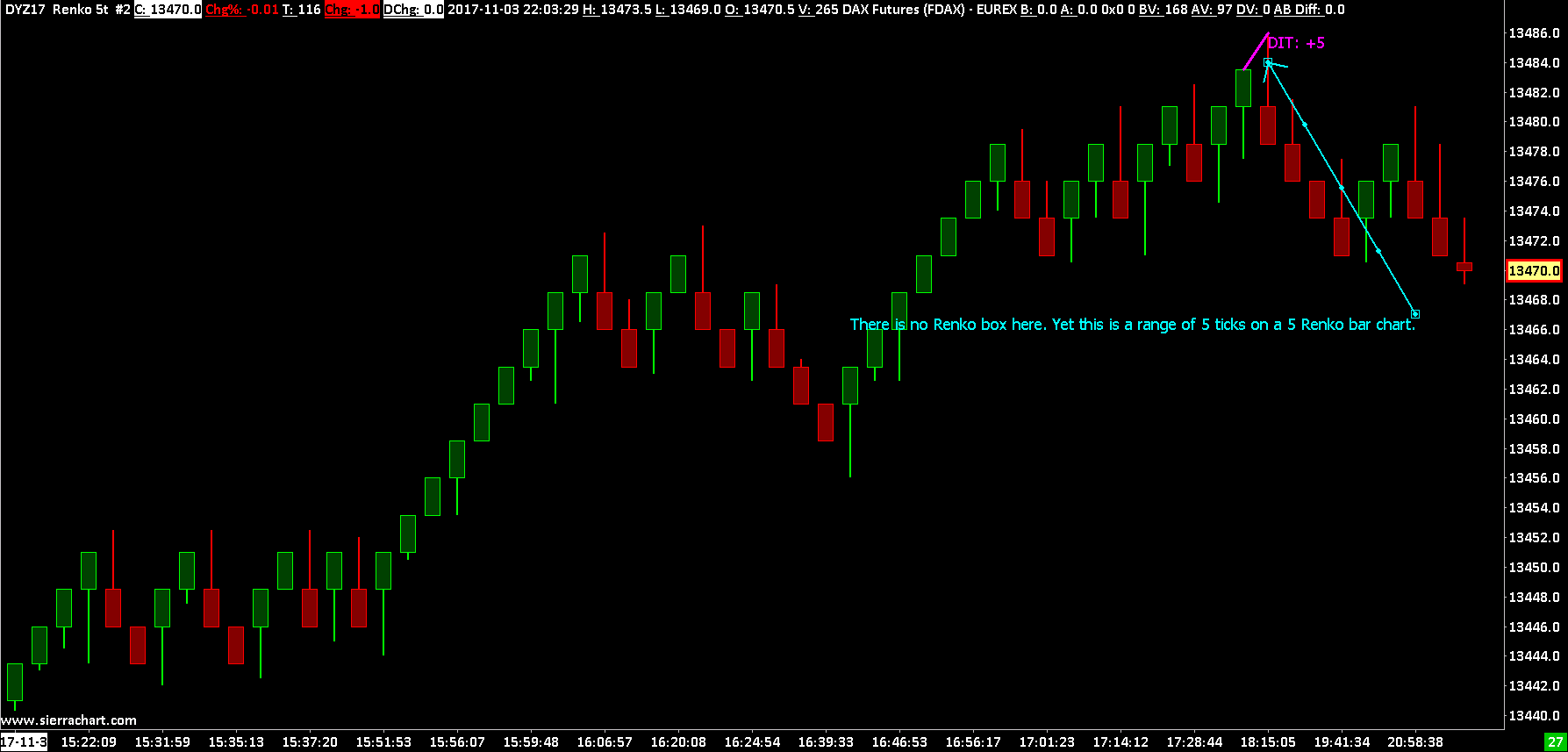

[2017-11-20 00:20:16]
Of course there is a logic, you're just too obsessed by proving them wrong that you're not trying to understand it.
What we have determined, is that aside from the nonzero Flex Renko offsets for trend and reversal bars, the NT Universal Renko bars, do not follow standard Renko logic in regards to points of reference and the starting of a new bar.
What you end up with is a high to low range at some points of reversals where there could be a complete Renko box shown, but there is simply is not.
Refer to:
http://www.sierrachart.com/image.php?Image=1511137149129.png
Now any average average user will look at that and say why is there not a box there. There should be.
With the 9 different Renko New Bar Mode options, Sierra Chart gives you the full flexibility to accomplish what any user wants now. One methodology simply is not correct. That is clear. What you can see in the Sierra Chart image above, is that the logic you have described, now can be applied even standard Renko bars.
The Ninja indicator and the previous Flex Renko implementation use the virtual Renko open = previous bar close. So they measure everything starting from there.
Once you get that, everything just makes sense. I attach a chart describing very clearly how it works. It is perfectly logic.
It was not this simple but we finally got it in 1647. The more recent changes before this, still were not correct.
Post #64 will have to be explained another time. We cannot spend time on that now, but it is all correct.
