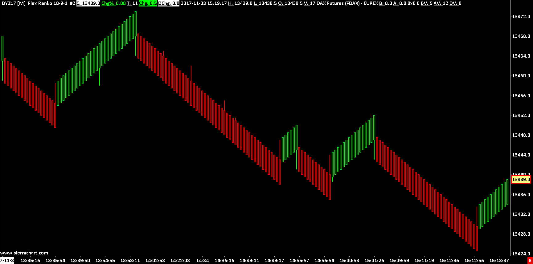

On your new chart, the reversal are sometimes like the previous ones (orange rectangles), sometimes not (blue rectangles). Why this change ?

Moreover, it seems that most consective bars are 1 tick apart, but some are 2 or 3 ticks apart(pink rectangle), and some 0.5 tick apart(yellow rectangle)
This is handled just by filling the gaps using one of the options here:
Renko Bar Charts: Filling of Price Gaps with Renko Bars
The chart images provided in this post, do use Fill All Bar Gaps.
At this point just wait for the new options. So as you can see, with the addition of just simply single-line if statements, we can modify the behavior easily. The new code is very well structured.
