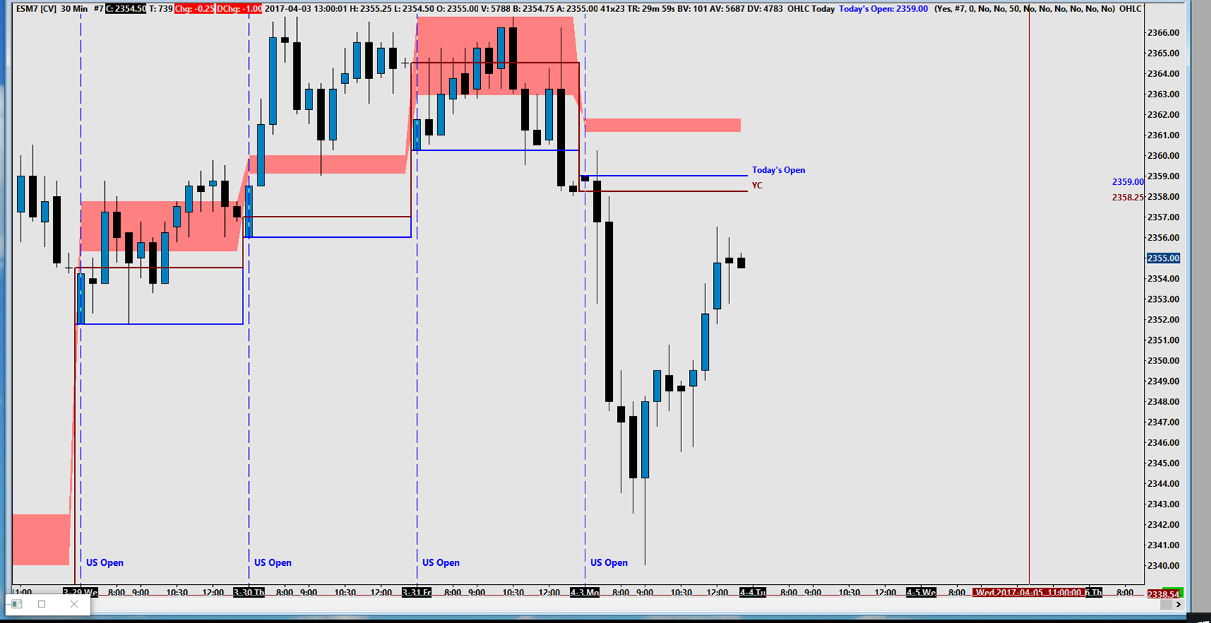

Ok SC Engineering I have moved the study to the bottom and I'm getting the same offset on the shaded area. I'm using the study subgraphs reference and am inputting these 2 lines from the same chart. Today's Open and Yesterdays Close. The filled area is offset up, not left or right so it's not the offset setting.
Could it be the setting that I have the lines drawn? I've tried line, dash, stair step, and others. For the shading I'm using Trans Fill Top and Trans Fill Bottom. I've also tried others.
I've created a chartbook with only this chart in it. The entire chart has 4 indicators. OHLC for Today's Open, OHLC for Yesterday's close, study subgraphs reference, and a vertical line that show's the US Open for the ES. I'm on west coast time. I have the session settings at 6:30am to 1pm PDT.
I know you didn't ask for it but I've attached the chartbook anyway to save a step. It's here if you need it but this should be much simpler than it is. There are many more indicators that are much more complicated that I've worked with that work just like they're supposed to.
Please take a look and let me know how to fix it. Thank you.
