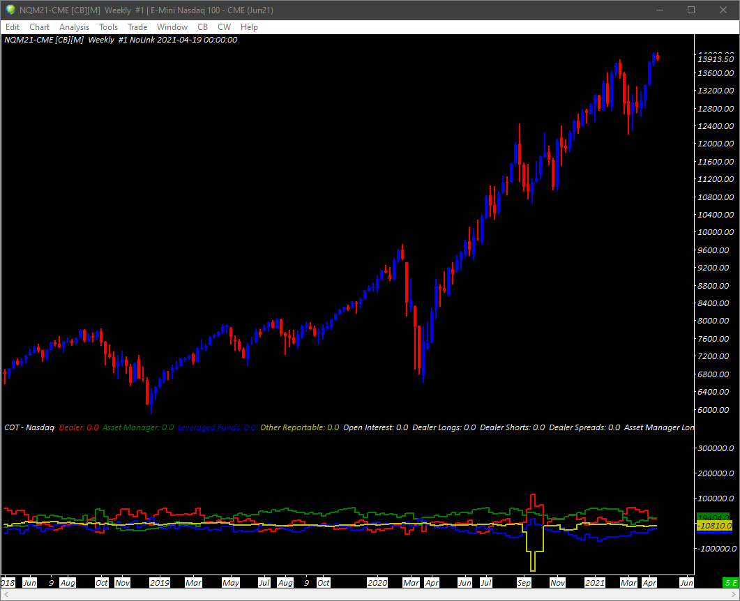

I'm not sure what I'm doing wrong. File compiled well and it was copy automatically by the compiler from /ACS to /Data. API code provided in the study and intrument was selected. Chart area is displayed but values are all at zero and nothing seems to show up ... The study referes to this URL : https://www.quandl.com/api/v3/datasets/CFTC/%s%s.csv?api_key=%s&start_date=%s Not sure if this is still valid ?? Any advises. Date Time Of Last Edit: 2021-04-19 14:44:41
| [2021-04-19 15:42:57] |
| User907968 - Posts: 885 |
It is working ok here. What time frame are you using? Try using daliy or weekly chart if not already. Also do you have an errors in the message log? |
| [2021-04-19 15:51:26] |
| User837393 - Posts: 161 |
I dont see any errors. The chart area displays but all values are at 0.00. Curently using 3 min chart. On the link I provided above ... clicking on it leads to a 404page error. Why would it work in the study if its not working into a browser. Do I have to subscribe to a specific data package in Quandle.com ? Date Time Of Last Edit: 2021-04-19 15:51:56
| [2021-04-19 16:07:35] |
| Using SC Since 2020 - Posts: 150 |
The study is meant for weekly bars. 3 min may cause huge gaps in displayed data, making it appear as though there is no data.
| [2021-04-19 16:22:25] |
Yes, as above, no good for low time frame charts. Free Quandl data is fine, try this link instead also: https://www.quandl.com/data/CFTC-Commodity-Futures-Trading-Commission-Reports |
| [2021-04-19 16:50:13] |
ok I got it to work on the weekl/bar candle time frame. Interesting that the url is not working in the browser, but works in the study. |
| [2021-04-19 17:20:31] |
I see what you are getting at now, that link is from that actual study code and is not a complete hyperlink - the study replaces the '%s' sections with the appropriate information, so trying to follow it directly will most certainly lead nowhere. |
