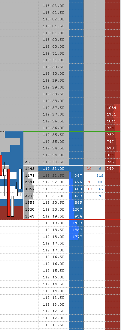

User611675 - Posts: 5
I have noticed that my dom prints are occasionally different between SC on Windoze and various linux distros using wine as well as via crossover on mac (see screenshot).
Does anybody know why this happens?

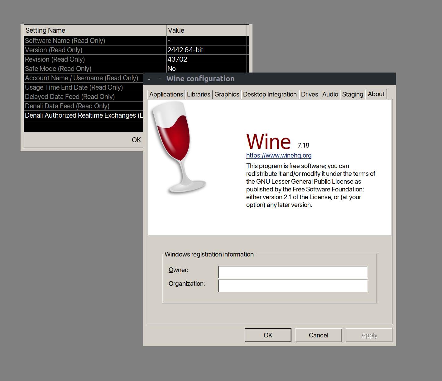

d9e5c763 - Posts: 112
just upgraded to a new ver of wine and there is no window freeze problem
imagescreenshot-20220928-055546.jpg / V - Attached On 2022-09-27 21:57:00 UTC - Size: 116.37 KB - 796 views

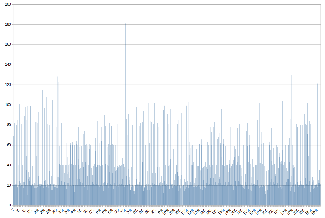

[2022-11-03 13:19:53]
Luigi - Posts: 18
Yeah, I have been bothered by lags around opening of index futures products.
To measure the lags I just put a timestamp on last price updates in my code and then just plot the deltas. theoretically (around opening at least) you have almost continuous price updates, and you should see, on average ~20ms updates , but as you can see on the chart attached, there are bigger lags, and above 100ms ones can be perceived as laggy chart...
imageLagExample.png / V - Attached On 2022-11-03 13:18:03 UTC - Size: 45.34 KB - 663 views
[2022-11-03 16:17:35]
R1sk - Posts: 259
@Luigi I think the Delta method is the best we can do. It can calculate the total lag, which is sufficient in principle, but on the other hand, we cannot be sure what it consists of.
For example, the time at the processing point can be very different compared to the time when the packet was received, which means that the latency comes from our computer. Whether it's the acsil code, Sierra, or the OS, we don't know.
A while ago I asked support what kind of latencies we can expect to get on a colocated SierraChart, they said 20ms, which is in line with your average result.
Date Time Of Last Edit: 2022-11-08 07:30:43
