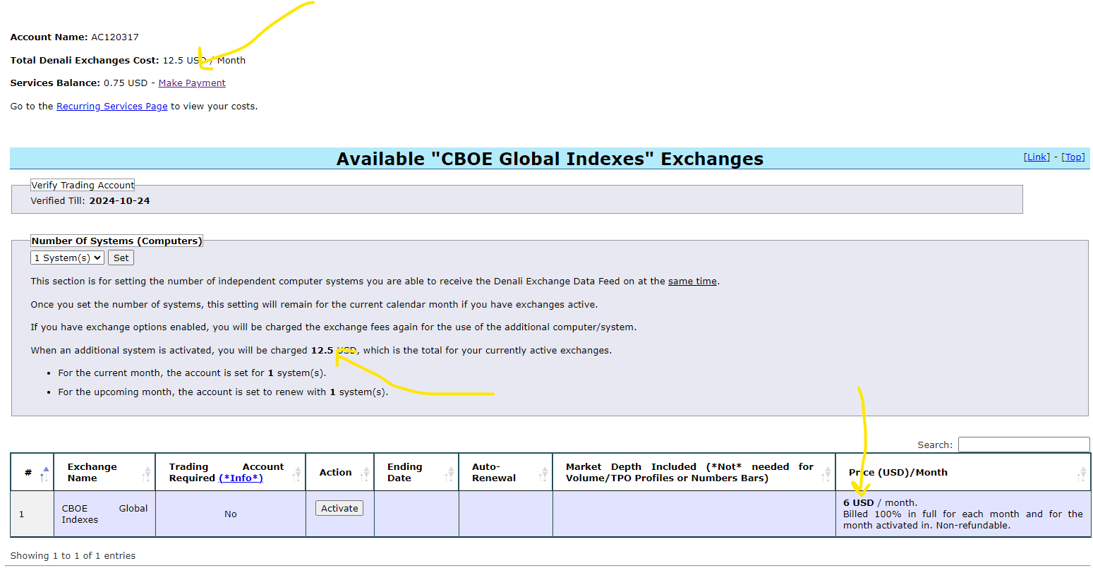

Also I am looking to add the CBOE Indexes and am a little confused is it 12 amonth or 6 the iforamtion is a little unclear..pleaase see attached
imageScreenshot 2024-09-25 124935.png / V - Attached On 2024-09-25 16:50:30 UTC - Size: 77.59 KB - 350 views
[2024-09-25 21:17:30]
The order types you are using are all server side, so you do not need to worry about your local copy of Sierra Chart. Once you enter the trade, the orders will be dealt with by the exchange regardless of the state of your computer.
The CBOE Indices exchange is $6.00 per month.
The information you are referencing is if you were to change the option for the "Number of Systems" to be 2 computers instead of 1. Since your current exchange fees are $12.50, it is telling you that you will be charged an additional $12.50 as soon as you change the option to 2 computers. This is not relevant to what you are dealing with.

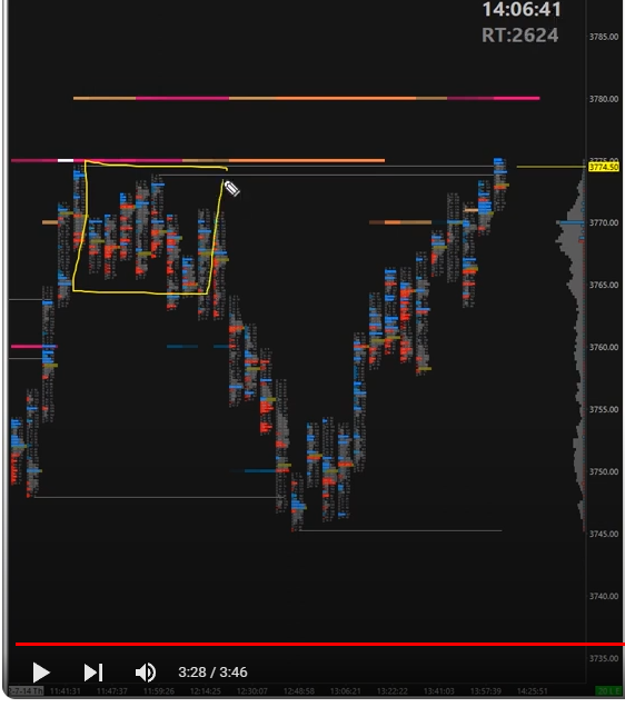

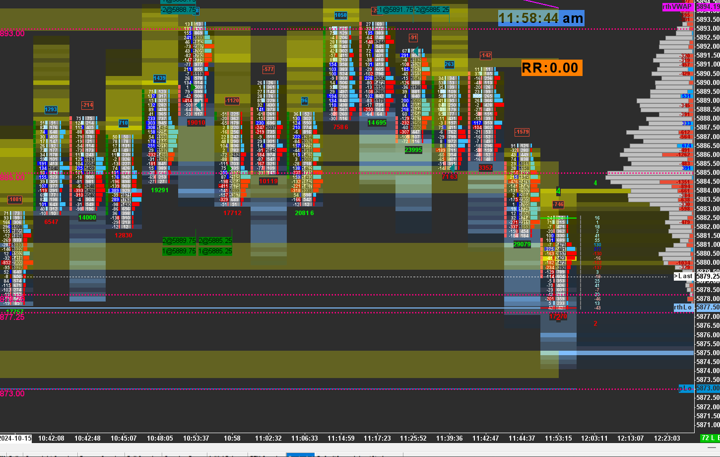

[2024-10-15 15:59:44]
coachted - Posts: 544
HI John,
Found a guy that has the market depth history on a numbers bar but his is clean vs mine...his is the first picture mine is the second. I read the description and support material and am confused how to do this....I have messed with the settings but can not replicate the other chaert....can you point me in the right direction
imageScreenshot 2024-10-15 115308.png / V - Attached On 2024-10-15 15:57:45 UTC - Size: 171.25 KB - 358 views
imageScreenshot 2024-10-15 115850.png / V - Attached On 2024-10-15 15:59:40 UTC - Size: 235.85 KB - 206 views
[2024-10-15 16:22:25]
Your Market Depth Historical Graph is only showing a few specific levels. The rest are getting lost somehow. The best thing to do is to turn on the display of the values in the Market Depth Historical Graph, so you can see the actual values. Then you would need to adjust your Minimums and Maximums to get the kind of information you are looking for.
Due to the complexity of the Market Depth Historical Graph, and the sensitivity with different symbols and their market depth, it is next to impossible for us to give you any kind of formula that will specifically work. You need to understand how each item affects what you are seeing.
For what it is worth, all of the information for how the Market Depth Historical Graph functions is at the following link:
https://www.sierrachart.com/index.php?page=doc/StudiesReference.php&ID=375#Market_Depth_Historical_Graph
In particular, you may want to review this section:
Market Depth Historical Graph: Block Coloring Logic
