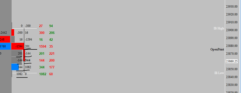

HeyUgly - Posts: 288
I think this is getting away from my actual initial request
Sierra did a good job implementing my own coded study I had made.
I only have 2 main questions.
1. In the screenshot, it shows the diagonal delta pretty much bang on. But why is there a "-" {negative symbol} on the buy volume side {right side}.
2. IS there also an option to do the same but Side by Side delta in the text display on top of the diagonal.
I am not sure what others are asking, but sierra did a pretty good job of implementing my request and i watch it beside my own personal study. I jus have those questions above.
imageCapture.PNG / V - Attached On 2025-09-06 15:26:48 UTC - Size: 11.5 KB - 321 views

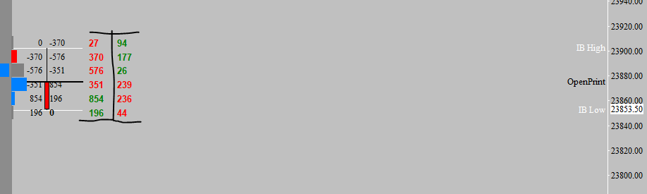

for reference on my own study the diagonal delta is the left hand column, the side by side delta is the right column where i have drawn a line in between them. I think sierra got the Diagonal part down just fine, numbers match, Im just curious why the negative symbol on the buy side of the footprint. The negative side on the sell volume side totally makes sense.
Is the option already there to also do a side x side detla text display? maybe i dod not see it.
Thank you again for adding this, and answering the above question whenever you can.

HeyUgly,
The reason why the numbers are both negative is that Sierra Chart always does the delta calculation as Ask minus Bid. It is never the opposite. So for a Diagonal Delta, the Ask side is calculated as the following:
(Ask at Current Price) - (Bid at Next Lower Price)
And the Bid Side is calculated as the following:
(Ask at Next Higher Price) - (Bid at Current Price)
As to the 1082, -344, and -144, we can not say. Although from the previous image you gave, it looks like these values are all correct, as they are aligning with what you show in your study. So we do not understand what exactly is the problem with these values.

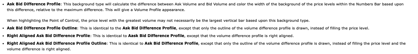

PhilipJamesB - Posts: 22
Hi John,
For the Diagonal Difference in Number Bars (specifically AV BV Diff Diagonal Bid Side in my case, and I think for other users too) there is no Background Type (ln: 17), Coloring Method (ln:18), or Text Coloring Method (ln: 19) options.
Presently, if I select the AV BV Diff Diagonal as the text option, there is no Ask Bid Diagonal Difference Profile option for a Background Type. There is an Ask Bid Difference Profile currently, but this is calculated horizontally. So if this option is selected the profile is displaying the horizontal calculation, while the text is displaying the diagonal calculation. (See screenshot of current Numbers Bars Background Types).
The same is true for both the Background and Text Coloring Methods. There are a lot of coloring options for Dominant side calculations, there is a AV BV Difference Actual and a AV BV Diag Diff Percentage of Bar Range - None of these options provide an accurately coloring of the AV BV Diff Diagonal.
I hope this description makes sense. If not, hopefully other users can also chip in.
Thanks so much
imageNumber Bars Background Types.png / V - Attached On 2025-09-09 12:53:05 UTC - Size: 61.89 KB - 241 views

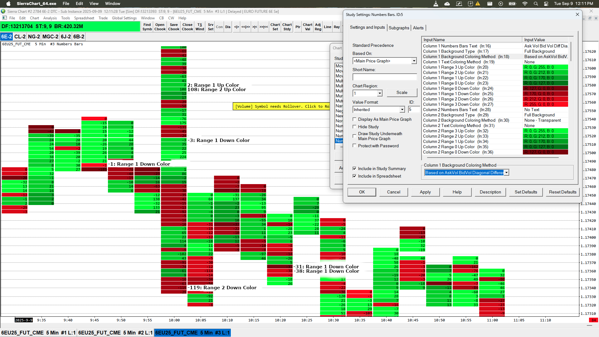

IMHO a Coloring Method for AV BV Diff Diagonal Bid Side (a diagonal delta calculation) would allow for coloring the negative and positive values separately, while also allowing for Percentage Compare Thresholds. In this scenario, all negative values are red, positive values are green. The Range 0/1/2/3 Up/Down colors are based on the Percentage/Actual Compare Thresholds (for example: dark green for 1, light green for 1000 - dark red for -1, light red for -1000).
This is not all that dissimilar to the Coloring Method: Based on AskVol BidVol Diagonal Difference Percentage of Bar Range, except that this is obviously a different calculation, with different values to the diagonal delta that I think a lot of people use.
I've attached a screenshot of a Number Bars chart with AV BV Diff Diagonal Bid Side, with a Full Background Background Type and a Coloring Method Based on AskVol BidVol Diagonal Difference Percentage of Bar Range. I've included annotation of what I think the Coloring Method should be. In the case of the AV BV Diff Diagonal Bid Side, aka Delta, being 0, the color could just be transparent.
Thanks so much!

[2025-09-09 17:32:58]
Thank you for the explanation. We understand what is being requested now.
We can not say when we would get to this particular change, but we definitely want to understand it so when we do get to it we know what needs to be done.
