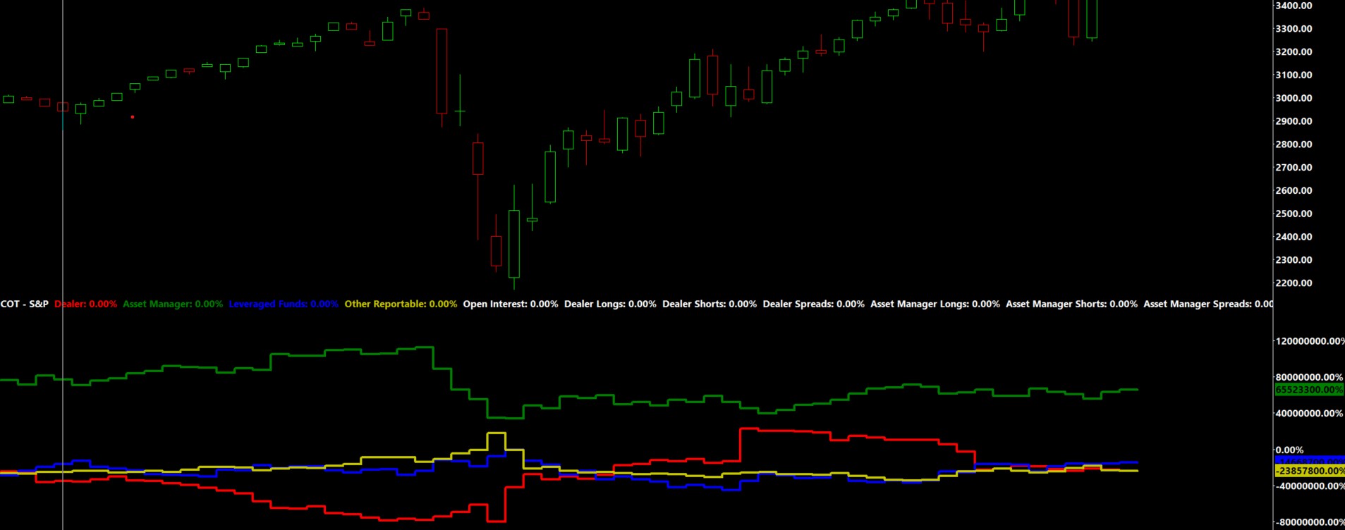

[2020-11-26 22:57:58]
User485461 - Posts: 9
Thank you guys appreciate your help.
However I'm getting the lines displayed but not the values on the top part of the chart for COT.
Is there anything I'm missing ?
Please see the attached image
imageCOT .jpg / V - Attached On 2020-11-26 22:57:24 UTC - Size: 118.84 KB - 1081 views
[2020-11-27 08:12:22]
User907968 - Posts: 885
Is there anything I'm missing?
No, there is just not any data at the last visible chart bar yet.
Scroll back to an earlier bar and the region data line values should populate.

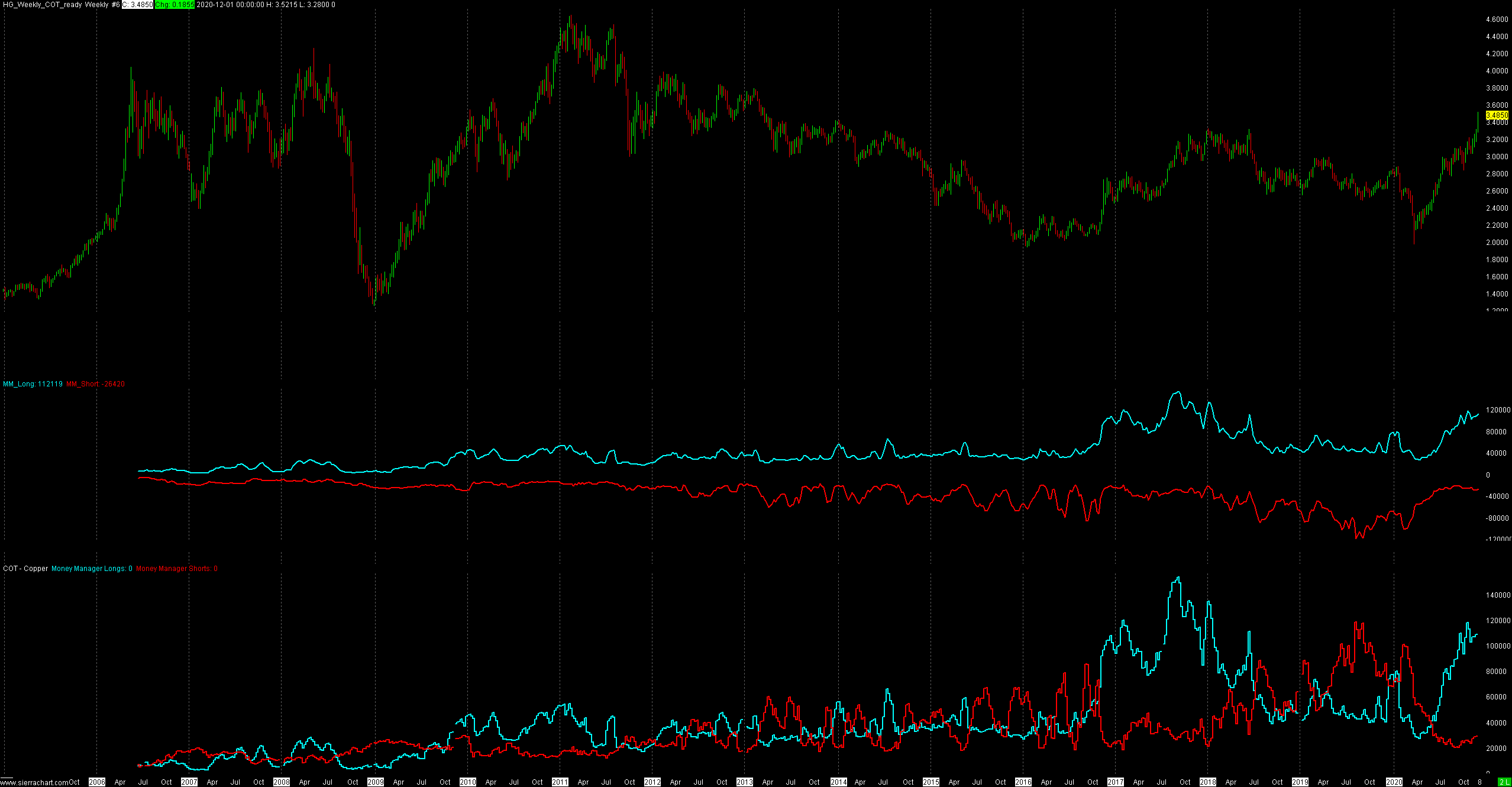

[2020-12-08 15:52:56]
Mattthespaniard - Posts: 42
Two things bug me about this otherwise nice try at a custom study to plot COT in SierraChart:
1. It doesn't seem to pick up the very last row ( most up to date ) in Quandle's dataset.
2. It plots shorts as positive integers instead of converting them to negative.
For years now I have been keeping track of COT data using SierraChart spreadsheet capabilities but I should be happy to get rid of that if only the aforementioned issues were resolved.
See chart attached for an example of what I mean. The upper indicator is my version of COT and the bottom one is the custom study. Date is 2020-12-08.
http://www.sierrachart.com/image.php?Image=1607442719491.png
