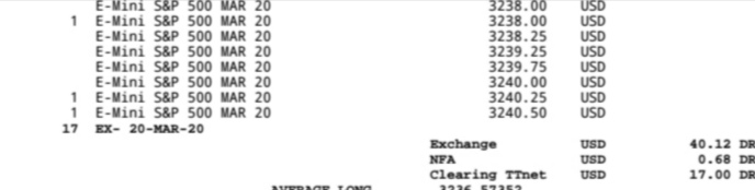

[2020-01-19 09:49:31]
User76183 - Posts: 69
Just to compare.
17 RT traded ES on TT desktop platform with AMP without any Sierra Charts services:
1 RT ES Contract:
-2.36-Exchange fee
-0.04-NFA
--1.00- Clearing TT.
In total $3.40 RT.
Of course for TT platform it should be separate fee paid $50/MO minimum
Date Time Of Last Edit: 2020-01-19 09:58:27
imageScreenshot_20200119_160407.jpg / V - Attached On 2020-01-19 09:57:24 UTC - Size: 26.53 KB - 702 views

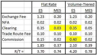

[2020-04-08 08:00:30]
User737758 - Posts: 7
edited as my typed in-line text alignment is a mess.
I am sure of Columns 1&4, but unsure of breakdowns for Columns 2&3. Pls edit for corrections. Thank you.
Date Time Of Last Edit: 2020-04-08 08:04:06
imageAMP_ES & MES rates.JPG / V - Attached On 2020-04-08 07:51:20 UTC - Size: 29.62 KB - 736 views
attachmentdetailed fees breakdown for AMP's CQG or SC-TT.txt - Attached On 2020-04-08 08:03:13 UTC - Size: 635 B - 976 views
