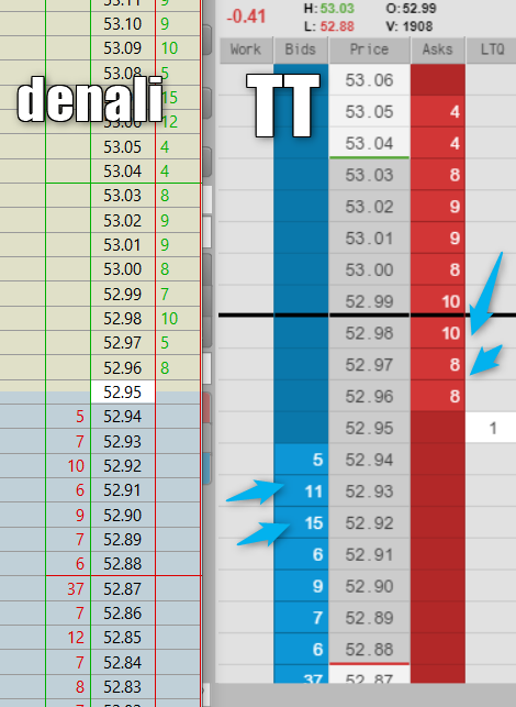

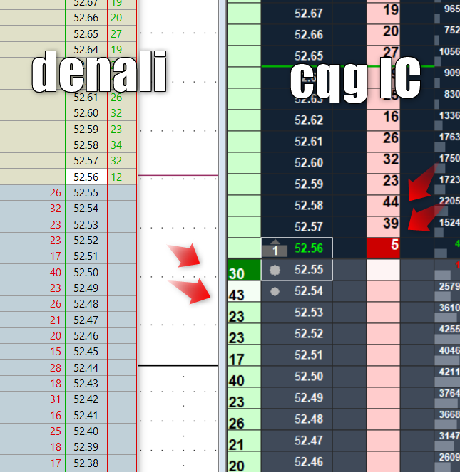

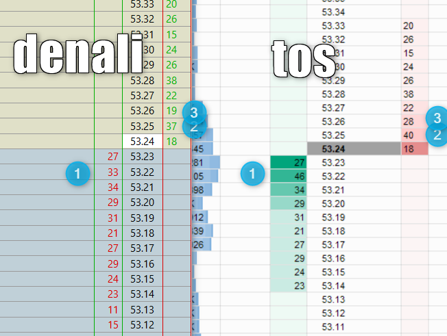

ok i see how you are going to spin this so just curious since your routing through TT why there dom is the same as cqg , tos , rithmic , cts ? are these all wrong and only denali is correct ?>
image2019-10-10_13h21_29.png / V - Attached On 2019-10-16 22:07:20 UTC - Size: 94.24 KB - 788 views
image2019-10-10_07h01_56.png / V - Attached On 2019-10-16 22:07:25 UTC - Size: 134.5 KB - 664 views
image2019-10-16_18h02_00.png / V - Attached On 2019-10-16 22:09:51 UTC - Size: 77.44 KB - 598 views

Post 35 is actually very helpful because it does prove that there is no problem at market depth level 1 with the quantities. This is consistent with what we have said (Refer to the posts from Sierra Chart Engineering at the beginning of this thread). And we said that again at post #33.
The implied depth is merged in at level 1 properly. But only the best level (Level 1). We do not merge in the implied depth beyond that level.
So this saved us some time. We will look at merging in level 2 later. So this matter is now closed.
