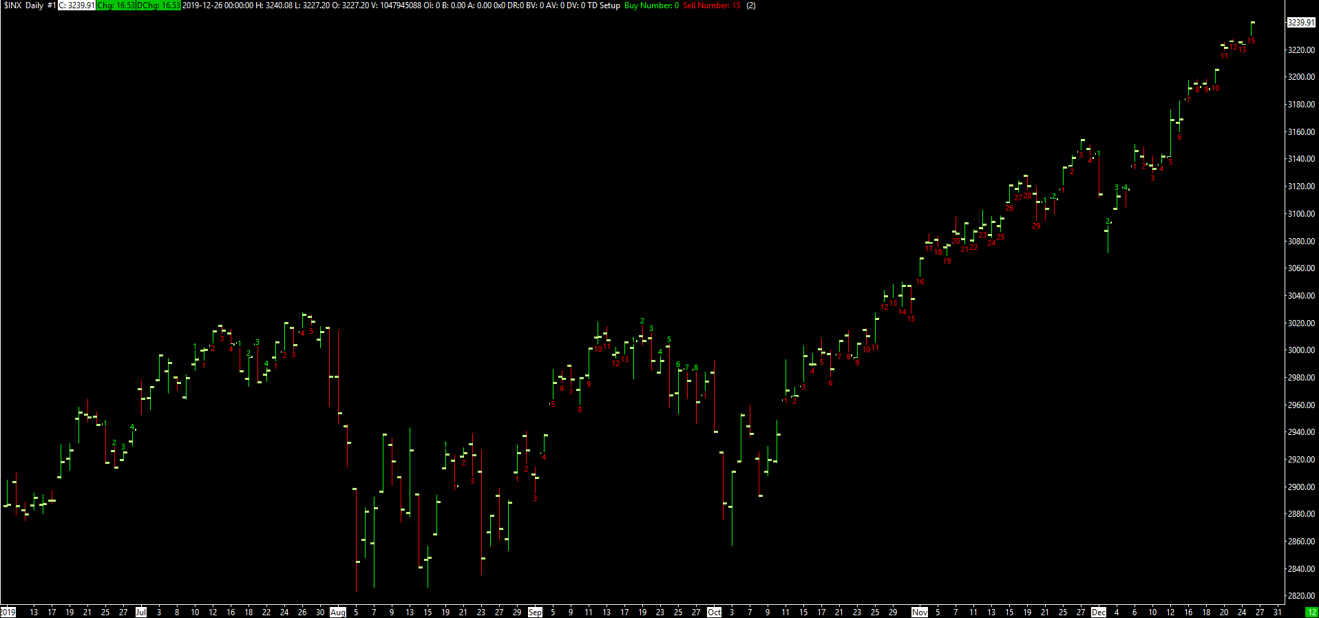

Here is a screenshot of the chartbook that I used to test this study. The bar numbering is accurate, as I verified in the attached spreadsheet.
