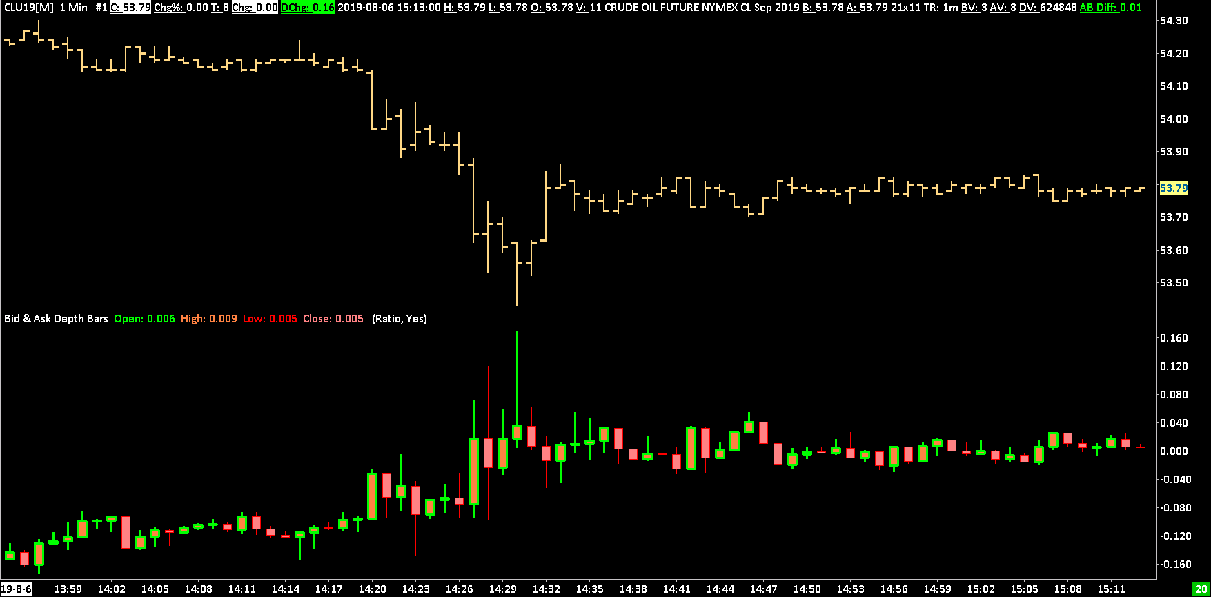

[2019-08-05 13:12:12]

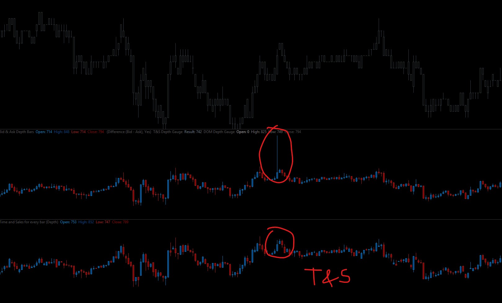

User132748 - Posts: 159
Unfortunately spikes are back @1968. Offers spike in perfect 20min brackets as in screenshot.
Spikes are not visible at T&S depth and also not in previous builds (including 1967)
Of course it's better to see those spikes than no bars at all, but we would be grateful if that issue was finally resolved. Thank you!
Date Time Of Last Edit: 2019-08-05 13:19:00
imagespikes1.jpg / V - Attached On 2019-08-05 13:11:13 UTC - Size: 204.74 KB - 721 views

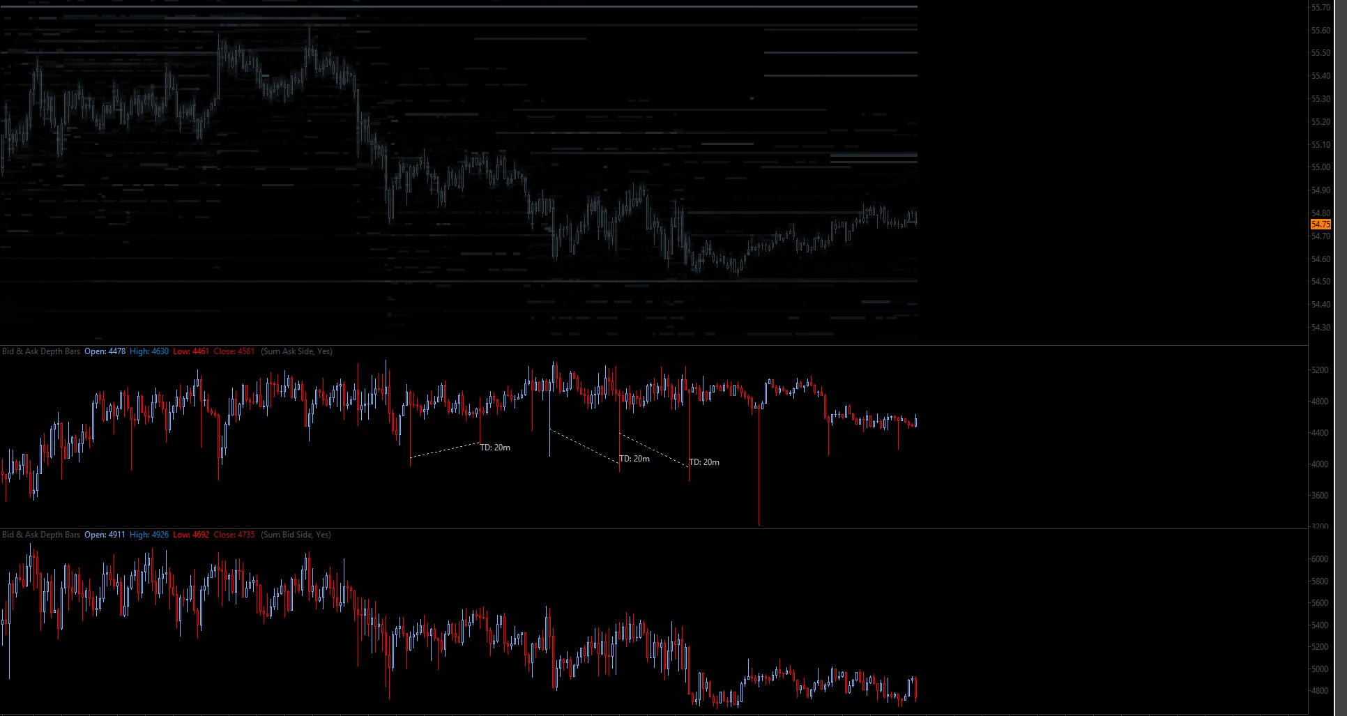

[2019-08-05 19:37:42]
Same regular offer spikes on @1969. Second half of trading day on screenshot.
imagespikes2.jpg / V - Attached On 2019-08-05 19:37:27 UTC - Size: 199.69 KB - 661 views

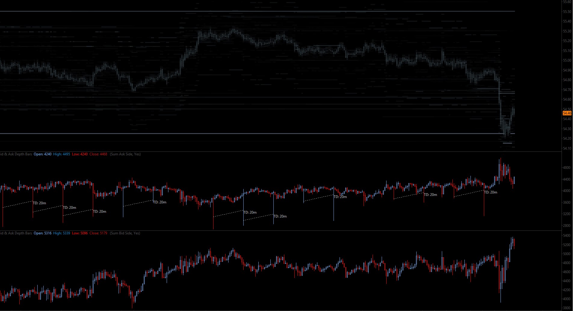

[2019-08-05 20:35:36]
Same thing at my friend's instance. We're both on CQG webapi. @1969
Spikes have excatly same timing but wicks sizes have minor diferences.
Date Time Of Last Edit: 2019-08-05 20:44:45
imagespike3.png / V - Attached On 2019-08-05 20:35:31 UTC - Size: 142.59 KB - 761 views
[2019-08-06 02:16:18]
Post # 28, 29 and, 30 only confirm why the filtering is in there to begin with. We had a good reason to do that.
We are going to run a test with the Sierra Chart Exchange Data Feed and see if we notice this with the current filtering as it is in 1969. If not, it just has to do with how CQG is providing market depth data with their data feed.

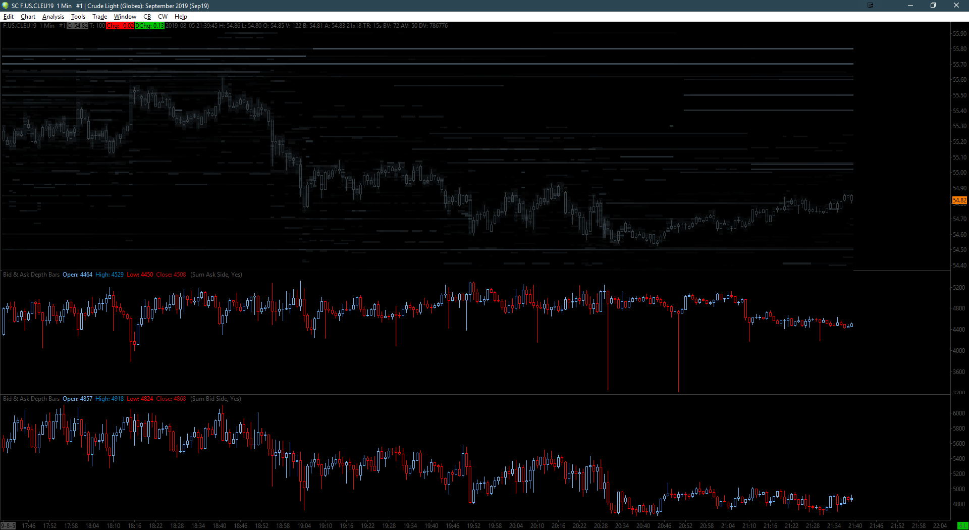

[2019-08-06 07:23:30]
Spikes are present at 1967 too where imbalance filter is at 80% threshold.
Extreme imbalance filtering is what makes this study totally unusable, as we cannot see any bars for hours so it's obviously no way to go. Please find the solution, that allows this study to be used regardless of current bids and offers situation. This study should truely reflect real market image. No data filtering can be justified other than being some work-around of real coding problem.
Those spikes are NOT PRESENT on depth being calculated using Time&Sales data structure (I can send my chart and my code). So it's not a problem of data feed as you obviously will see after your recordings. Also they are NOT PRESENT at 1941 build with your own previous implementation using T&S data.
Your recent implementation of Depthbars study and depth processing in general is great initiative but I hope you understand it's not acceptable to have no depth bars for hours.
And although we value your work regarding your own data feeds and it's possible we would use them at some point, it's hard to accept an explanation that it's some CQG glitch, existing globally in geographical sense and lasting for days without anyone else noticing it despite of the users of Sierra Chart.
If you cannot deal with those spikes please REMOVE THE FILTERING COMPLETELY. It's better to see those spikes than no bars at all :-(
Thank you
Date Time Of Last Edit: 2019-08-06 07:43:23

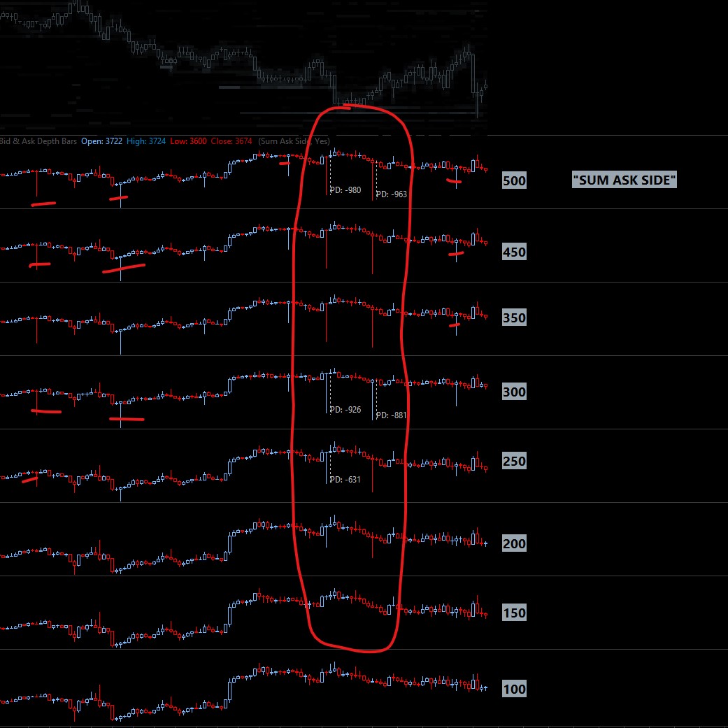

[2019-08-06 08:49:41]

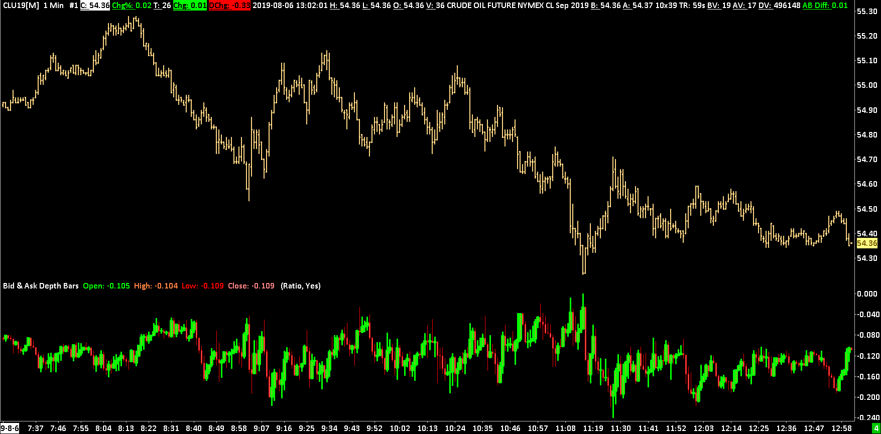

To be clear those "spikes" are in fact massive drops and pick ups of offers, counting 1000 offers on each drop on several levels starting from level 200 to 500.
Screenshots below are studies overlayed from subcharts having decreased number of depth levels in Chart Settings.
These drops are not visible on any other client using CQG data feed.
Date Time Of Last Edit: 2019-08-06 09:17:48
imagespike5.jpg / V - Attached On 2019-08-06 08:46:30 UTC - Size: 181.62 KB - 724 views
imageoffersdrop1.jpg / V - Attached On 2019-08-06 09:10:29 UTC - Size: 153.63 KB - 678 views

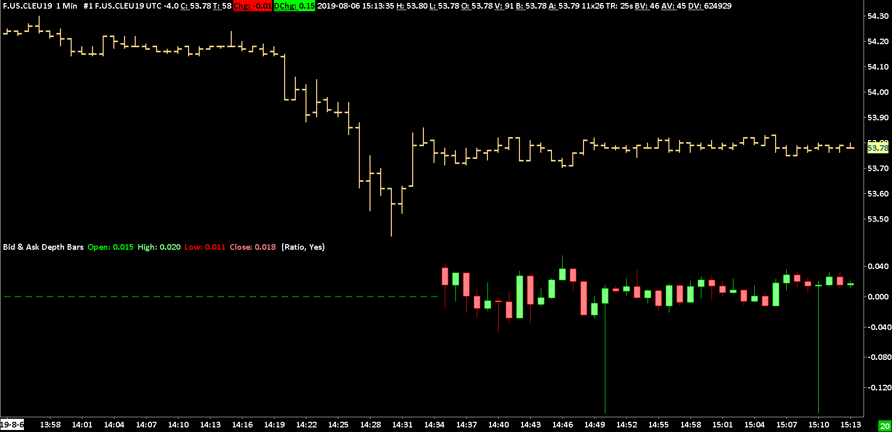

[2019-08-06 18:16:50]
Yes, it would be great if you could point out the problem so it could be sent to CQG to fix the issue. Until then seems the problem is on Sierra side because we all see proper CQG data using other clients.
Also: CQG datafeed based charts look good using SierraChart builds<=1941 and when using T&S based depth on current builds (see screenshot).
So from the point of view of a simple user the issue is somewhere in the new implementation of Depthbars study/new depth processing. With respect to how cool new implementation is in general.
Hope you will find the solution soon. Thank you!
Date Time Of Last Edit: 2019-08-06 18:24:10
imagespike6.jpg / V - Attached On 2019-08-06 18:11:42 UTC - Size: 127.76 KB - 628 views

This is what we see with the Sierra Chart/Denali Exchange Data Feed:
http://www.sierrachart.com/image.php?Image=1565118788689.png
And this is what we see with CQG calculating only 300 levels:
http://www.sierrachart.com/image.php?Image=1565118824236.png
Also the capabilities of the Sierra Chart data feeds are far beyond that of CQG. CQG does not provide historical data for expired futures contracts. That is provided by our own data feeds. We are adding that in. CQG does not provide that. We also provide 300 levels of market depth across all symbols. And we will take that up to 500. This is also high quality low latency data feed and you can control the number of levels of market depth.
For those who require advanced and reliable market depth analysis it is not too much to ask to pay extra for a better data feed and as we continue along our progress of creating unified solutions, we will see about lowering the price. But eventually for those of you who just want CME data when using CQG, there is no reason for us to even be supporting the CQG data feed for CME data and eventually that will just get phased out by us, only our own data feed will be available. But at that time, we will definitely have it more cost competitive. But it also needs to be understood the capabilities of what we offer are far beyond CQG.
Date Time Of Last Edit: 2019-08-06 19:18:00
