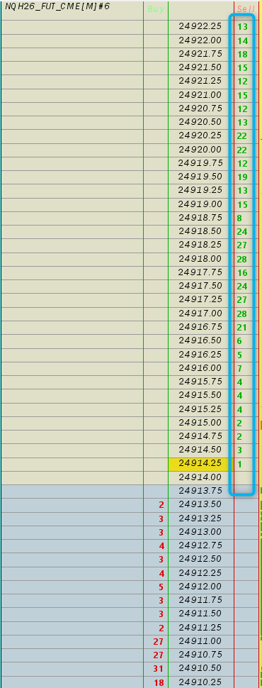

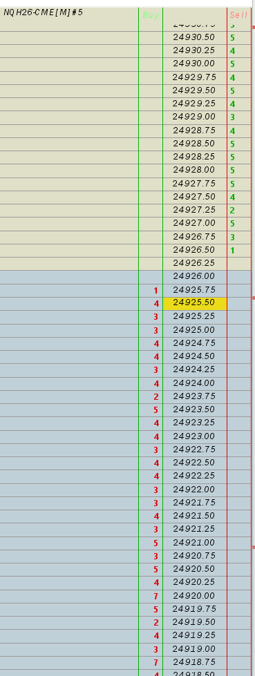

only on NQ in a certain price range , there are orders on dom 4x amount that are actually there only happens from 25000-24800 range once it goes out side that it goes back to normal size on dom , please advise as this is a major issue , here are 2 doms one with sc data alone and other with sc teton , u can see there is 3-4 x ordersize , again this is only on NQ in this price range
image2.png / V - Attached On 2026-02-06 15:06:12 UTC - Size: 28.66 KB - 255 views
image1.png / V - Attached On 2026-02-06 15:06:16 UTC - Size: 32.13 KB - 270 views

zippyzip:
Please post this in a separate thread as it is unrelated to the main topic of this thread.

I believe it is directly related to this topic because many of us experienced this same issue zippy did in the exact price range where the data delays occurred yesterday. The issue persisted the whole day despite the delay resolving. It only went away for me last night once I restarted the platform, but for the entire day the market depth was inaccurate. This issue persisted for many who did not restart overnight into today.
[2026-02-06 15:31:40]
zippyzip - Posts: 310
its 100 % related as the delay is happening during this range of price and we are all in a group but if u want to kick it to a new post then thats fine
