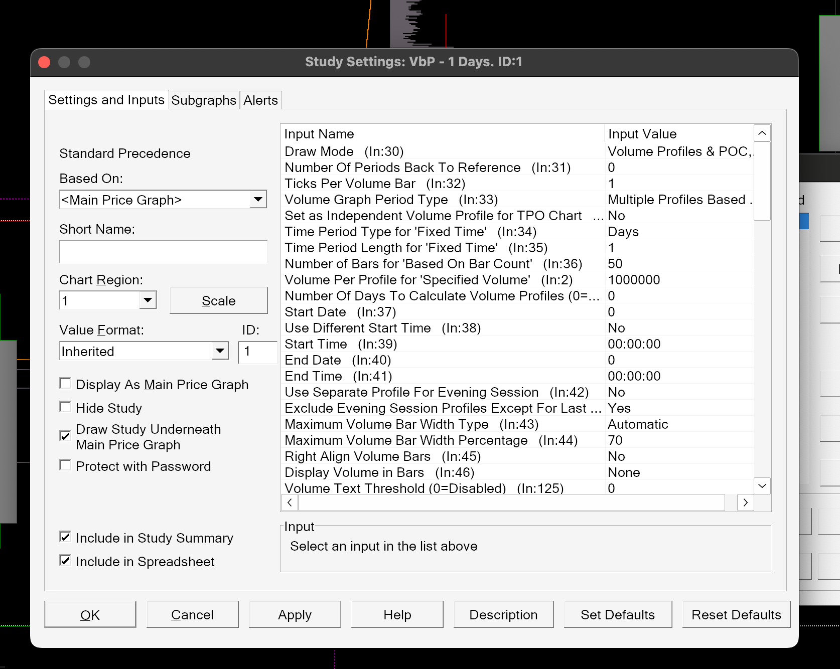

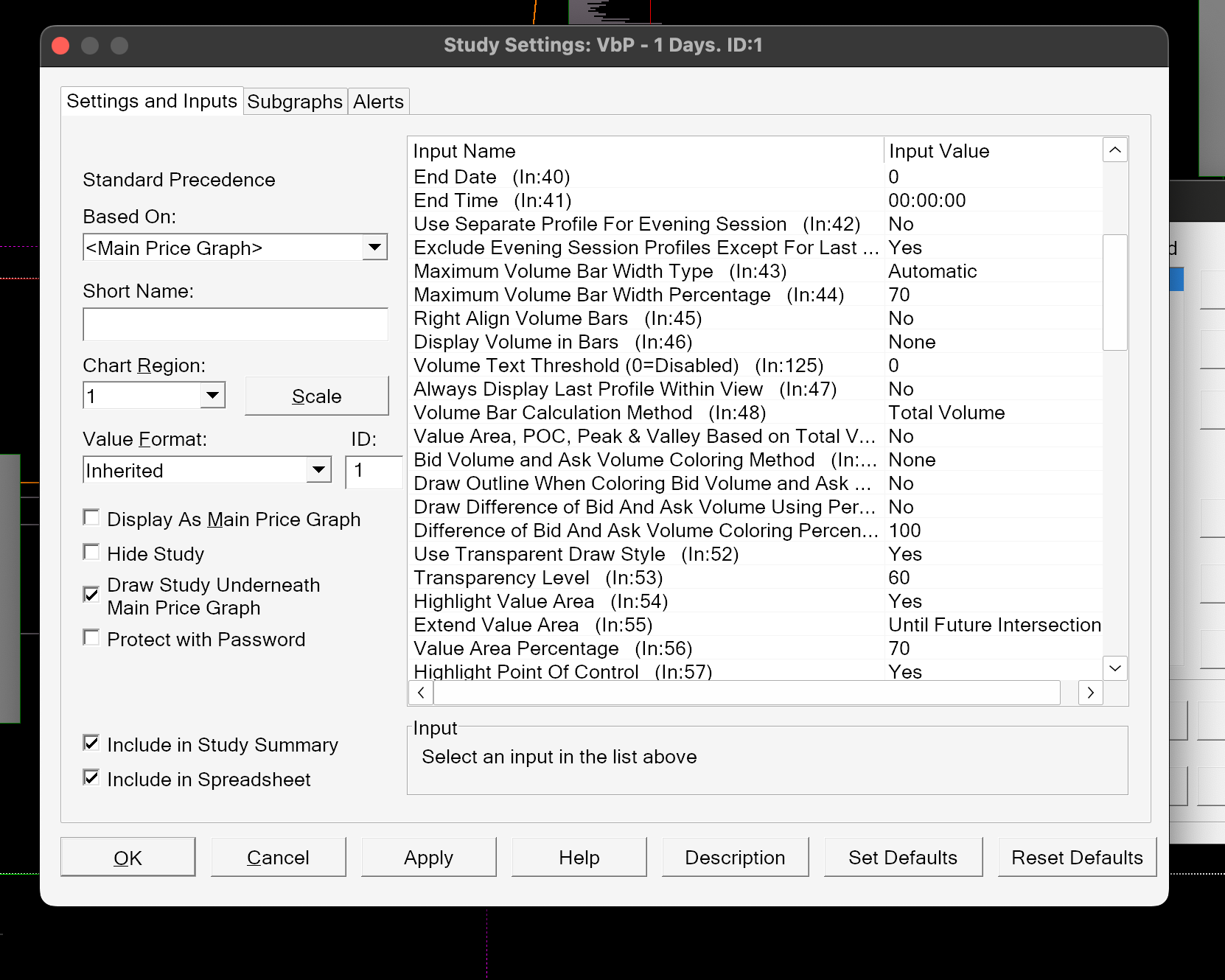

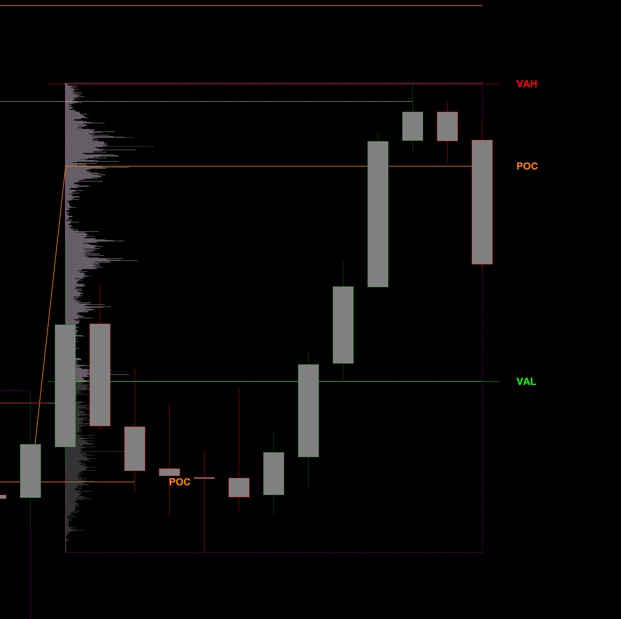

ameetmedi - Posts: 50
Here is an example of QQQ for today. Ticks per volume bar is set to default value of 1. calculation method is total volume. You can see the POC is not really the node where the volume is the most visually so why would this be the POC?

[2025-03-18 14:54:21]
John - SC Support - Posts: 48139
We would need to see an image of the chart with the POC not extended (or not highlighted at all) in order to be able to see the underlying bar.
Also, we do not understand what the 2 POC lines are from. We think the one on the bottom is from a previous profile, but we really can not say for certain.
[2025-03-18 15:04:49]
I removed the POC highlights and it was indeed the correct POC :-) highlighted.
