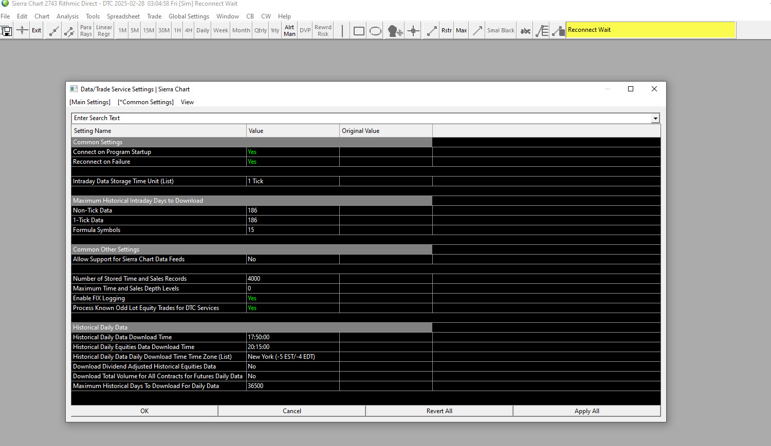

[2025-02-27 20:59:06]
John - SC Support - Posts: 48143
Thank you, now that we understand your setup we can properly answer the questions.
First, of all, we want to point out that you can get the Denali data to both installations without a problem. This should be your default situation, so we would expect you to be getting any data for the CME Group and EUREX to be coming from our Denali feed.
If you want the second installation to get the data for the CME Group from Rithmic, then you need to change the setting for "Global Settings >> Data/Trade Service Settings >> Common Settings >> Allow Support for Sierra Chart data Feeds" to "No". Then select OK to close that window and then select "File >> Reconnect" to disconnect and then connect to the data feed, updating where the data comes from. Refer to the following:
Data/Trade Service Settings: Allow Support for Sierra Chart Data Feeds (Global Settings >> Data/Trade Service Settings >> Common Settings >> Common Other Settings)
Note that we do not support data for EUREX from any source other than our own data. Therefore, if you change the second installation to get data from Rithmic, then you will be able to get data for exchanges other than EUREX.
Let us know if you have further questions on this.
[2025-02-28 09:06:42]
User437588 - Posts: 92
Yes, denalidates work.
I have made the change but there is still no connection. Screenshot attached.
image28-02-_2025_10-05-06.jpg / V - Attached On 2025-02-28 09:06:33 UTC - Size: 256.6 KB - 209 views

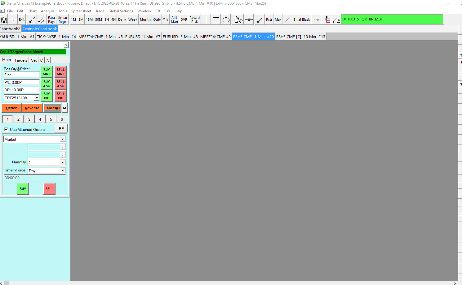

[2025-02-28 09:24:29]
The connection is now working. The trading account is also displayed. Only the data is missing?
What is the problem now?
image28-02-_2025_10-22-22.jpg / V - Attached On 2025-02-28 09:24:25 UTC - Size: 178.3 KB - 211 views
[2025-02-28 15:13:02]
One thing we see is that you have some charts with incorrect symbols for Rithmic. Rithmic cannot handle symbols that they do not recognize, therefore you either need to change the symbols or remove them.
To start, you should have your chartbook open and select "Edit >> Translate Symbols to Current Service". This will update many of the symbols for what is needed for Rithmic (such as MESZ24-CME will change to MESZ4.CME). Note that in this particular case, Rithmic does not have data for old symbols, so you would actually need to remove this chart.
But, there are other symbols such as EURUSD for which Rithmic does not have any data, so you need to remove those charts.
Refer to the following for more information on this situation:
Rithmic Trading Platform Service: Frequent Reconnections
