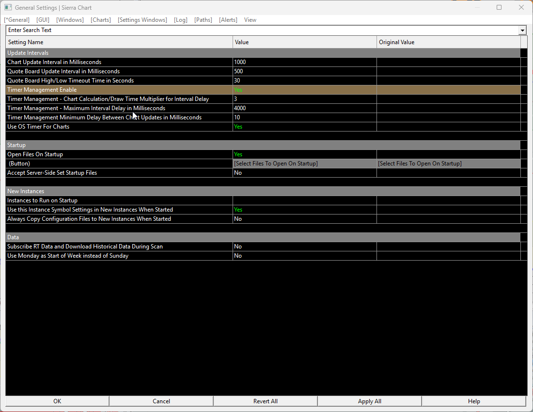

Hello! I’m experiencing an issue with my setup:
I’m using a 5-minute bar chart with the Countdown Timer study enabled. However, when the timer shows around 8 seconds remaining, it suddenly jumps to 5:06, and a new bar begins to draw.
I’m not sure if this is related to the new timer settings you’ve implemented. I’ve included a screenshot of my current Timer Management settings for reference. I’ve tried adjusting them, but the issue persists.
Should add that I am on SC V2726

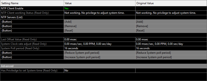

[2025-01-13 08:53:22]
User197029 - Posts: 78
I have tried to use the NTP setting but in: NTP Client working Status (read only) it states: Not working. No privilege to adjust system time.
Tried to find something about this in the documentation but couldn't. Can you have a look at this again please? Thank you.
image13-01-2025--095249.png / V - Attached On 2025-01-13 08:53:10 UTC - Size: 16.84 KB - 293 views
[2025-01-13 17:46:00]
You do not have privileges to modify the clock for your system from the account you are using to run Sierra Chart. Therefore, the NTP options will not work for you.
We would recommend running Sierra Chart "As Administrator" and then using the one-time option to set the clock by selecting "Global Settings >> Set System Date-Time from Server". Refer to the following:
Global Settings Menu: Set System Date-Time from Server (Global Settings menu)
