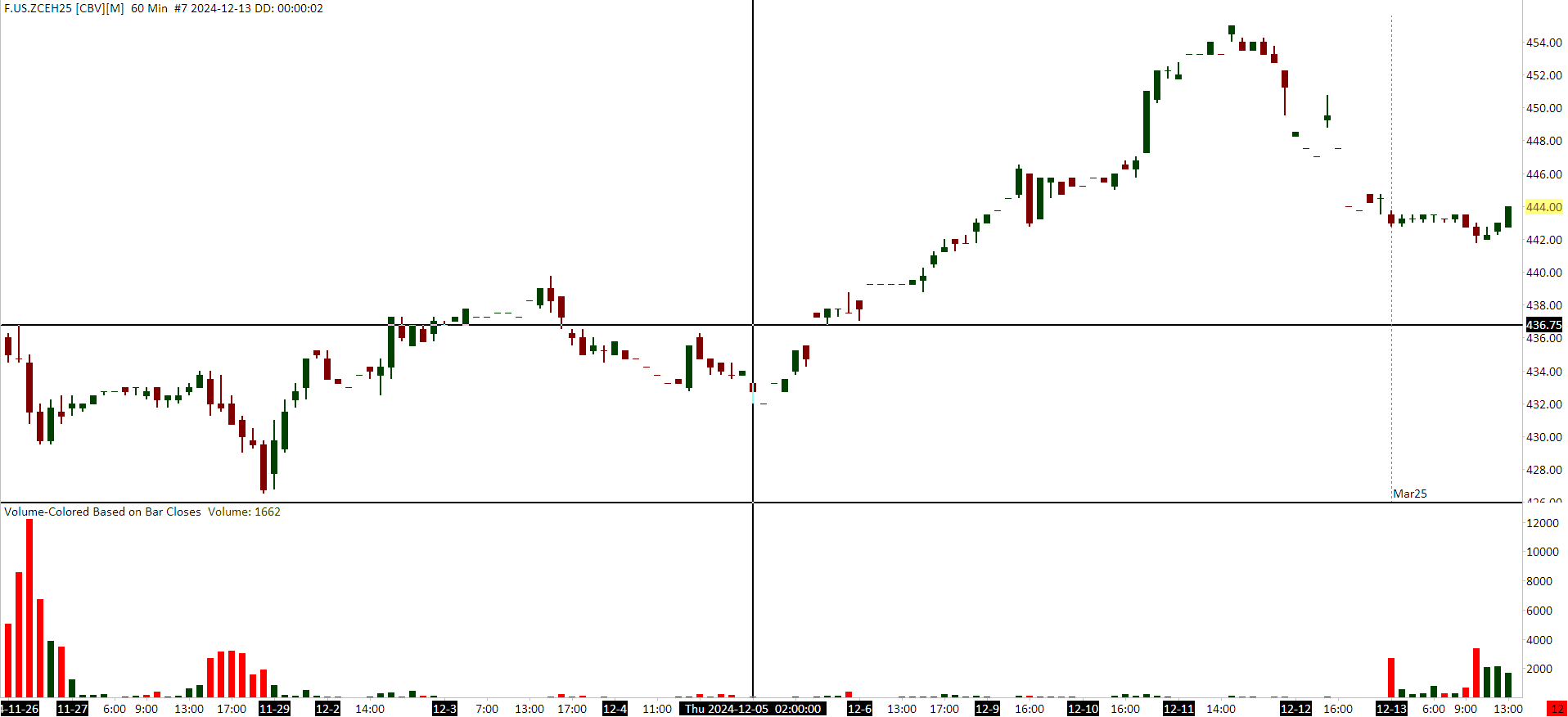

I have problem with setting chart intraday continious chart.
I have gap with volume studdies between 12-2 12-2 2024
imageZrzut ekranu 2024-12-28 111745.png / V - Attached On 2024-12-28 10:21:56 UTC - Size: 22.26 KB - 226 views
[2024-12-30 14:37:34]
We do not see anything particularly wrong with the image you provided. Please give us more information on exactly what you believe is incorrect.
[2024-12-30 14:43:40]
User914828 - Posts: 36
volume bettwen 2-dec 12-dec is marginal, it's no normal for futures continious contract

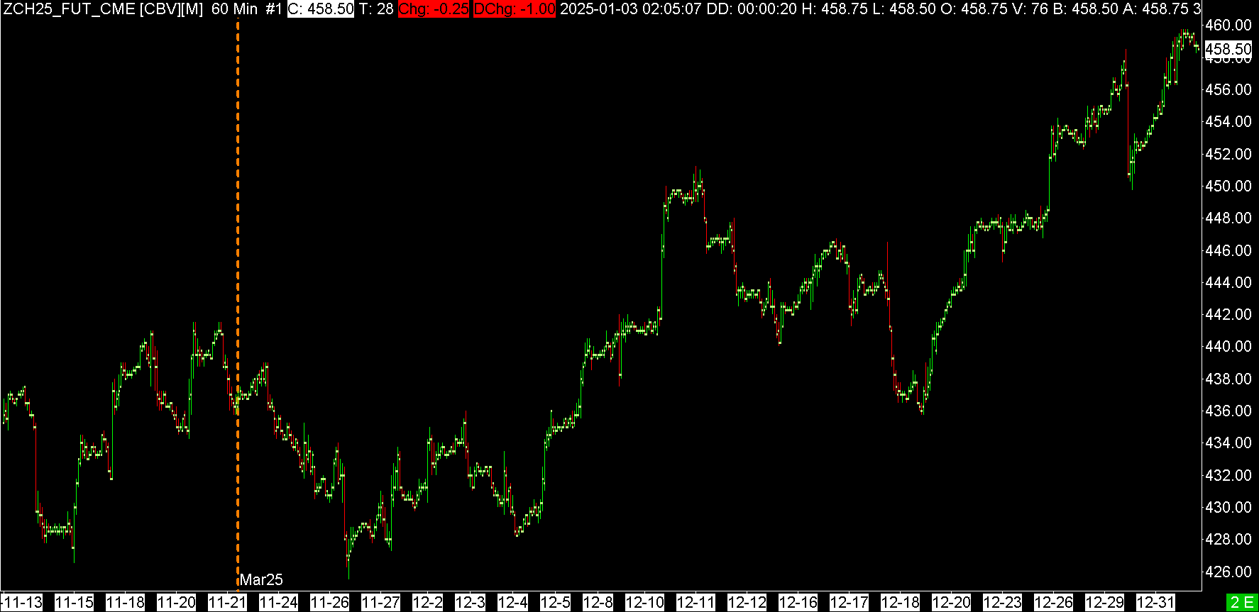

[2024-12-30 16:29:16]
Attached is a chart of the same instrument with what we see of the data. We are not sure why you are not seeing the same information, therefore we want you to redownload the data by following these instructions:
Be sure to redownload at least the most recent 2 contracts.
imageZCH25 [CBV][M] 60 Min #5 2024-12-30 10_27_07.981.png / V - Attached On 2024-12-30 16:29:11 UTC - Size: 52.53 KB - 274 views

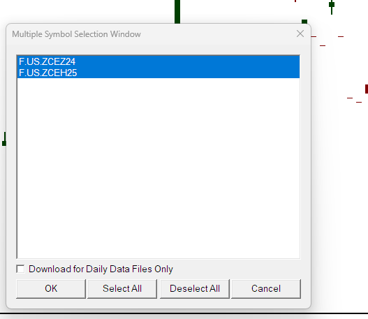

ok, but in window multiple selection, I have only 2 series contract. Maybe it is problem ?
Because after delete and download data, chart don't change.
imageZrzut ekranu 2024-12-30 173811.png / V - Attached On 2024-12-30 16:39:48 UTC - Size: 13.21 KB - 227 views
[2024-12-30 16:55:38]
That is fine that you only have those two contracts. Select them both and select the OK button to redownload the data for both of those contracts.

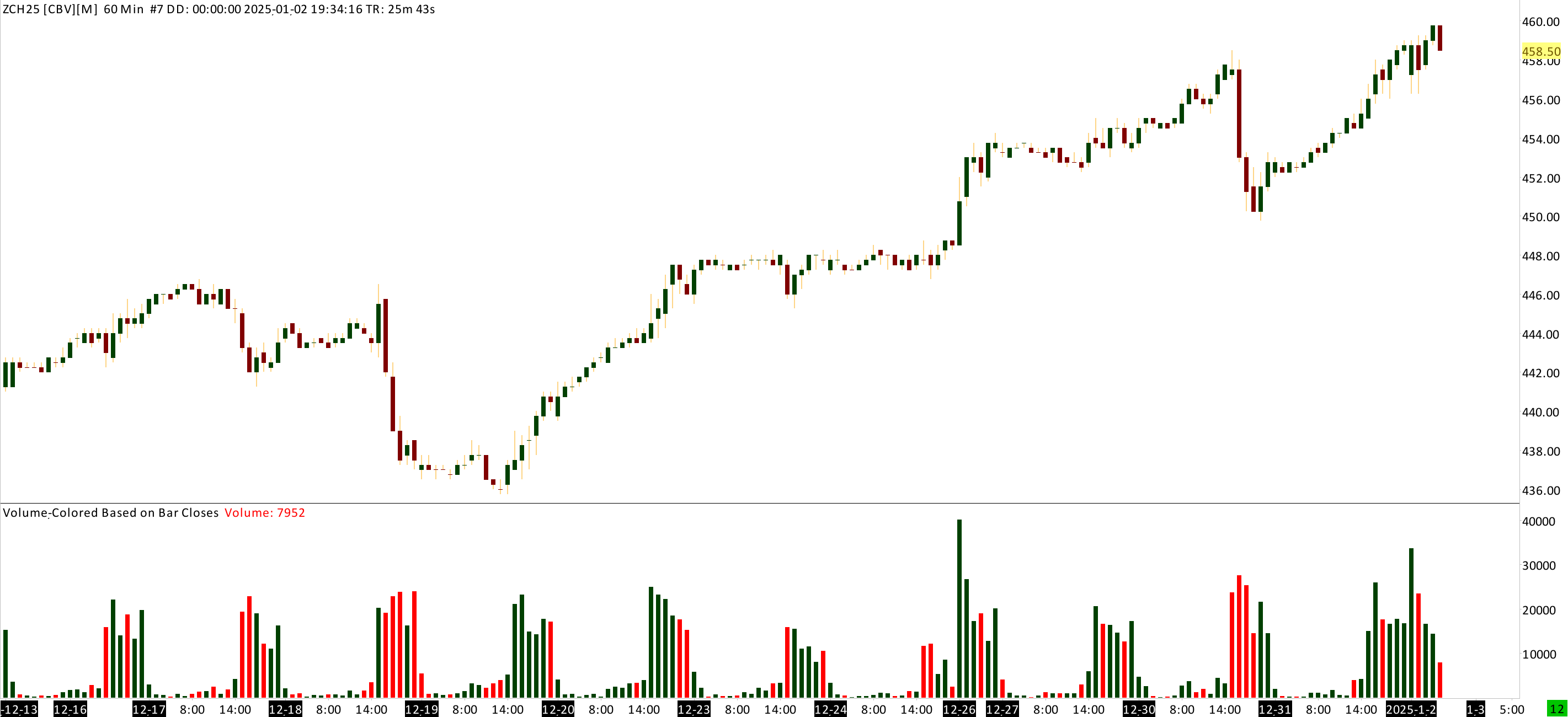

Attached is an image of what we see when we open your chartbook. We are not seeing any issues at all.
If you are still not seeing the data look like this, then we need to see another image of what you are seeing by following these instructions:
imageZCH25 [CBV][M] 60 Min #7 2025-01-02 19_34_17.441.png / V - Attached On 2025-01-02 18:34:37 UTC - Size: 60.22 KB - 189 views
