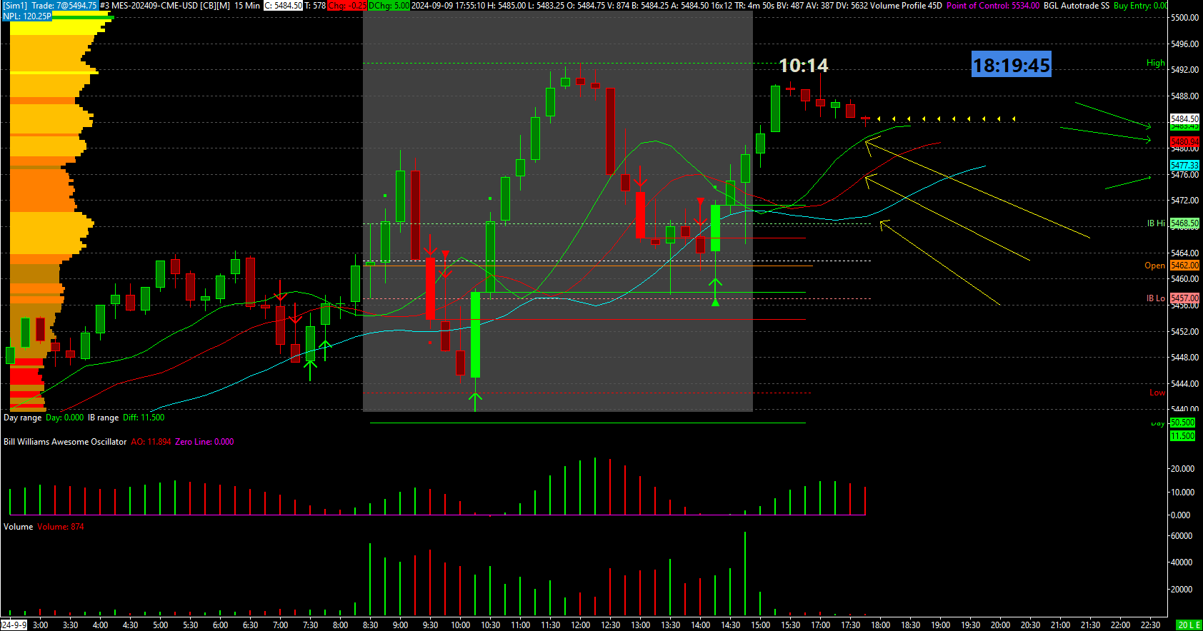

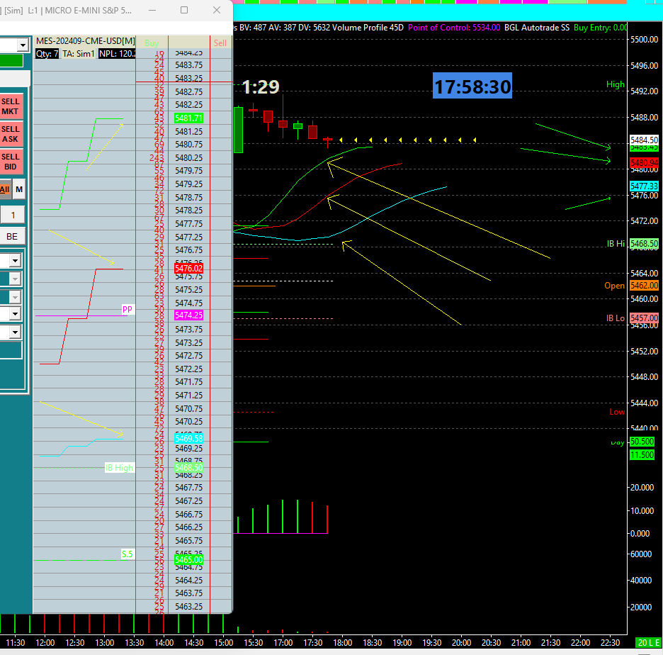

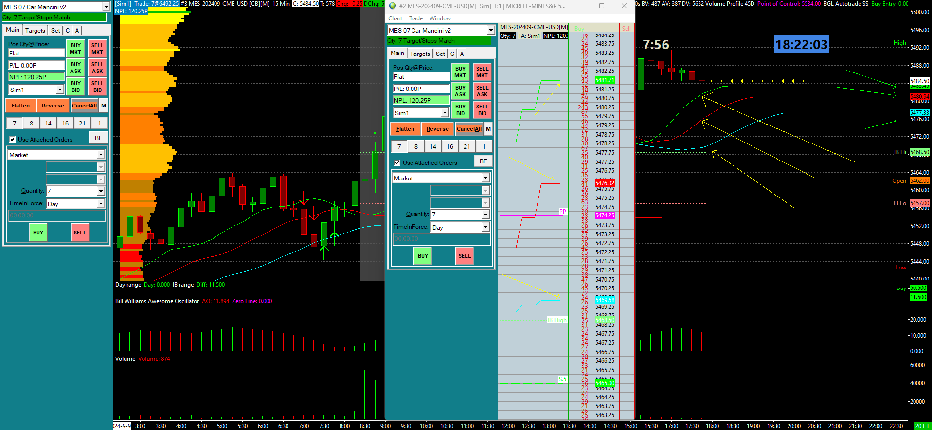

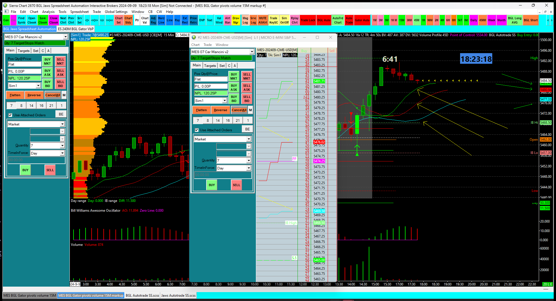

Yes, this is related. Please see the attached screencap.
The Green arrows on the chart point to the end point values of the BWA as shown on the right. Those get displayed on the chart if you want to see the Values.
The Yellow Arrows on the chart point to the BWA spot that is under or over the current candlestick. This is very different from the endpoint values.
You will see on the DOM yellow arrows pointing the values for the BWA and those values are
1) the values that the current bar would cross, not the end point values; bars never cross the end point values as they are shifted.
and
2) these DOM values match the values on the chart for the current candlestick bar as noted with the yellow arrows.
If you are using the BWA values to trigger trades, the yellow arrow values are the ones that would be used, not the green arrow values at the endpoint.
The BWA displays the shifted endpoint values on the chart, and I understand that, but it's the values under the current candle that actually matter.
These are displayed on the DOM correctly. I am trying to see about having those values noted in the chart.
The Color Bar on Alert Condition will probably work but it would be cool if there was an option in the BWA settings to show the DOM values on the chart as those are really the most valuable points.
I hope you understand what I'm describing here.
thanks!
