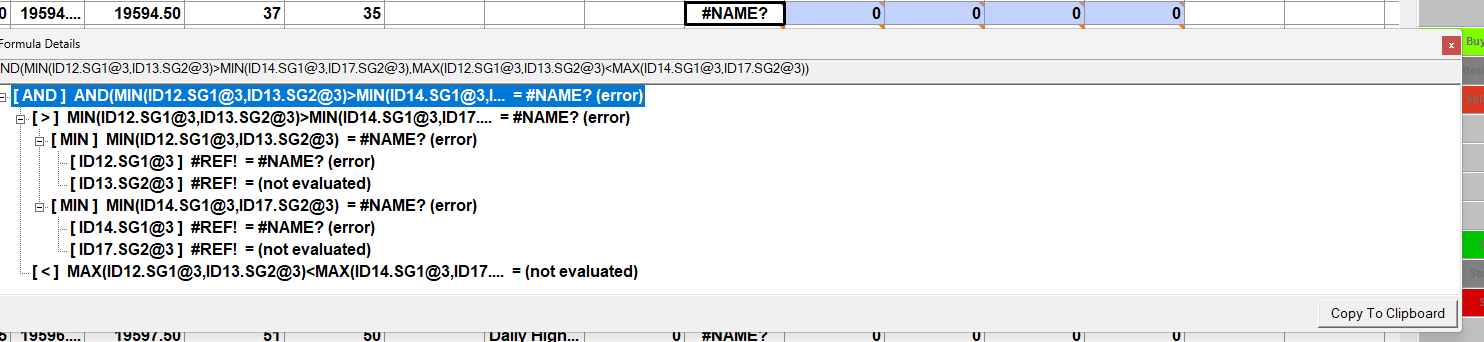

hey all, I'm trying to get this to input but Im a bit lost. It's my first time using code and I've tried looking at it with fresh eyes a few times but no dice.
So a couple questions, I have my SMAs on my "Studies to Graph" as ID:12 ID:13 ID:14 and ID:17 (with colons)
In the second option of the code to go true when the edges of the fast cloud are inside the slow: =AND(MIN(ID1.SG1@3,ID1.SG2@3)>MIN(ID2.SG1@3,ID2.SG2@3),MAX(ID1.SG1@3,ID1.SG2@3)<MAX(ID2.SG1@3,ID2.SG2@3)) It is my understanding is that I should do this:
=AND(MIN(ID12.SG1@3,ID13.SG2@3)>MIN(ID14.SG1@3,ID17.SG2@3),MAX(ID12.SG1@3,ID13.SG2@3)<MAX(ID14.SG1@3,ID17.SG2@3))
Then for Part #2
L3
=IF(K3=1,ID12.SG1@3,0)
M3
=IF(K3=1,ID13.SG1@3,0)
N3
=IF(K3=1,ID14.SG1@3,0)
O3
=IF(K3=1,ID17.SG1@3,0)
when i do this, see attachment for a screenshot of the errors I get.
Thanks all, sorry for being a pest and thanks in advance for the help!
imageScreenshot 2024-08-31 061812.png / V - Attached On 2024-08-31 11:18:31 UTC - Size: 45.63 KB - 247 views
[2024-08-31 14:44:18]
Sawtooth - Posts: 4361
There are no #SYNTAX? errors so your formulas look good, assuming ID12 and ID13 are the fast cloud, and ID14 and ID17 are the slow cloud.
Something else is wrong. See this for possibly why:
Working with Spreadsheets: Spreadsheet Errors

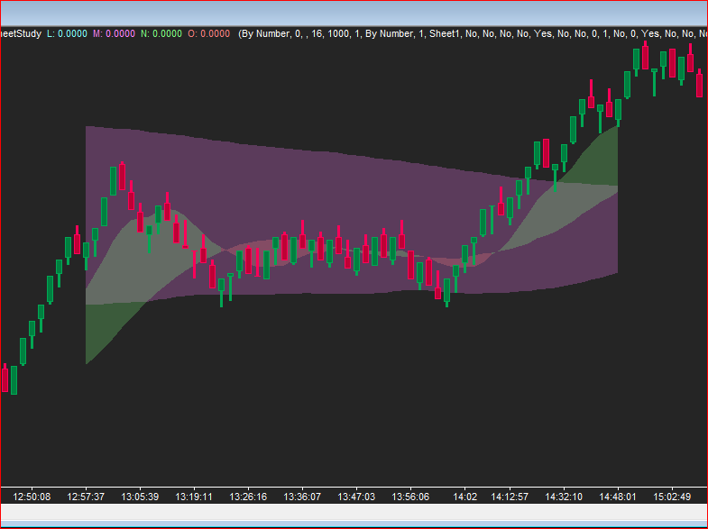

So that the slow cloud is behind the fast cloud, formulas in L3/M3 and N3/O3 need to be swapped:
L3
M3
N3
O3
This works for me. See attached pic.
Date Time Of Last Edit: 2024-08-31 21:38:22
image2 Clouds.PNG / V - Attached On 2024-08-31 21:38:17 UTC - Size: 19.29 KB - 159 views
