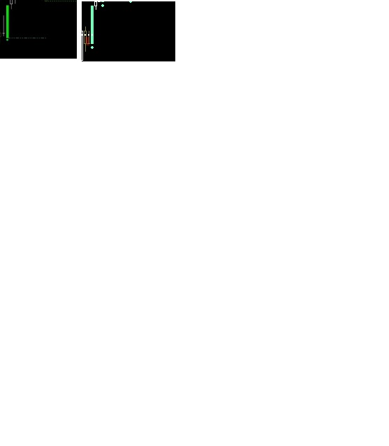

[2024-07-03 00:27:43]
Lilydo - Posts: 18
I used study Color bar based on alert condition to set the color of the candle. Would you pls help to get the line under the candle like attached files. My candles don't have the line under.
Lily
imageCandle without line under.jpg / V - Attached On 2024-07-03 00:26:57 UTC - Size: 9.5 KB - 328 views
[2024-07-03 13:44:02]
The image is too small for us to be able to make anything out from it. Please get us an image by following these instructions:

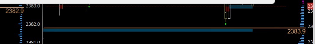

[2024-07-10 03:26:15]
Lilydo - Posts: 18
I have only picture because I cannot set up like this.
Pls open the attached file.
How can set up the line under candle with my conditional alert?
Thank you,
Lily
imageLine under candle.jpg / V - Attached On 2024-07-10 03:25:05 UTC - Size: 85.84 KB - 299 views
[2024-07-10 13:16:03]
It looks like that is an extension line. Refer to the following and the Input below it:
Color Bar Based on Alert Condition: Draw Extension Lines at Color Bar Value

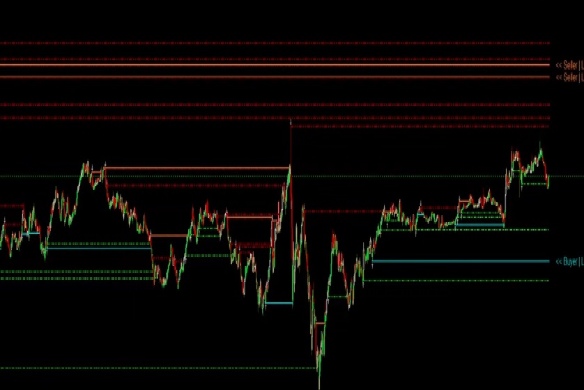

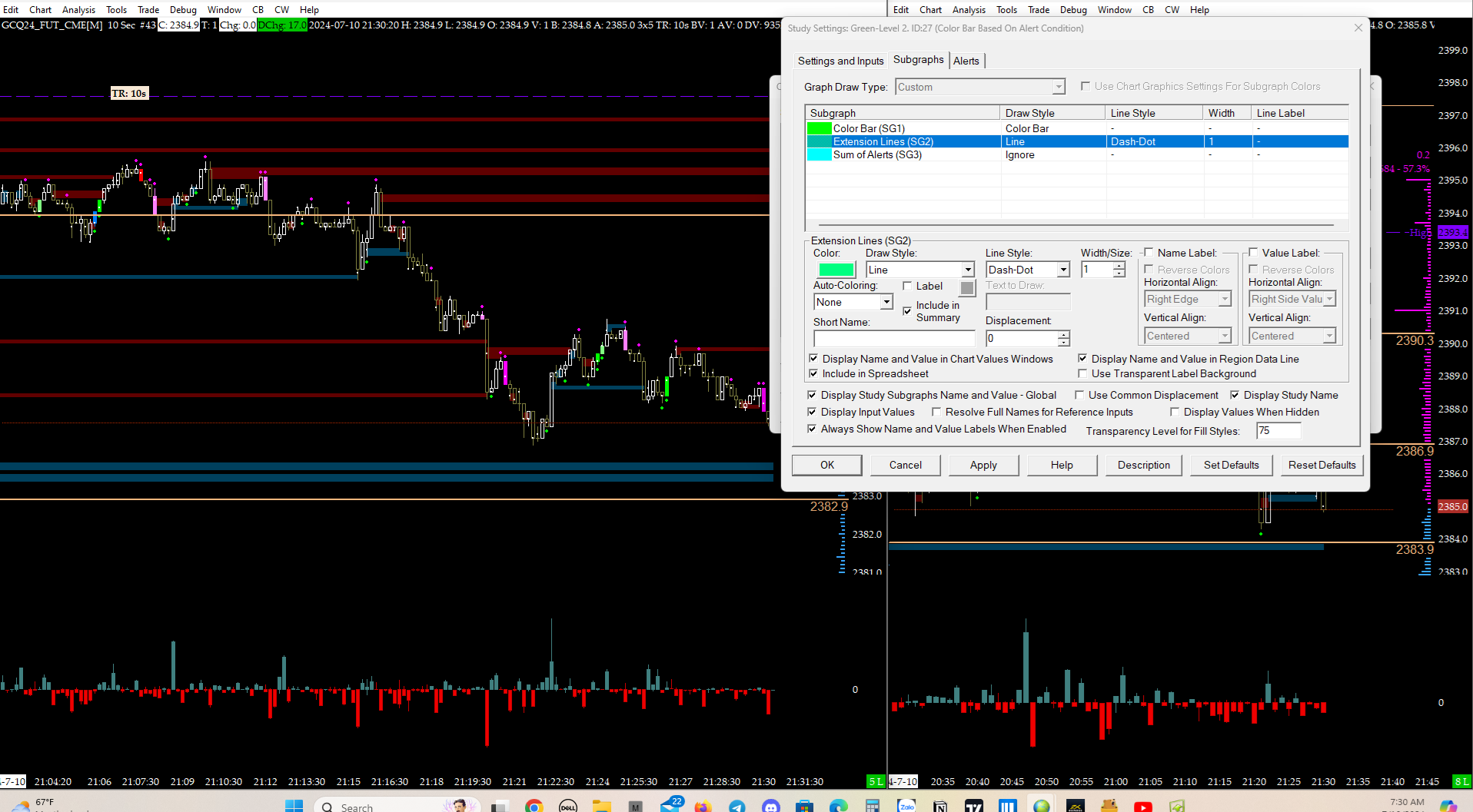

[2024-07-10 14:33:31]

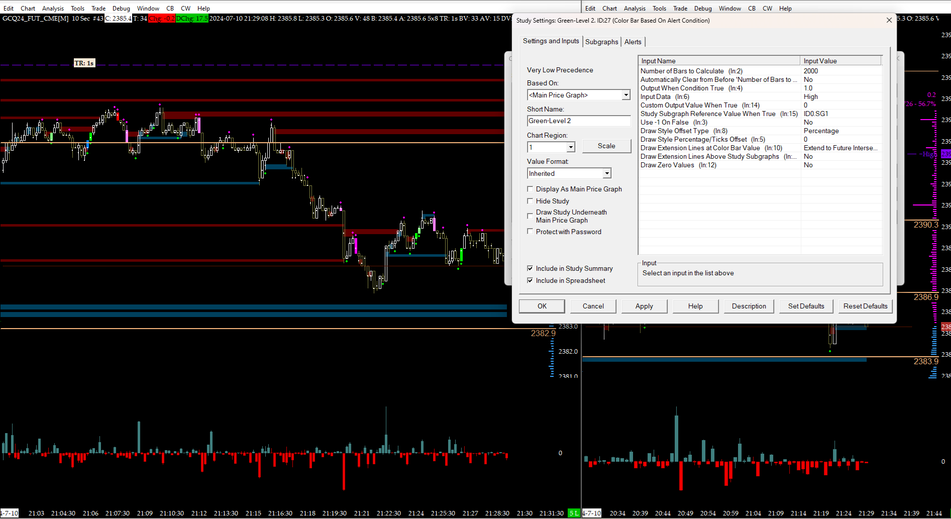

Lilydo - Posts: 18
Thank you for quick response. I tried but it is not working.
Pls give me advise
imageLine under candle 1.jpg / V - Attached On 2024-07-10 14:33:12 UTC - Size: 177.55 KB - 331 views
imageLine under candle 2.jpg / V - Attached On 2024-07-10 14:33:22 UTC - Size: 252.65 KB - 334 views
[2024-07-10 15:28:48]
Your "Output when Condition True" is set to "1.0". So the Extension Lines are being drawn at a value of 1.0. You need to change that to be where you want to see the extension lines. Refer to the following:
Color Bar Based on Alert Condition: Output When Condition Is True

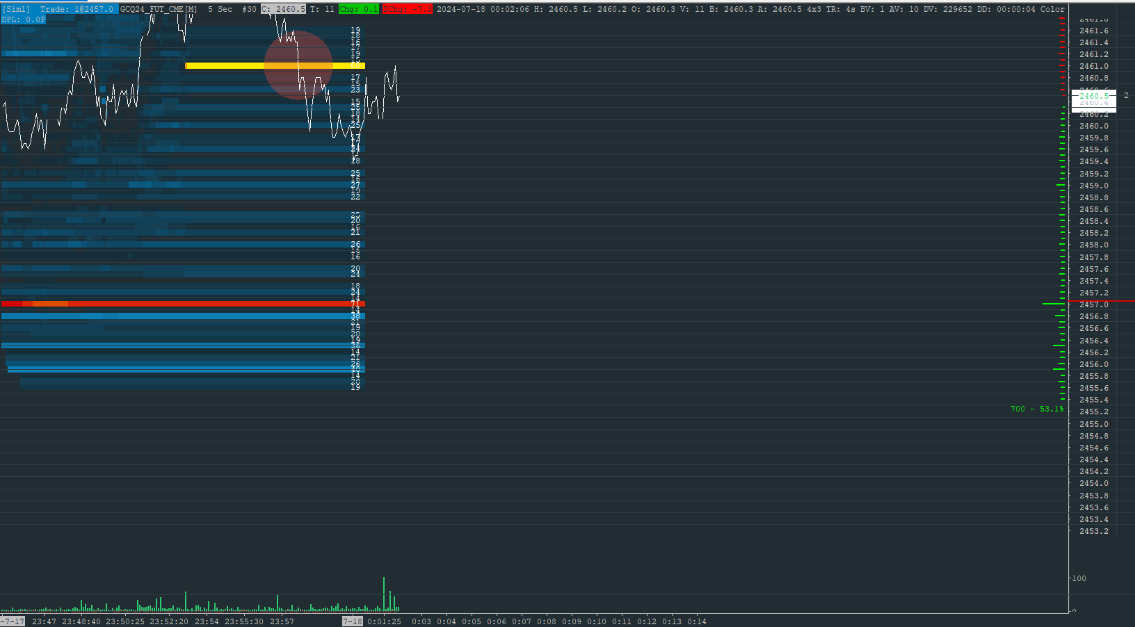

How can I set up Large Volume trade Indicator follow tick?
How can I set 1 line when bubble over 100? ( attached file)
Thank you
imageLarge Volume Trade Indicator.png / V - Attached On 2024-07-10 15:45:06 UTC - Size: 483.68 KB - 335 views
[2024-07-10 16:56:47]
The documentation for the Large Volume Trade Indicator is here:
There is not a way to get an extension line with the "Large Volume Trade Indicator", as this is not built into the study, and the information for the location of the markers is not exposed through the study.

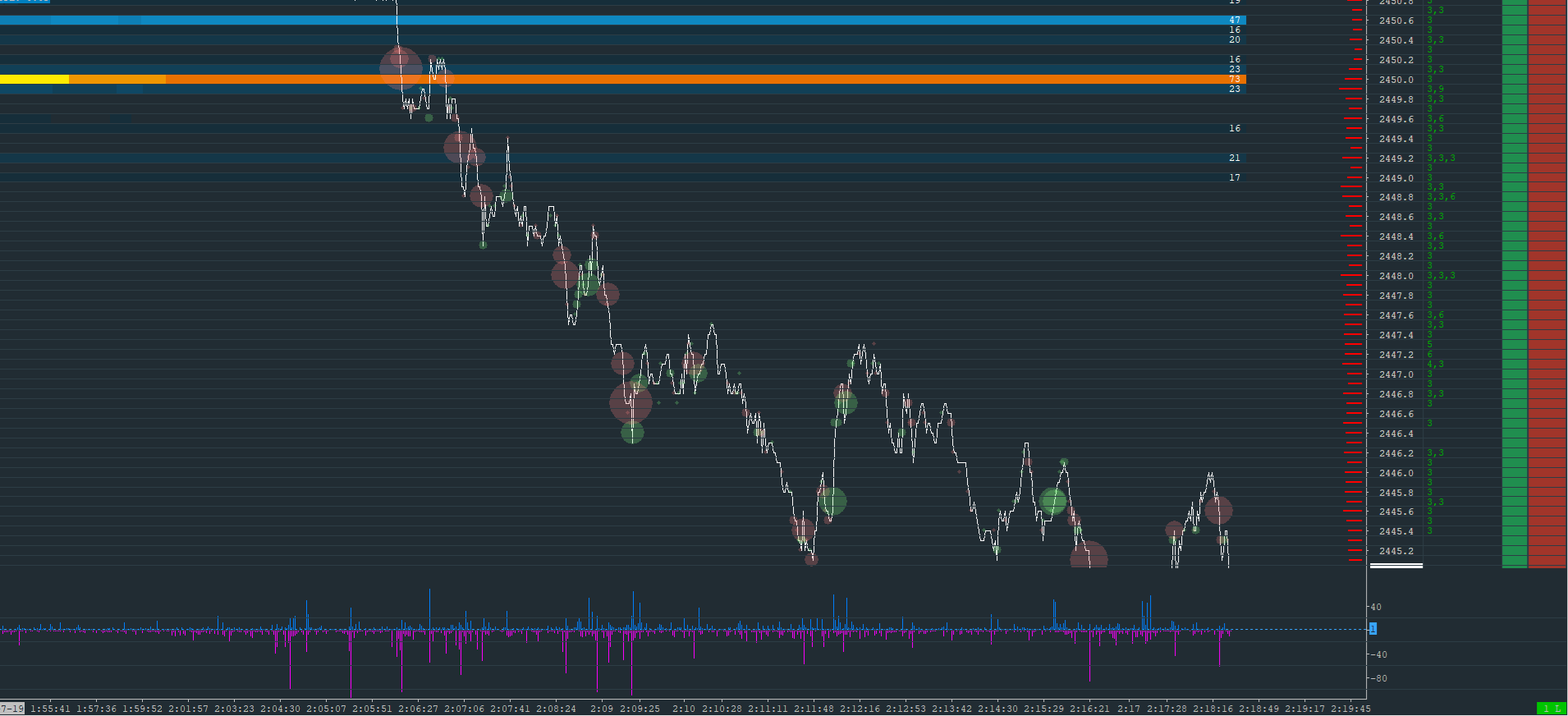

Is there any way to set the bubble like Bookmap on Sierra Chart?
And according to you, how can I set the line when the bubble over 100?
Thank you,
Lily
Use the "Large Volume Trade Indicator" to get the bubbles. Refer to the following:
And as we stated, there is not a way to get extension lines with the Large Volume Trade Indicator

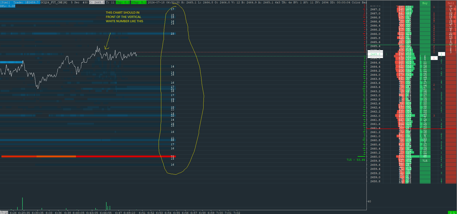

Do you know how to set the line chart always stands in front of the vertical number line. My chart is like the attached file.
Thank you,
Lily
imageHeatmap.png / V - Attached On 2024-07-17 17:07:35 UTC - Size: 79.92 KB - 283 views
[2024-07-17 17:25:21]
We are not understanding.
If you are referring to the Market Depth Historical Graph stopping and not showing on some of the more current bars, then this is due to not having the Market Depth data for those bars. Refer to the following (not Step #8 in particular):
Market Depth Historical Graph: Downloading Of Historical Market Depth Data

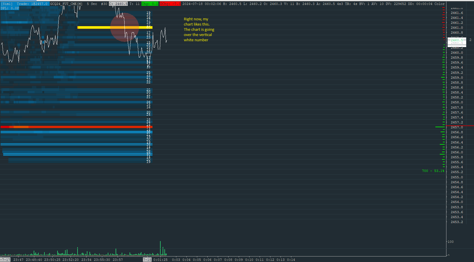

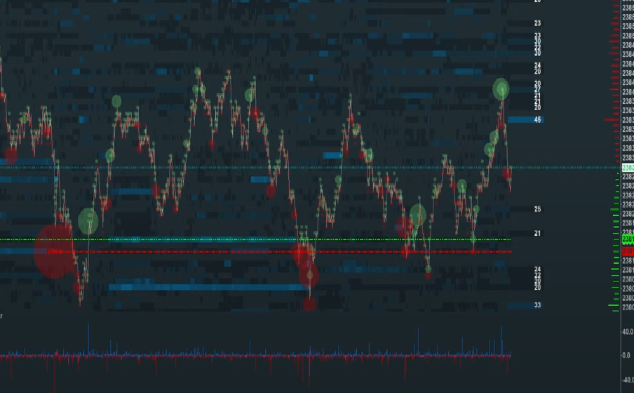

[2024-07-17 23:58:24]
Lilydo - Posts: 18
I'm sorry for not explaining clearly. Would you pls see these attached files and tell me how to set up the chart like this. The line on close chart is always in front of the white number vertical.
Thank you,
Lily
imageHeatmap.png / V - Attached On 2024-07-17 23:56:33 UTC - Size: 95.94 KB - 311 views
imageHeatmap1.png / V - Attached On 2024-07-17 23:56:41 UTC - Size: 157.68 KB - 249 views

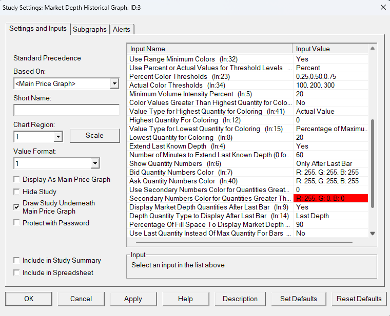

[2024-07-18 16:12:45]
The Market Depth Historical Graph has an Input for "Show Quantity Numbers" in which one of the options is "Only After Last Bar". When choosing this option, there is another Input for "Percentage of Fill Space To Display Market Depth Quantity Rectangles In". You want to set this to a value that will put the numbers where you want them ahead of the bars. Refer to the information at the following link:
https://www.sierrachart.com/index.php?page=doc/StudiesReference.php&ID=375#Market_Depth_Historical_Graph

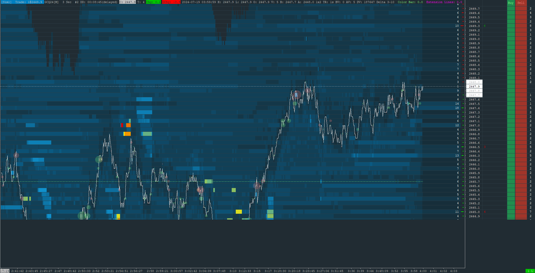

[2024-07-18 19:24:06]
Lilydo - Posts: 18
It is not working. The chart is still like this. The heatmap not following the price chart. I sent the study of heatmap setting. Pls give me your advises.
imageHeatmap2.png / V - Attached On 2024-07-18 19:22:57 UTC - Size: 82.54 KB - 267 views
imageHeatmap3.png / V - Attached On 2024-07-18 19:23:06 UTC - Size: 77.02 KB - 240 views
[2024-07-18 20:15:25]
We do not know. Everything looks good from what we can see.
Please get us that chart by following these instructions:

We can not find a reason why you are seeing the data like this. The attached image shows what we see. We did change the "Lowest Quantity for Coloring" and added a Bid/Ask Market Depth column to view that data relative to the Market Depth Historical Graph. But the data was showing in the correct location even without these changes, there just was not much to see due to some large Market Depth value such that even a 20% of maximum depth for the minimum was removing most of the data.
Please do the following and then get us an image of your chart with this change:
- Set the "Lowest Quantity for Coloring" to "0".
imageGCQ24[M] 3 Sec #2 2024-07-19 04_44_46.966.png / V - Attached On 2024-07-18 21:47:06 UTC - Size: 92.81 KB - 323 views
