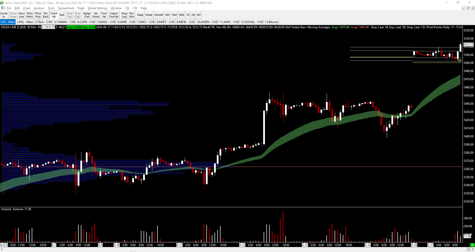

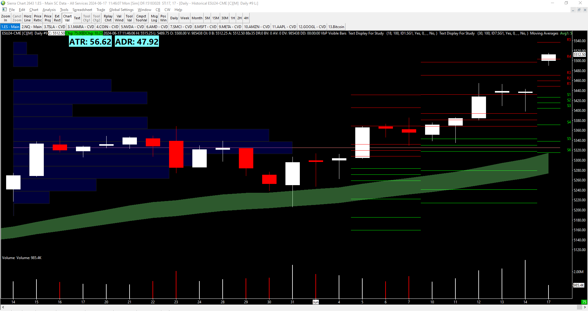

Today I had to rollover data but 1 Hour and Daily Historical chart gapped up after the rollover. Do you know how to fix that?

You are not using a "Back Adjusted" Continuous Futures Contract Chart type. Therefore, what you are seeing is correct. Refer to the following:

The original poster absolutely does NOT have their charts setup as back-adjusted. This can be seen in the image for their chart, as they have the indicator [C], which means the chart is setup as a "Date Based Rollover" with no back-adjustment.
